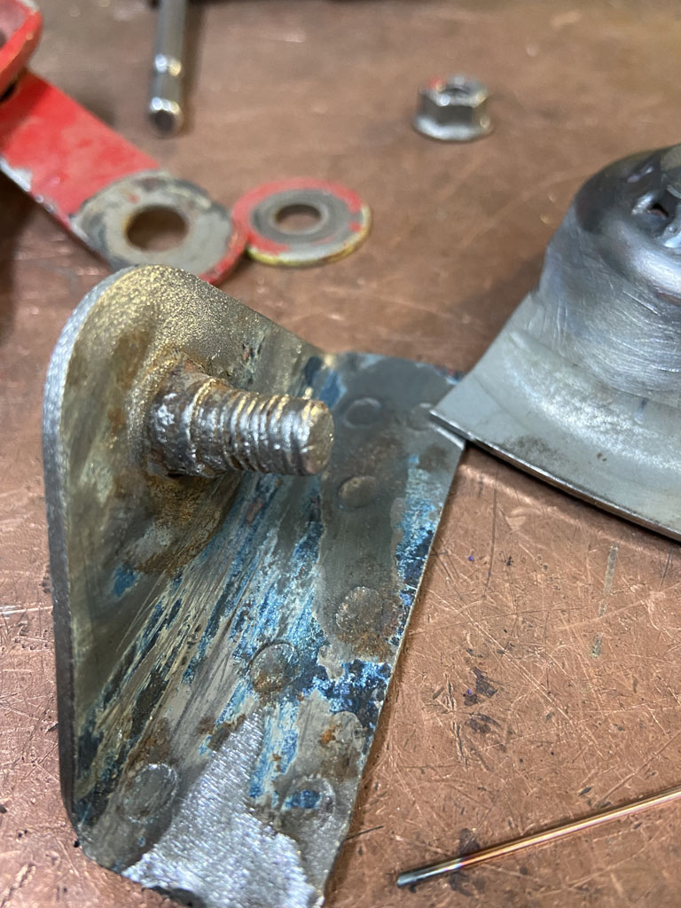

It really is as simple as that flat metal strap that controls the opening height.
I just mounted my truck hinges so I'm very familiar with them. One other thing you might be able to check is the body side attachment that the strap mounts to. Looks like this:
You might see if you can bend the body side bracket slightly. It should be about 90 degrees from vertical but over time it may be getting yanked upwards deforming the body side attachment upward.
From picture, you can see my take off part was tipped up slightly (and stripped to boot!). When I remade the pivot pin for mine, it tweaked the bracket back to 90 degrees, and then did mock-up of everything before I decided on final position to weld the hinges and this travel limiter bracket. You won't have that luxury but you can probably get some minor improvement by tweaking the bracket. Or just fix your strap, or buy a used one if you're shows heavy wear.

Root_Werks   Posting an update to this thread. Pulled the limi...   May 10 2022, 11:58 AM
Root_Werks   If anyone embarks on making the strap travel short...   May 12 2022, 11:30 AM
