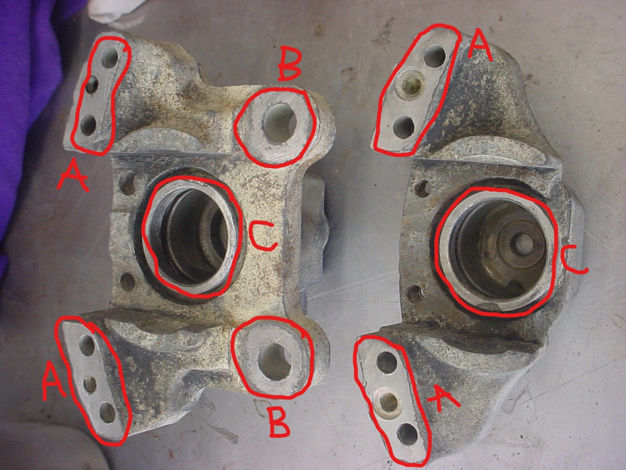

Here's a photo of the cleaned parts. I've labelled the areas I think I need to cover with tape:
A are mating surfaces, so it seems those need to be kept smooth and flat.
B may not be critical, but they are mating surfaces so...Any thoughts and comments?
I'm mostly concerned about the piston bore area (area C). According to the PMB document linked above, this area will be plated, so it needs to be cleaned.
