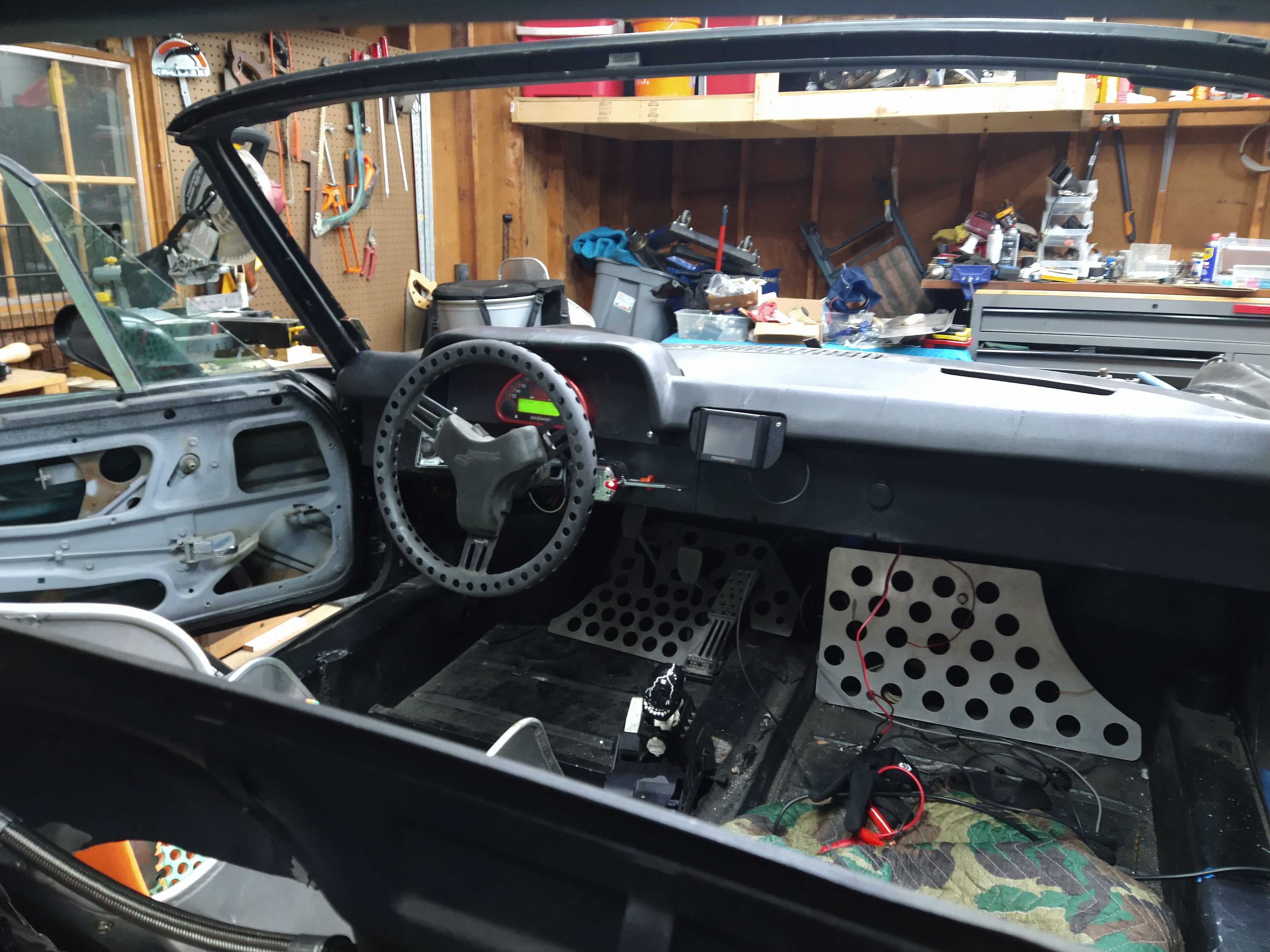

setting up dash.. added in the hand held for the Terminator-x.
The race is on. Retiring in June. It used to be joke on which got here first. Finish the car or retire!!!

d914   setting up dash.. added in the hand held for the T...   Mar 12 2022, 08:09 PM
