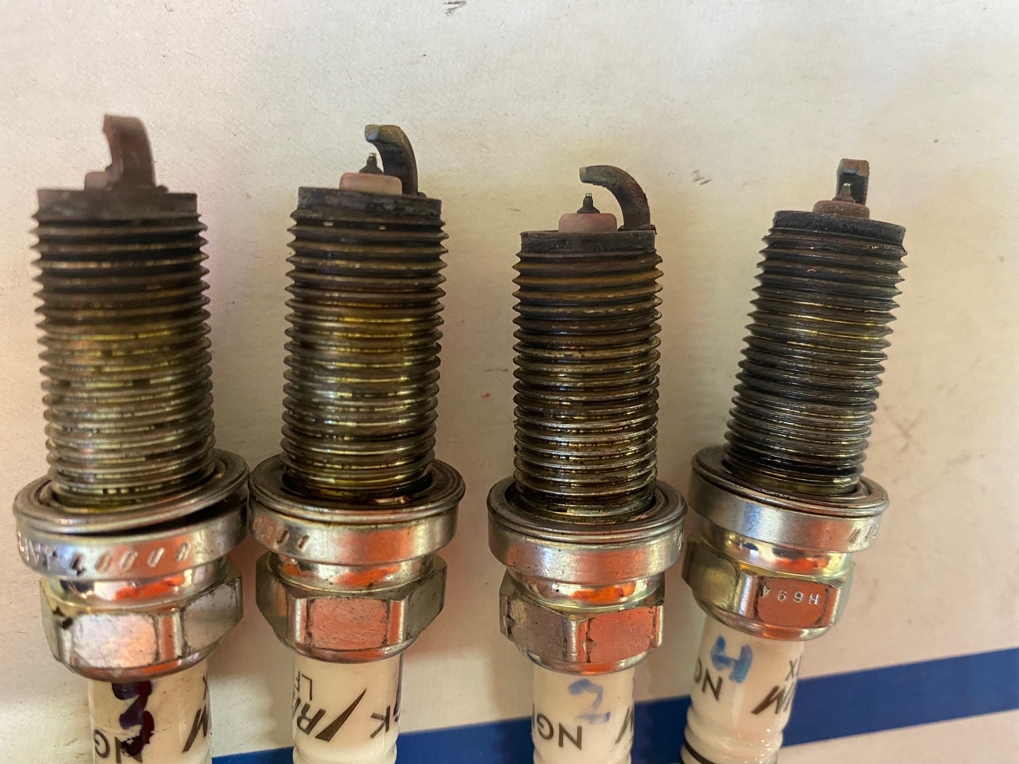

I was pretty certain the issue was with the final drive from the beginning, but wanted to methodically evaluate starting with scoping the intake, exhaust, turbo, cylinders, leak down test, compression test, then move on to transmission assessment.
I spent the entire next day going through the engine.. all looked great.

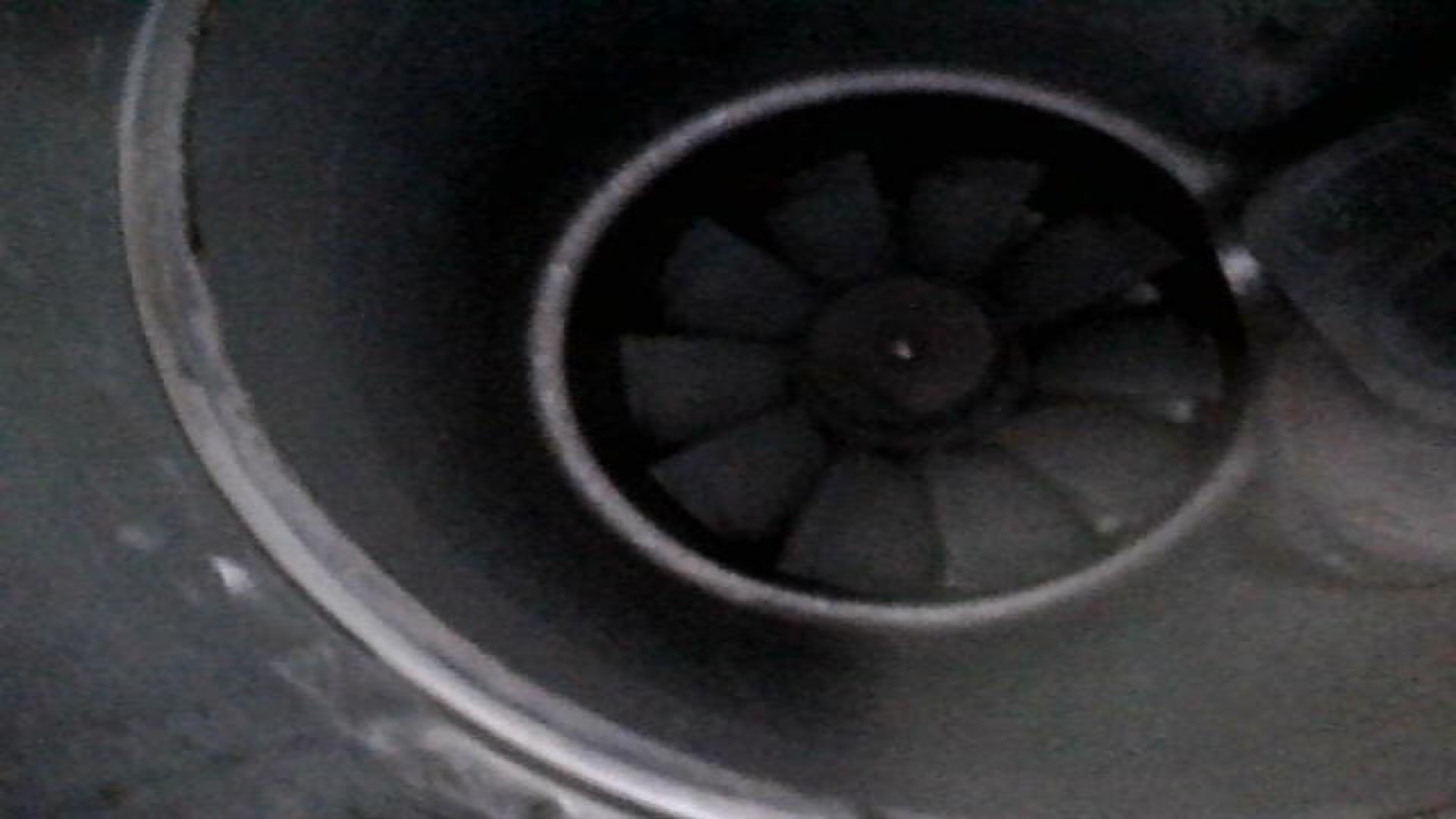

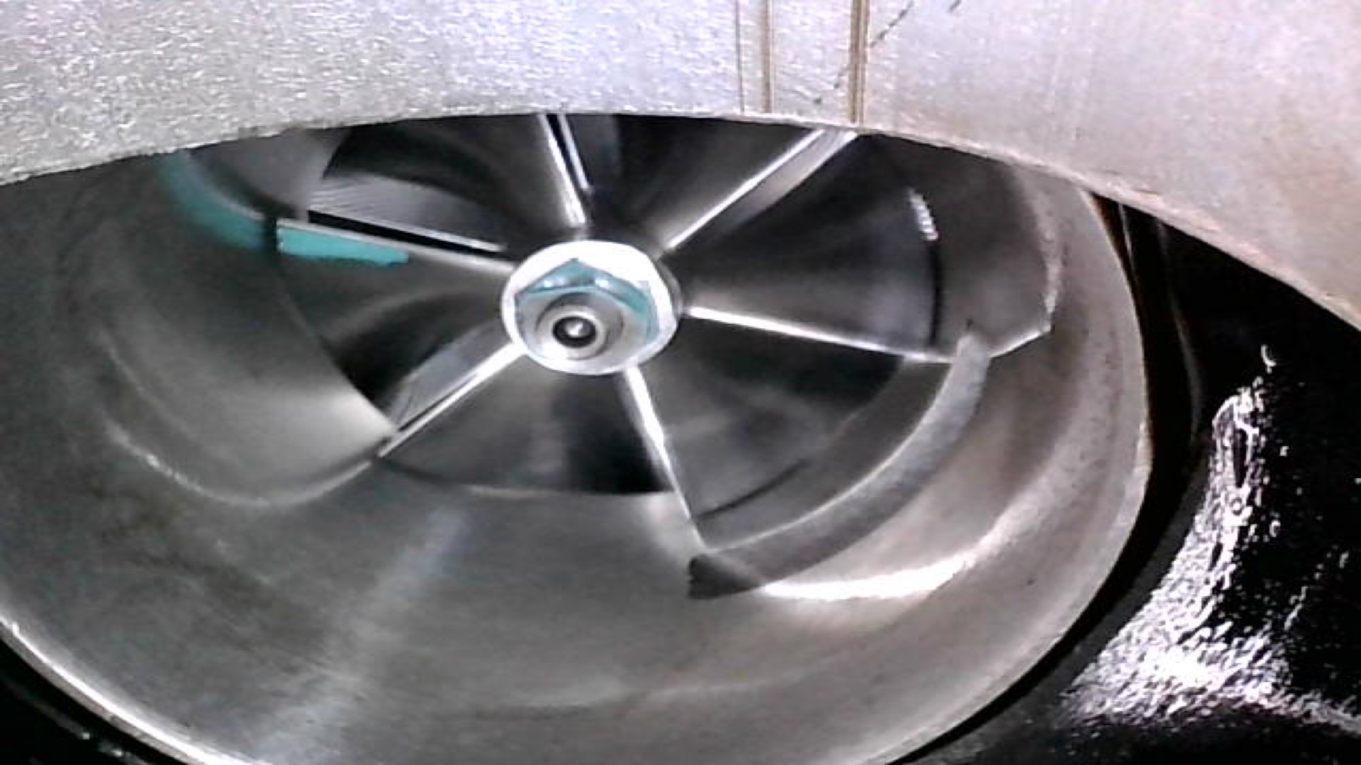

waltonsm   Nearly a year has passed since my last updates. Tu...   Jun 16 2021, 09:33 PM

waltonsm   Will write up the new turbo swap next. ...   Jun 21 2021, 11:10 PM

waltonsm   It is time for an update on what I have been up to...   Mar 24 2022, 01:58 PM
waltonsm   I was pretty certain the issue was with the final ...   Mar 24 2022, 02:24 PM
waltonsm   The good news is that the engine and transmission ...   Mar 24 2022, 02:52 PM
