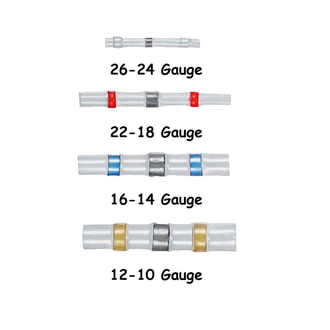

What about those splicers that are a combo of the two?
The low melt solder connectors that look like butt splicers and claim to be also watertight?
(IMG:http://www.914world.com/bbs2/uploads_offsite/cdn.shopify.com-1435-1648662960.1.jpg)
I've never used them before but picked some up and was planning on using them on the Westy that I'm about to replace the entire electrical system.
Snake oil? Overkill?

tygaboy   Those solder sleeves are tricky to get right. Yes,...   Mar 30 2022, 01:27 PM
VaccaRabite   Those solder sleeves are tricky to get right. Yes...   Mar 30 2022, 01:40 PM
