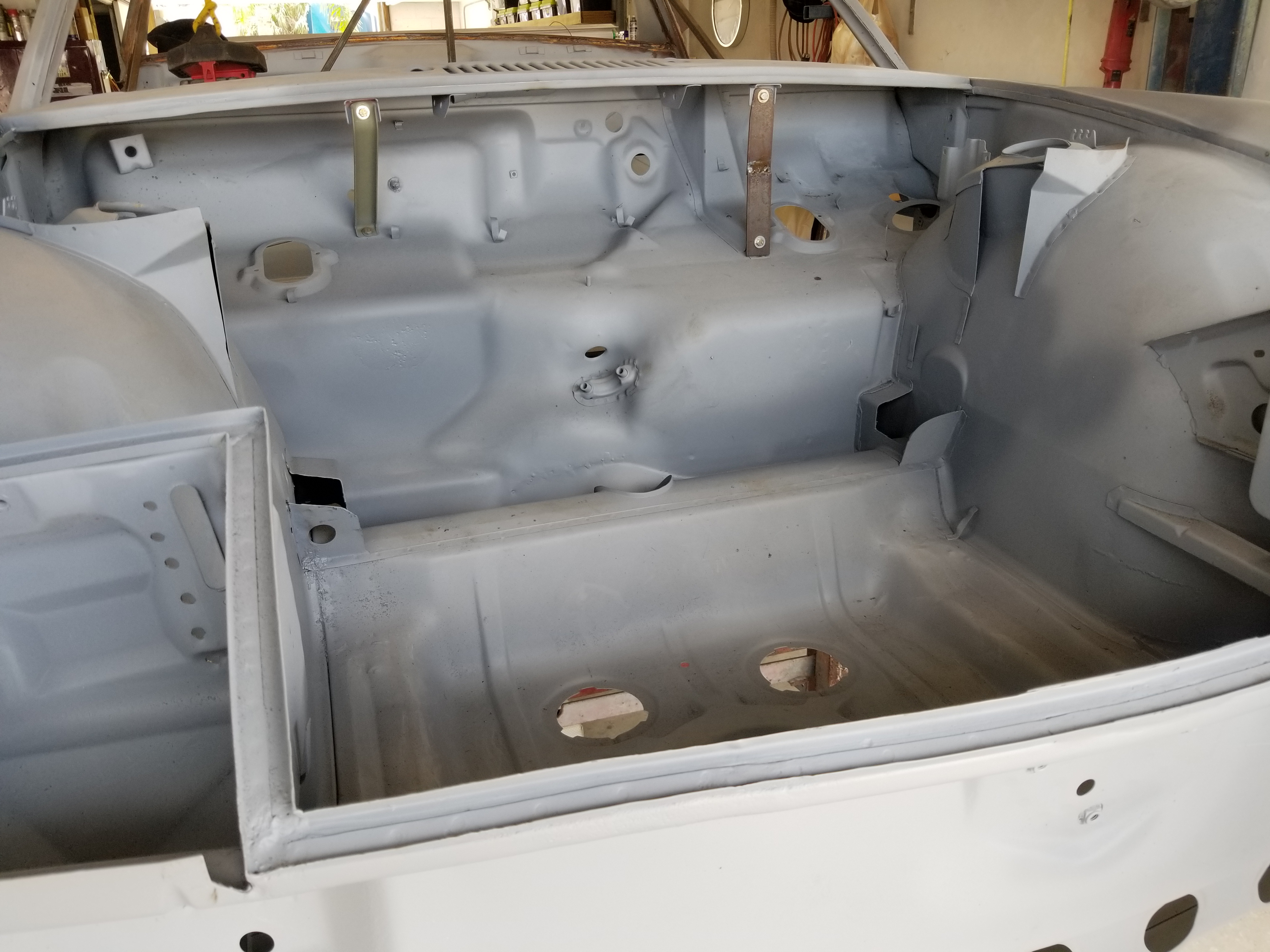

Pans, inner and outer longs, LS targa bar base, vents, pedal box, frunk & trunk floors... a LOT of steel. But that was the worst of it, and by January 2022 it started to look like a car again.

Bullethead   Same with the trunk floor... and it along with the...   Apr 1 2022, 10:58 AM
