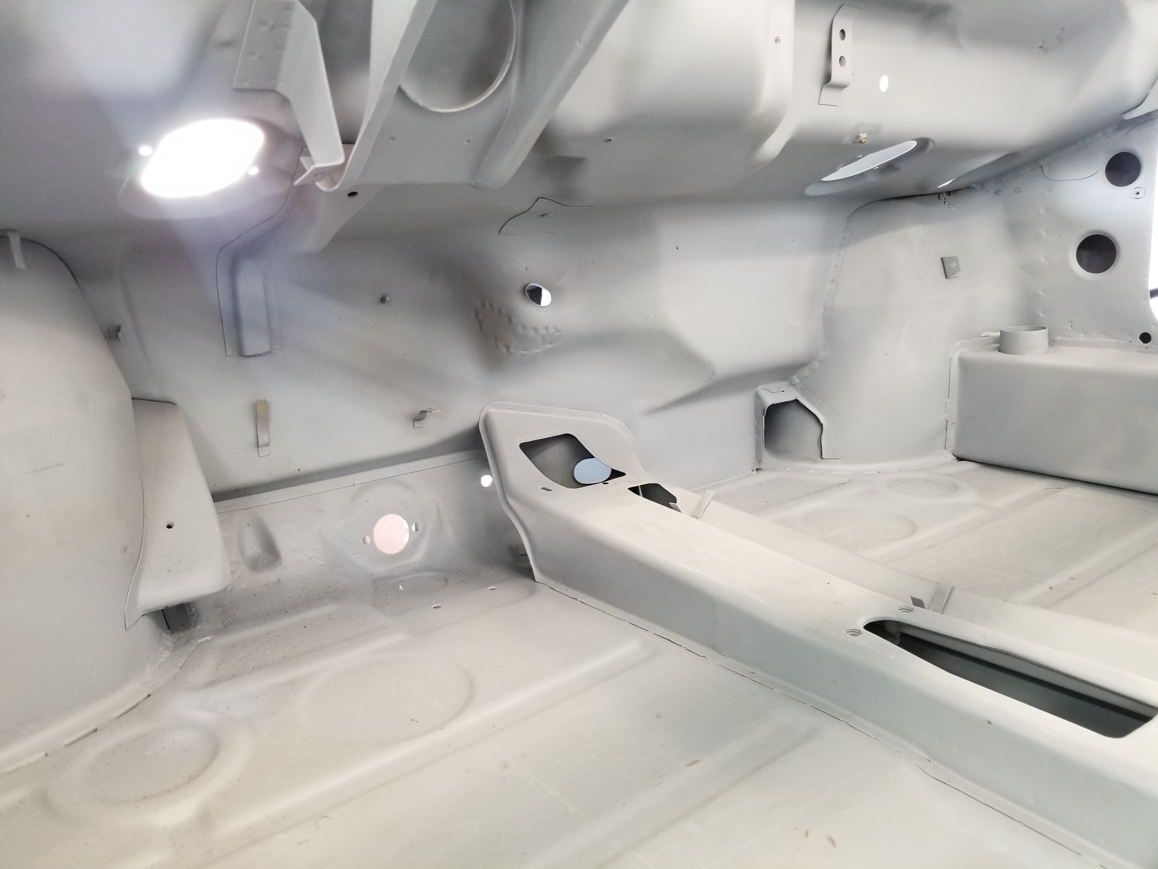

Cockpit floor completed, seat perches for the Scheels and handbrake relocation up soon.
