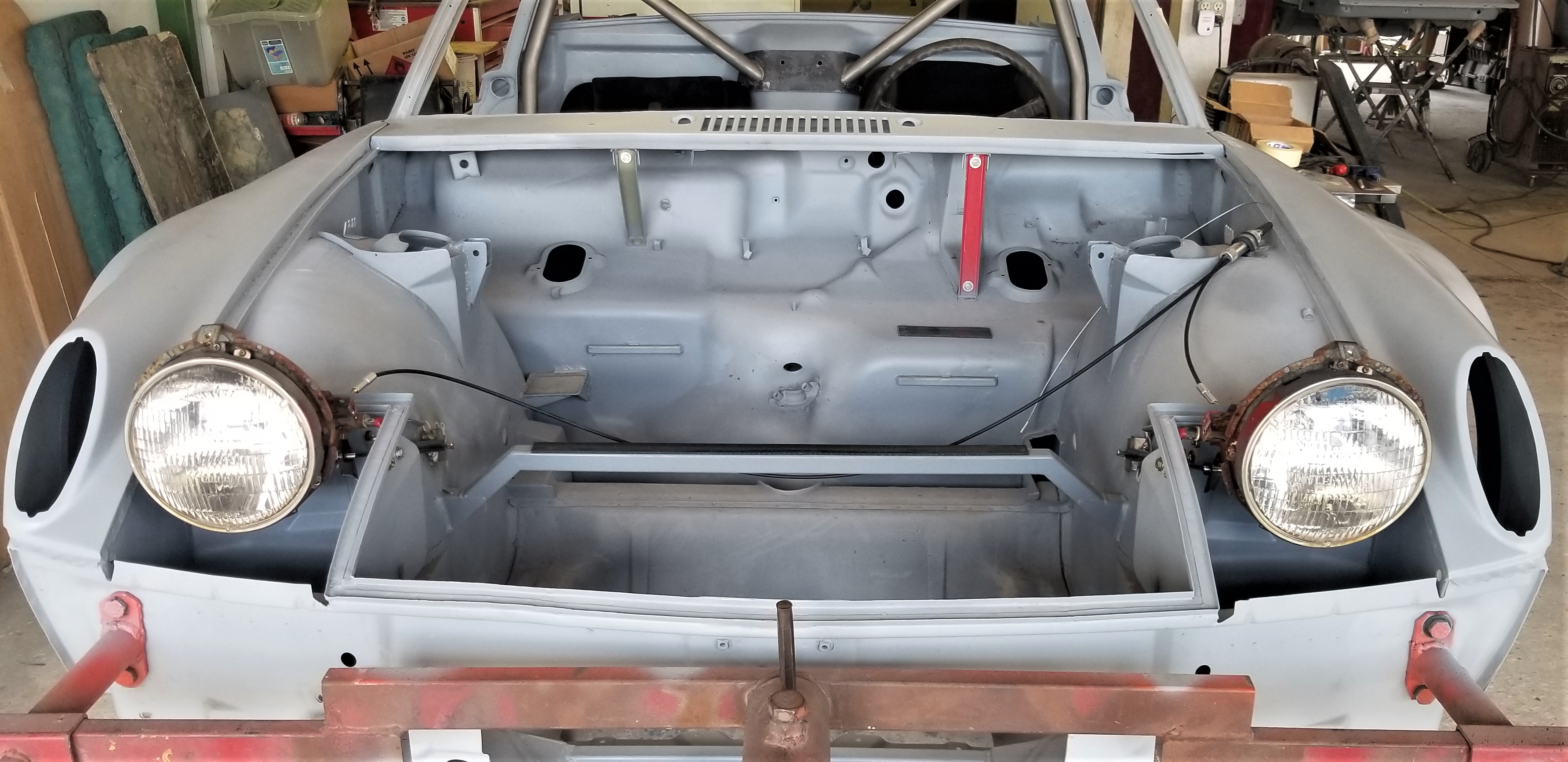

Cheers Mark, but the buttons on the ends of the cables are really small. Have asked the kind folks at 914 Rubber to check with the supplier and hope they can solve it.
The cables are nearly a foot short, kinda hard to imagine that sort of quality control fuck up.
EDIT: Just looked at a half-dozen cable makes and MAYBE Shimano ends will fit. Fingers crossed for a simple solution.

mepstein   On the kit I saw, the cables were bicycle cables a...   Apr 1 2022, 01:10 PM

mepstein   Check the end of a derailleur cable.   Apr 1 2022, 04:48 PM
Bullethead   Check the end of a derailleur cable. :trophy: ...   Apr 1 2022, 05:01 PM

IronHillRestorations   Try Comet Kart Sales for cables   Apr 4 2022, 08:27 PM
Bullethead   Try Comet Kart Sales for cables Thanks but same...   Apr 4 2022, 09:48 PM
mepstein   We used to have to smooth out the ends sometimes i...   Apr 4 2022, 10:13 PM
Bullethead   Thanks to the fine folks at 914 Rubber for contact...   Apr 8 2022, 02:32 PM
