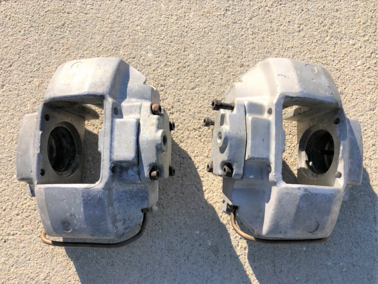

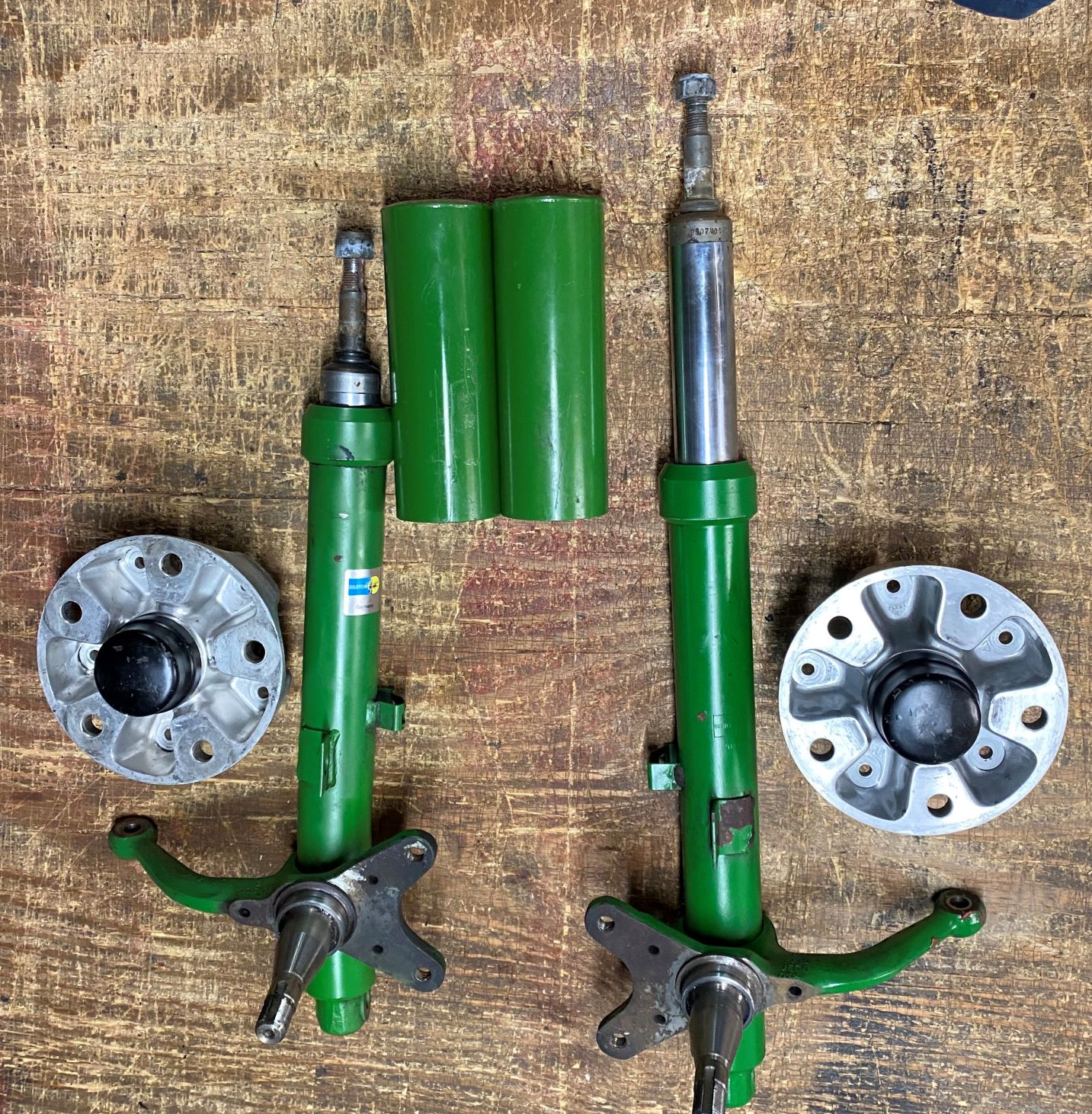

I have been able to source some cool parts for this project.
Early sandcast 250 mm fan/shroud & 2 bolt strap to go with the 3.0L I'll be building
"69-73 911 rear hubs
Pair of Early 911S front calipers
Unused pair of Ben's heat exchangers
Bilstein front struts with early 911 hubs
Attached ImageAttached Image

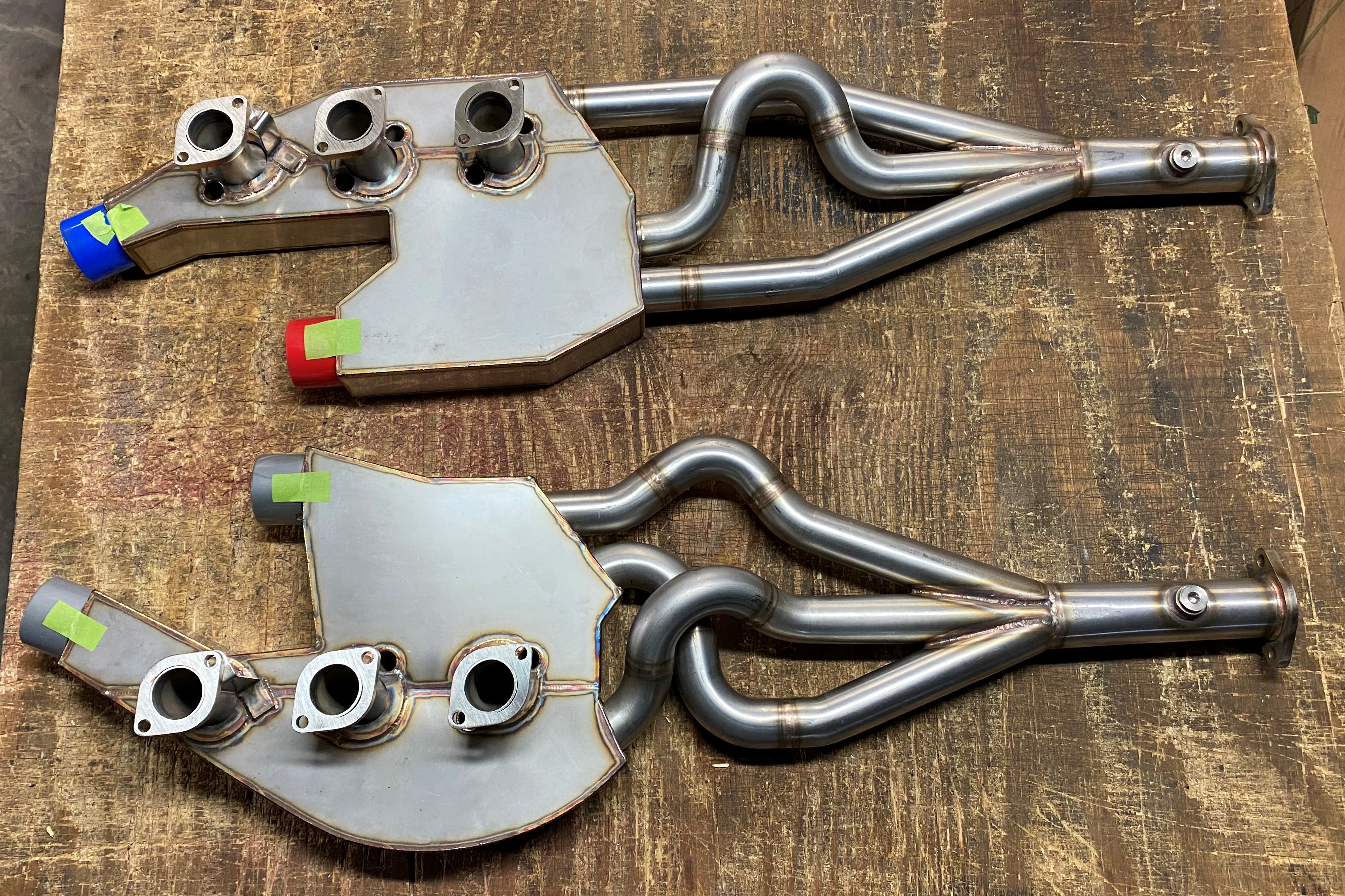

Tom1394racing   Look what showed up today from the UK.   Apr 6 2022, 02:49 PM
ibmiked   For anyone who doesn’t know, Tom is an invaluabl...   Apr 6 2022, 07:58 PM
Tom1394racing   For anyone who doesn’t know, Tom is an invaluab...   Apr 12 2022, 06:58 AM
