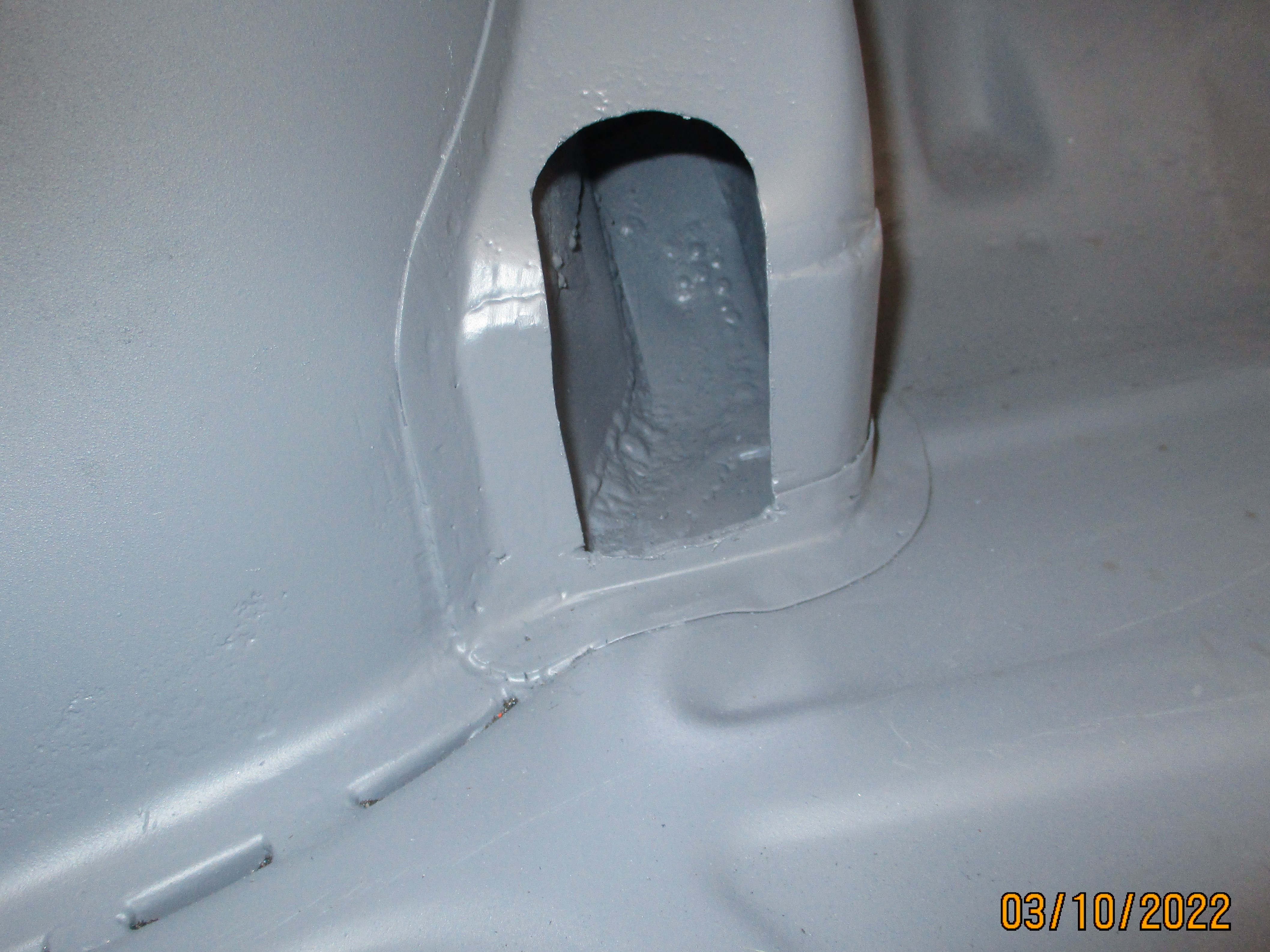

Bullethead   A hidden surprise and angle iron repair.   Apr 1 2022, 08:29 AM
Root_Werks   Given the amount of weathering and stress these li...   Apr 1 2022, 08:44 AM
Bullethead   Thanks for the moral support. Didn't look that...   Apr 1 2022, 10:30 AM
Bullethead   So odd. Rust in places that made sense, in others ...   Apr 1 2022, 10:47 AM
Bullethead   Pans looked decent before stripping, but were perf...   Apr 1 2022, 10:51 AM
