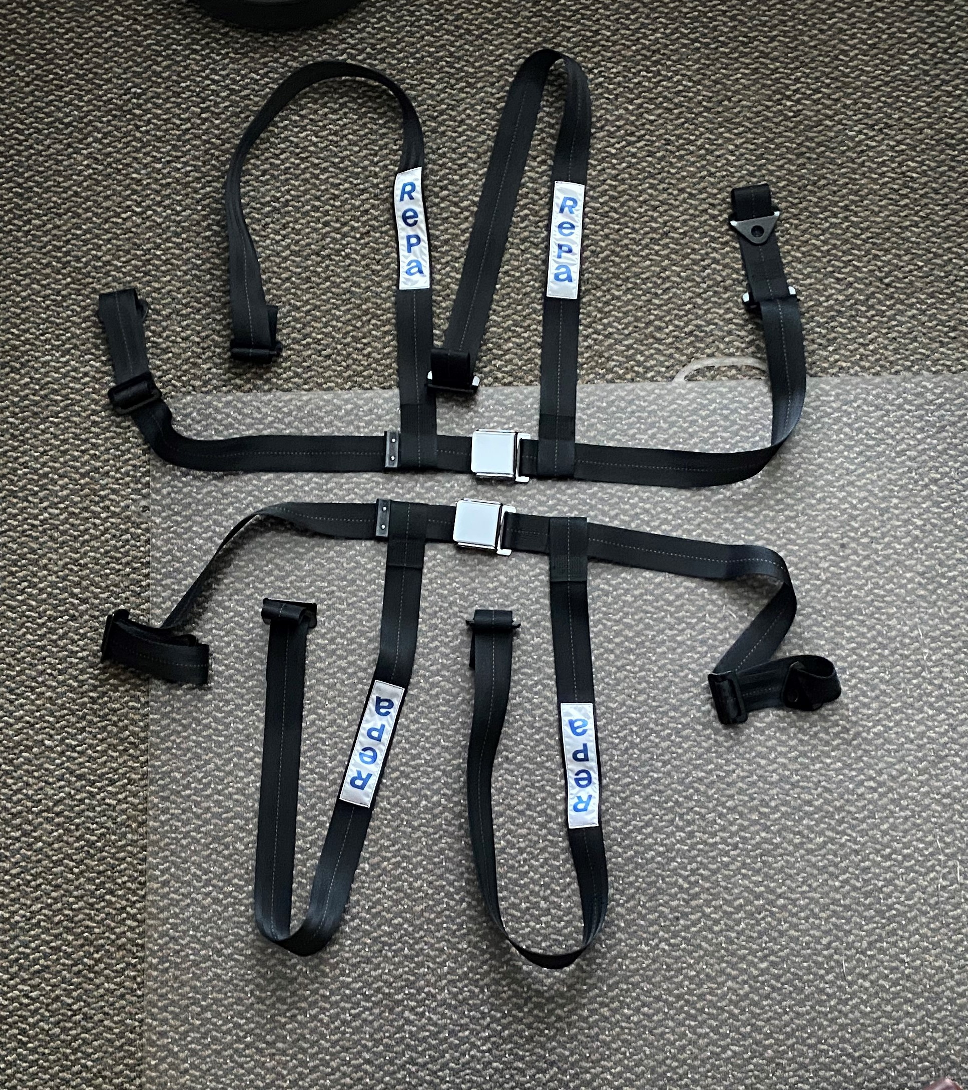

Look what showed up today from the UK.

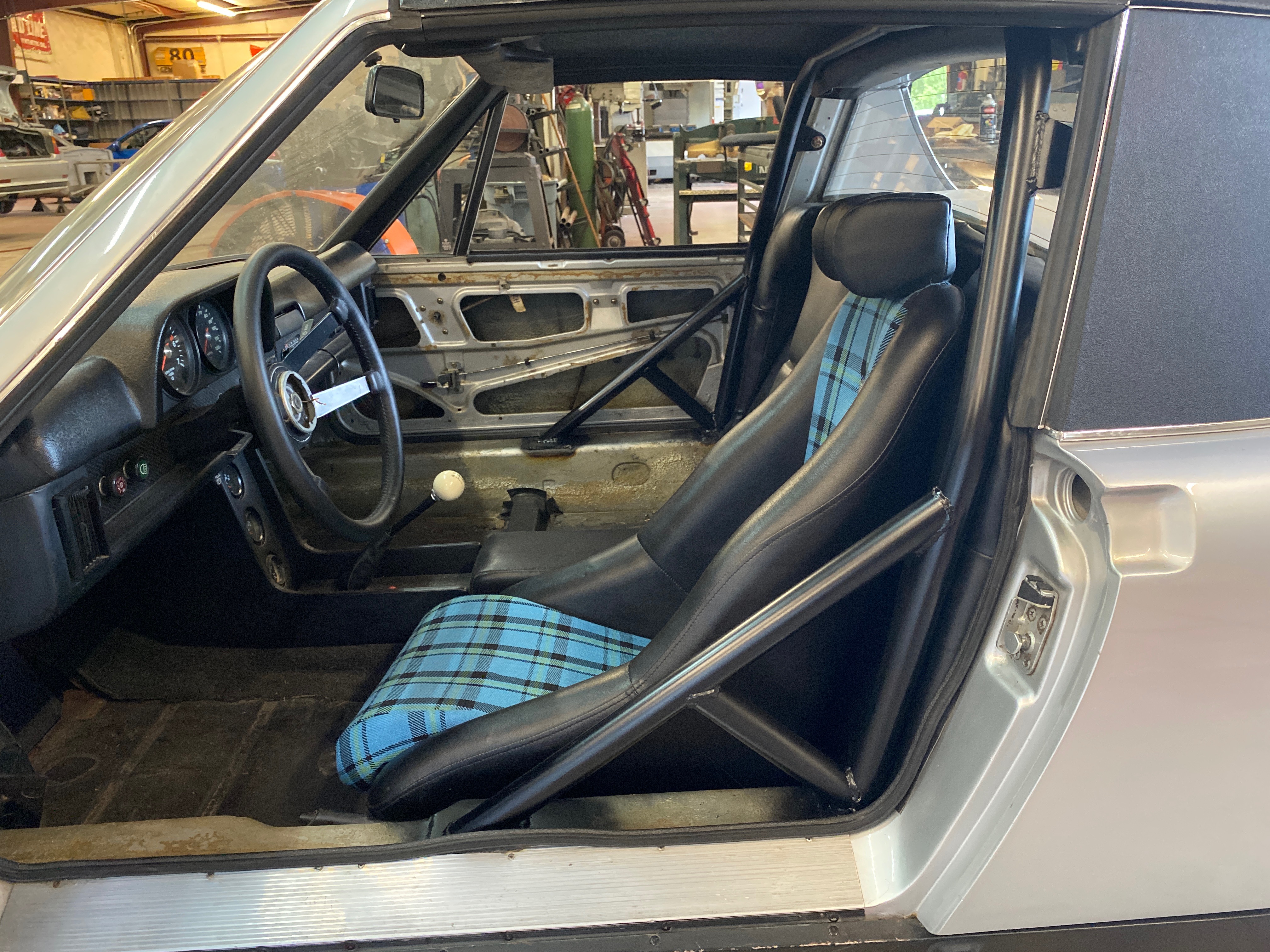

Tom, we fabricated this roll bar that ties into the longitudinals but has a low ‘climb over’. It also fits under the targa top. It works wonders and doesn’t make getting in or out measurably more difficult. I’m sure you can find a competent welder to make you one too.

brant   I still think a roll bar in a street legal car is ...   Apr 12 2022, 07:42 AM
mepstein   I still think a roll bar in a street legal car is...   Apr 12 2022, 09:35 AM
blabla914   Tom, Excited to see how this build turns out. If...   Apr 12 2022, 12:43 PM
ibmiked   Agreed, a roll bar is dangerous without a helmet. ...   Apr 13 2022, 08:01 PM
mepstein   Agreed, a roll bar is dangerous without a helmet....   Apr 13 2022, 08:33 PM
ibmiked   Agreed, a roll bar is dangerous without a helmet...   Apr 14 2022, 07:19 PM
brant   Why ride a motorcycle? Or a bicycle on a public...   Apr 15 2022, 06:43 AM
ClayPerrine   Why ride a motorcycle? Or a bicycle on a publi...   Apr 15 2022, 09:23 AM
lesorubcheek   You are less likely to be hurt in an accident whe...   Apr 16 2022, 10:48 AM
wonkipop   Why ride a motorcycle? Or a bicycle on a publ...   Nov 1 2022, 07:51 PM
davehg   I modded my roll bar in a similar fashion to the a...   Apr 14 2022, 10:02 PM
ibmiked   Getting on a motorcycle or bicycle, even with a he...   Apr 16 2022, 04:16 AM
VegasRacer   A car with a roll bar is indeed dangerous. Several...   Apr 16 2022, 10:34 AM
bahnzai   Hey guys, you know we are kinda walking all over t...   Apr 16 2022, 11:20 AM
