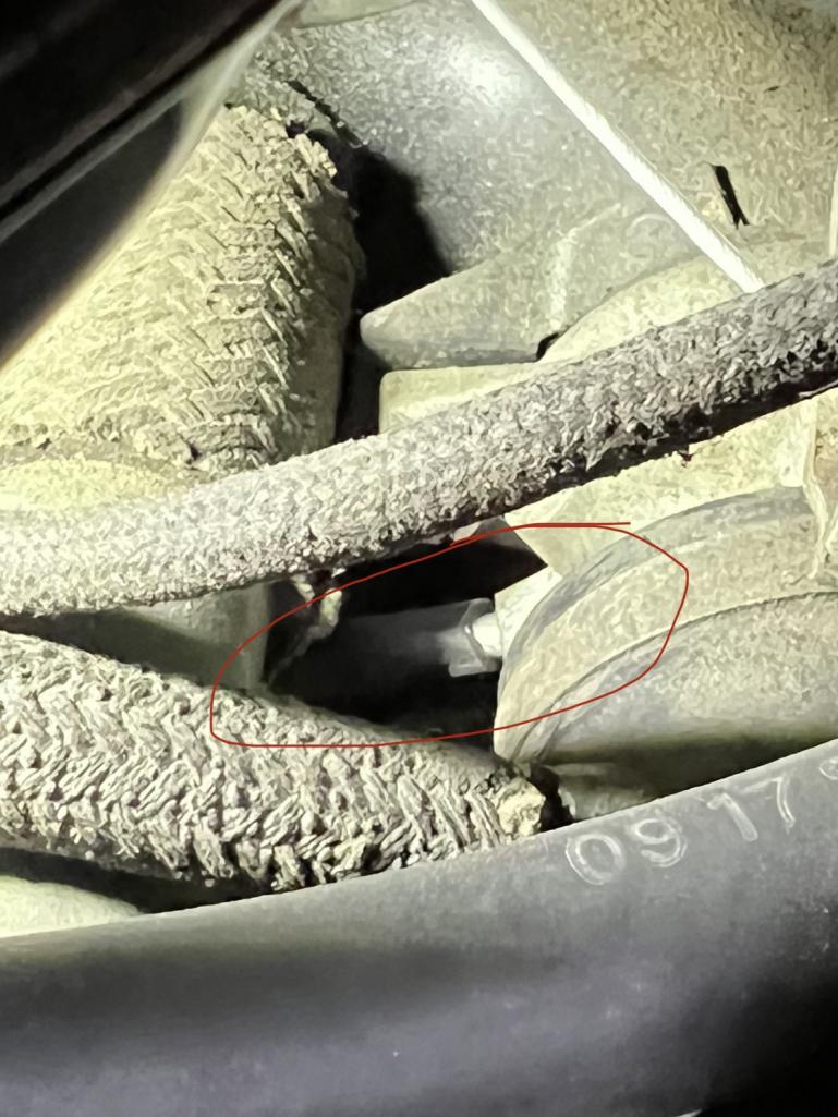

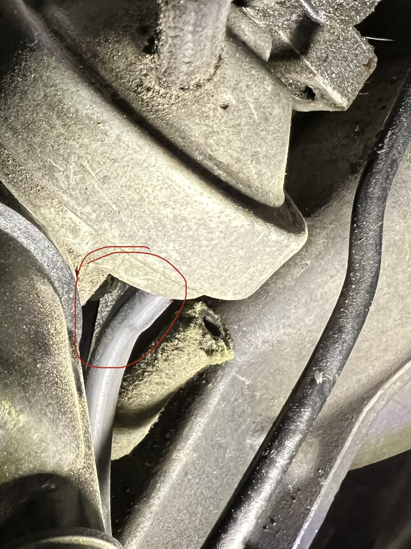

I changed the 4mm line (yellow in the diagram) after the fuel filter change and took the car out for a 10 minite run and there was no bucking at all.
Here is a picture of the new line:
At the throttle body
At the vacuum can
I welcome your feedback.
What is the function of the 4mm vacuum line that I changed? I don't know what it does. Could this have been the problem?
