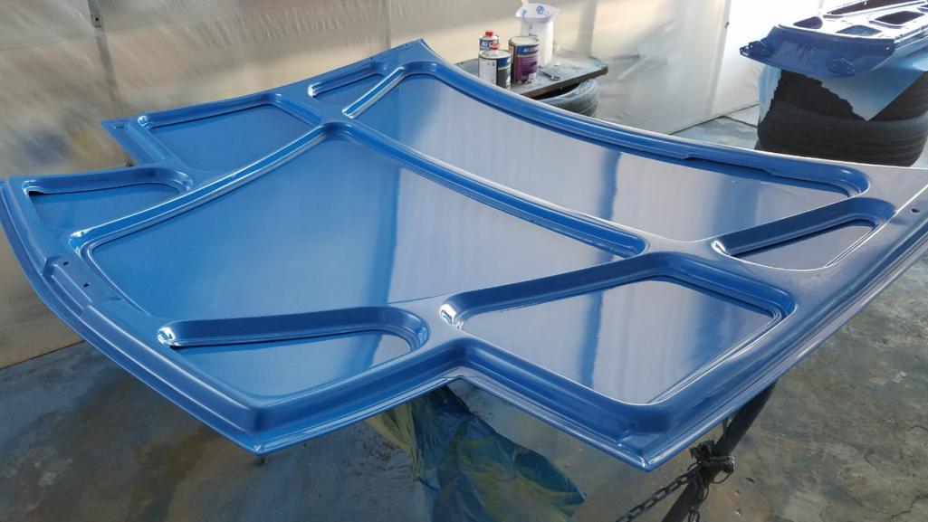

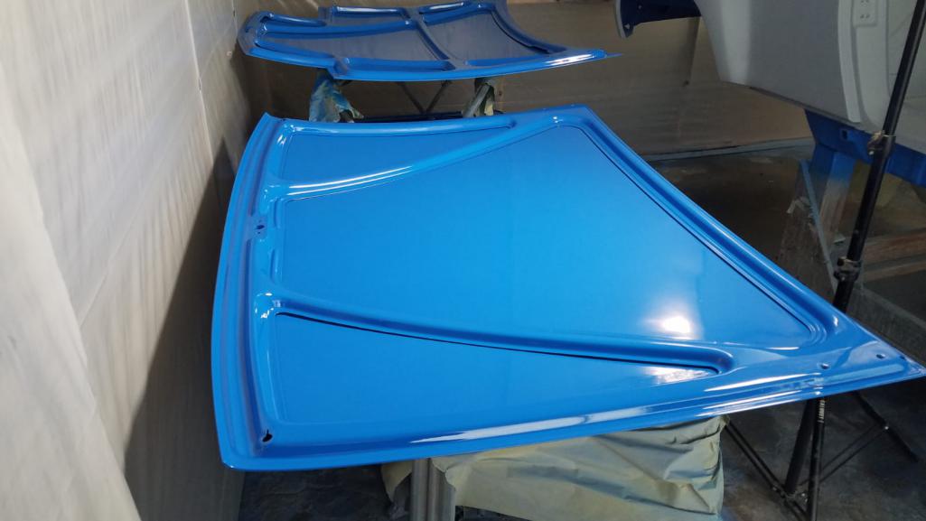

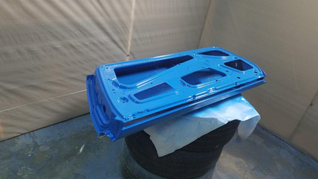

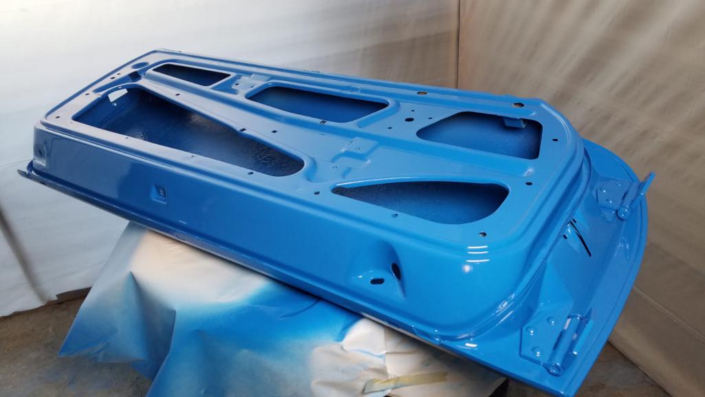

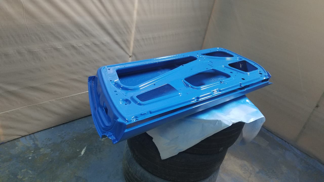

autopro   My latest set of pictures, painting the interiors ...   Apr 28 2022, 04:21 PM
autopro   More   Apr 28 2022, 04:29 PM
autopro   A couple from the engine compartment After th...   Apr 28 2022, 04:36 PM
autopro   Here they are all cleared   Apr 28 2022, 04:42 PM
