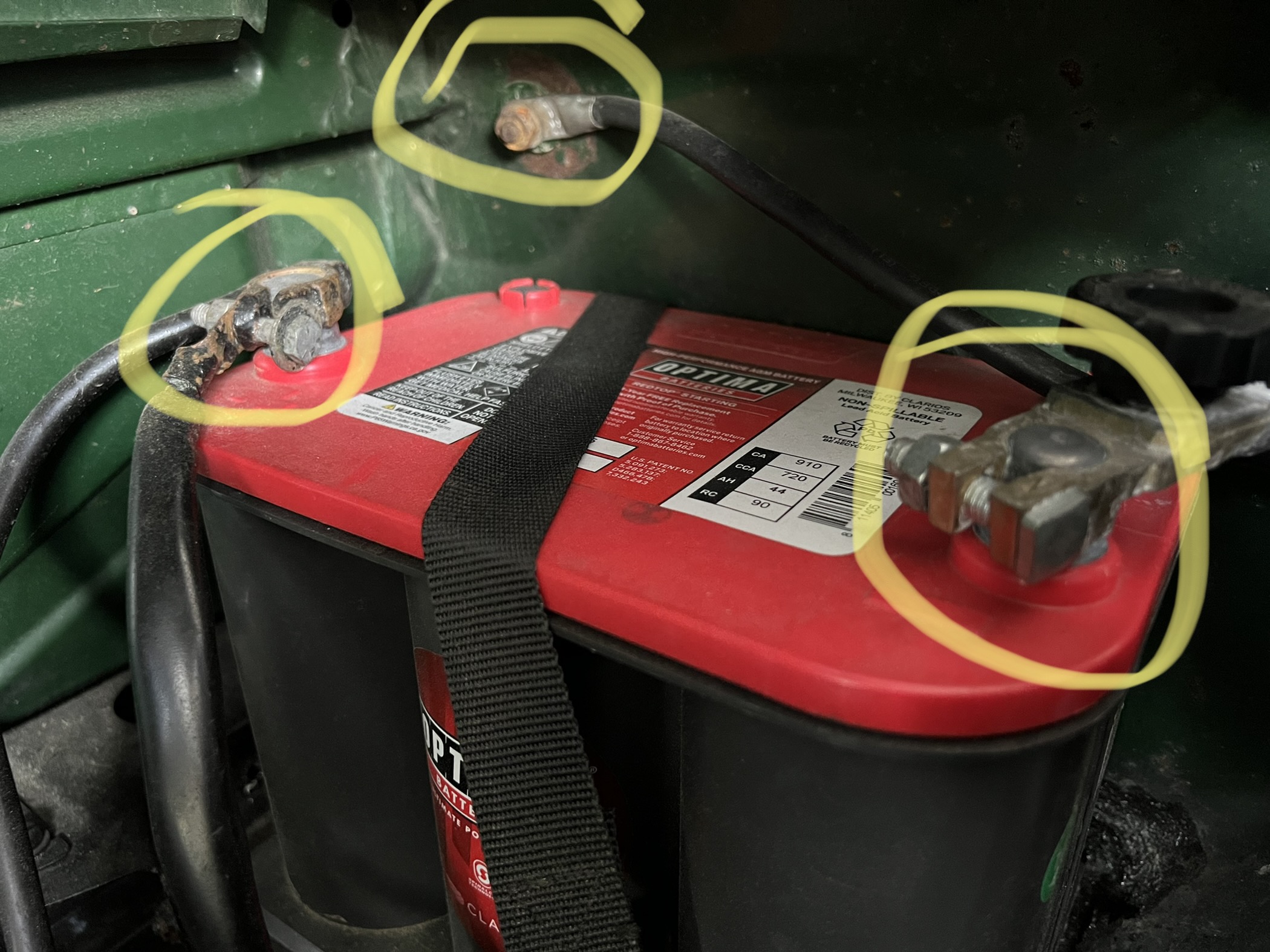

I have more data to report on this issue.
The car has driven flawlessly up until yesterday when I started it cold and it ran rough and when I drove it it was bucking.
I drove for about 1/4 mile with lots of bucking and then turned it off.
About 30 minutes later I tried to start it and it was completely dead no click, no lights no nothing upon turning the key.
I opened the hood and manipulated the battery wires.
I've included a picture with yellow circles around the wires that I manipulated.
I turned the key and it started fine and no bucking.
This would suggest that this is an electrical issue, yes?
Is there a map on the web somewhere of the ground wires that I can check?
Any other suggestions?

boxster914   I have more data to report on this issue. The car...   Apr 28 2022, 05:18 PM
Lockwodo   I have more data to report on this issue. The ca...   Apr 29 2022, 06:57 AM
wonkipop   I have more data to report on this issue. The ca...   Apr 29 2022, 08:24 PM
emerygt350   Interesting! All kinds of badness can result ...   Apr 29 2022, 04:25 AM
ChrisFoley   The clamp on the positive cable appears pretty tir...   Apr 29 2022, 04:43 AM
boxster914   Yes @wonkipop the wires did seem tight to me. I ...   Apr 30 2022, 04:01 PM
wonkipop   Yes [b]@[url=http://www.914world.com/bbs2/index....   Apr 30 2022, 06:08 PM
Lockwodo   I've come to believe that battery cables shoul...   Apr 30 2022, 05:41 PM
boxster914   Thank you all for your input. Thank you @lockwod...   May 1 2022, 08:26 AM
Lockwodo   Thank you all for your input. Thank you [b]@[ur...   May 1 2022, 09:36 AM
