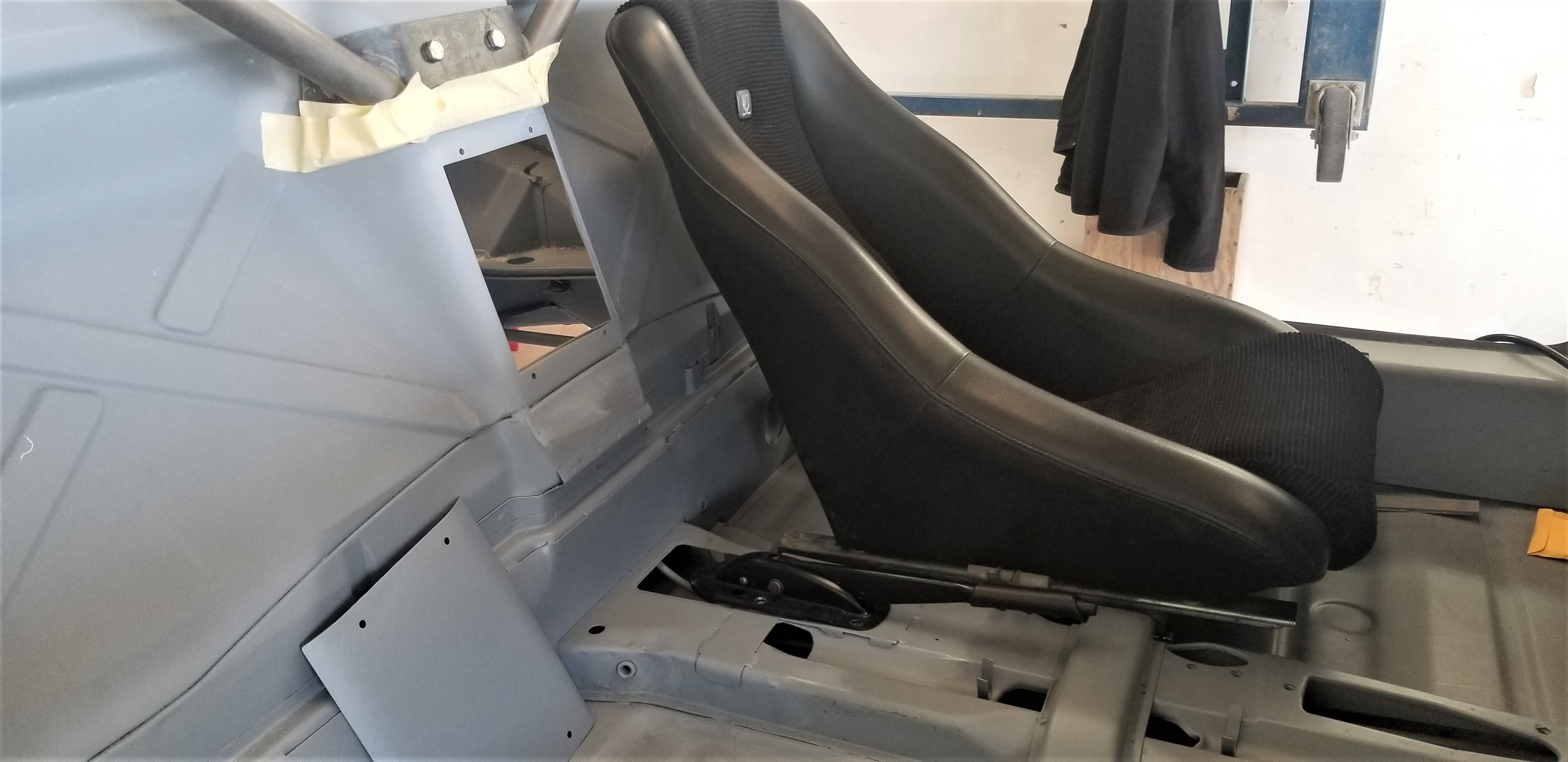

More progress this week: engine access cut, handbrake relocation and driver's seat rails complete, body got mud and some finish sanding, and just for fun the engine grill was dropped into place.
The next 4-6 weeks will be little stuff like harness brackets, auxiliary lighting mounts and paint prep. Moving along nicely.

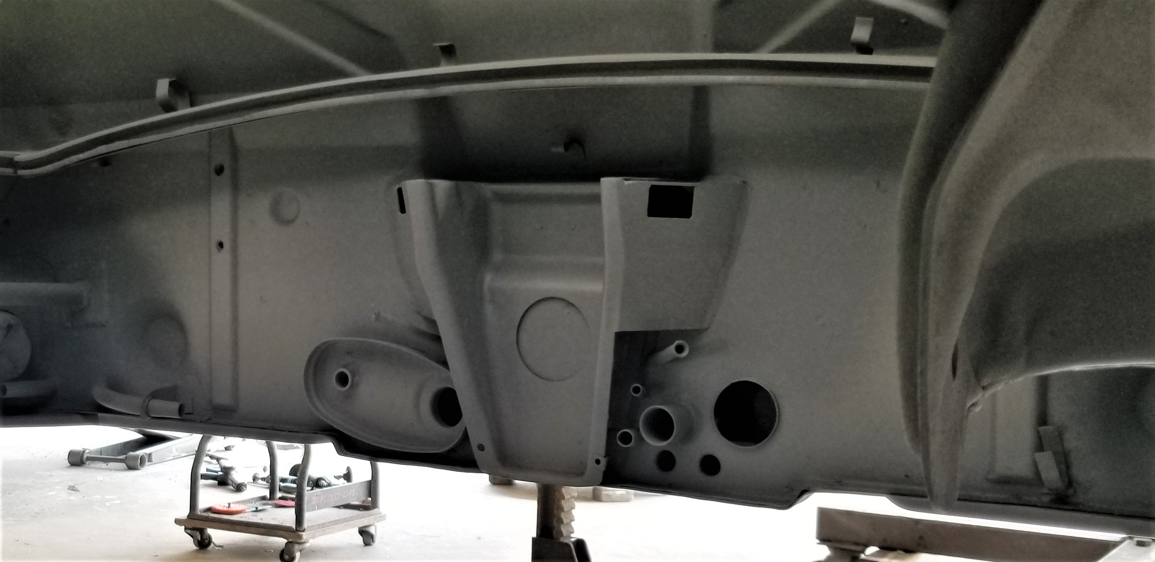

Bullethead   Engine mount and suspension reinforcements...   Apr 1 2022, 12:13 PM

Bullethead   As of yesterday, determined seat locations with th...   Apr 1 2022, 12:59 PM
