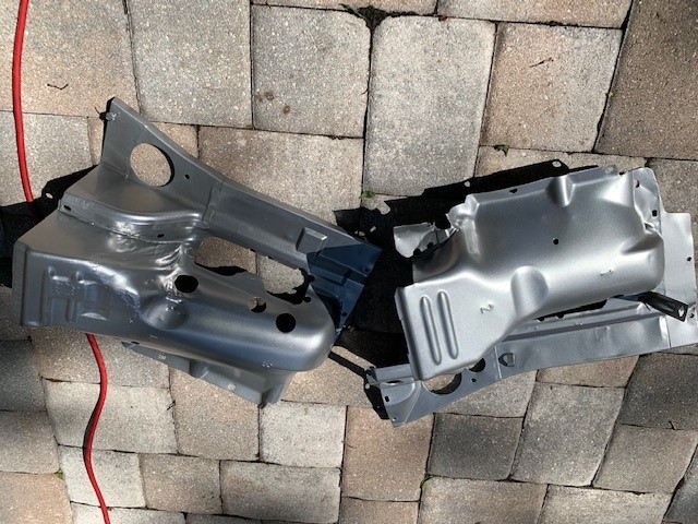

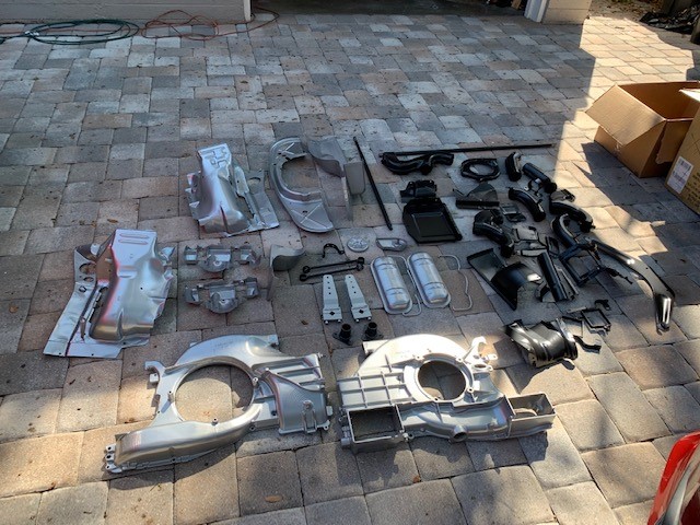

I truly appreciate all the tips and support on welding that were provided. The suggestions and links helped me a lot and I'm happy with how the tins came out for a very first time welding effort.
To finished this one out, here are the Tins back from powder coating...
Thanks and (IMG:style_emoticons/default/beer3.gif)
Good job, I just did all that... X8 sets.
