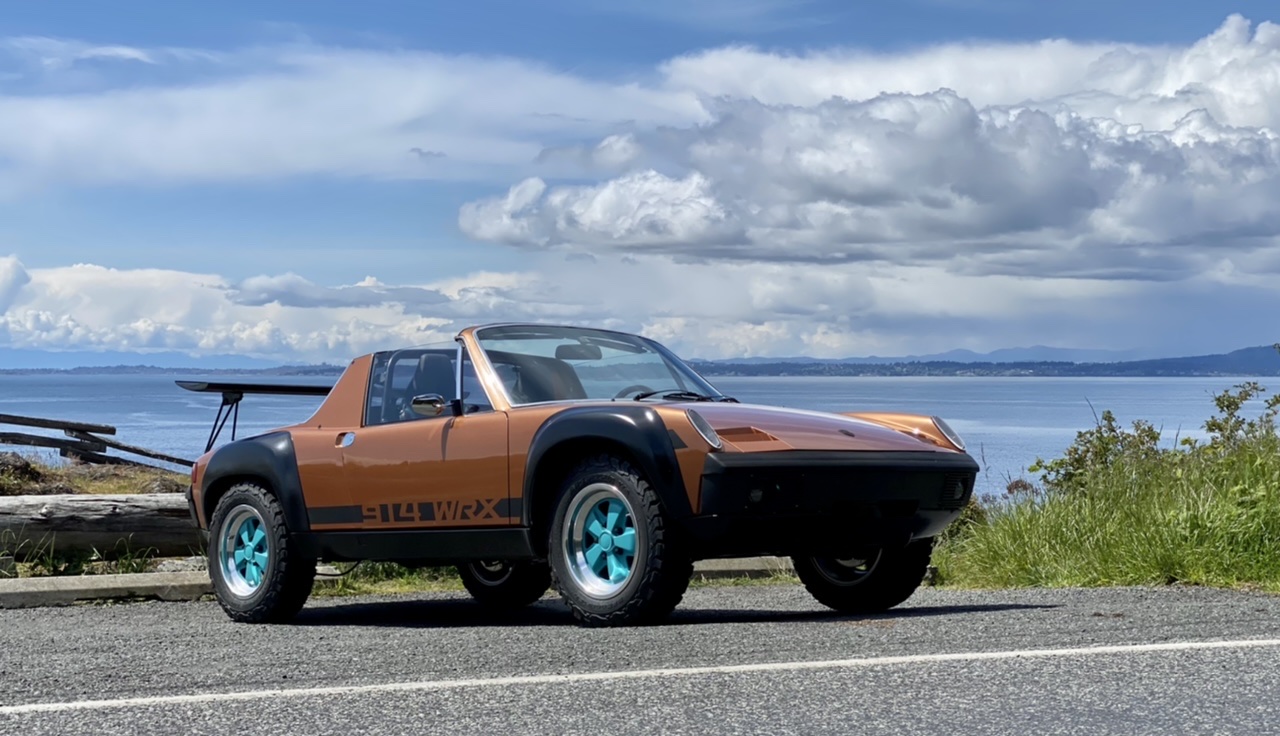

After seeing some recent posts, I decided it was finally time to thank everybody on this forum for years of encouragement and scope creep on my long term project. As with every real project, this will never be done, and there are certainly many things I would do differently a second time around. But I am 80% of the way there, and I am enjoying driving it as much as I am working on it for the last year or so.
I plan to add more photos of my build process over the next few weeks. You may see some of the advice you gave me realized, and probably some bad or good ideas in metal, fiberglass, and wood.
Hopefully I can help someone else out too.
-Steve
Here are some recent photos:
And a few from about 4 years ago:

Had a chance to get out and put a couple hundred miles on the current configuration this weekend. Perfect day for no top and heat. Seems to be working well so far.
