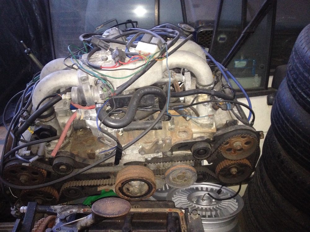

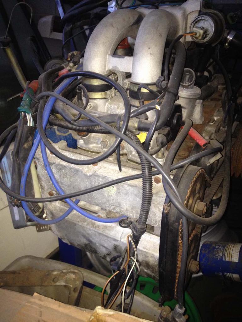

@euro911
we have this lying around in the workshop.
i took some snaps today after seeing why that guy cut open the vw muffler.
think it came out of a sprint. (angular fastback version of the sud/33.
twin cam boxer (quad cam?) 4V heads, fuel injection.
think this one is a 1.7 and good for about 120 hp but don't quote me.
the plan was to stick it in an old sud that has CAMS approval, roll cage etc, and take it to the salt lake in south australia for a bonneville style run.
we are still trying to figure out if its better to stay in 1.5L class with standard sud engine or go big with this one -----cept its not big enough because it bumps you into the 1.5-2.0L category.
its an impressive little engine. this one would need a good going through but apparently it is all there and it was not detonated.
might seem off topic, but if you don't want to sound like a beetle, then maybe its more than a muffler required?
