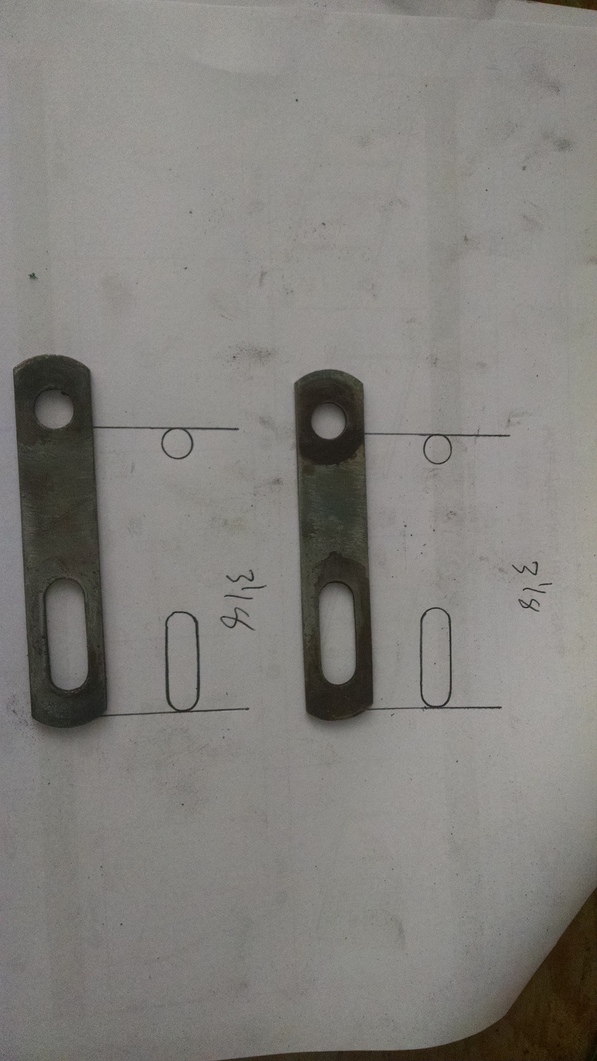

Posting an update to this thread.
Pulled the limit straps off and measured the end-to-end. Probably more like 3 3/16" because of the ink pen. I think I'll weld up to reduce the travel by 1/8".
Unless anyone has done something different or better? Can't find new straps, that would be nice.

Root_Werks   Posting an update to this thread. Pulled the limi...   May 10 2022, 11:58 AM
Root_Werks   If anyone embarks on making the strap travel short...   May 12 2022, 11:30 AM
