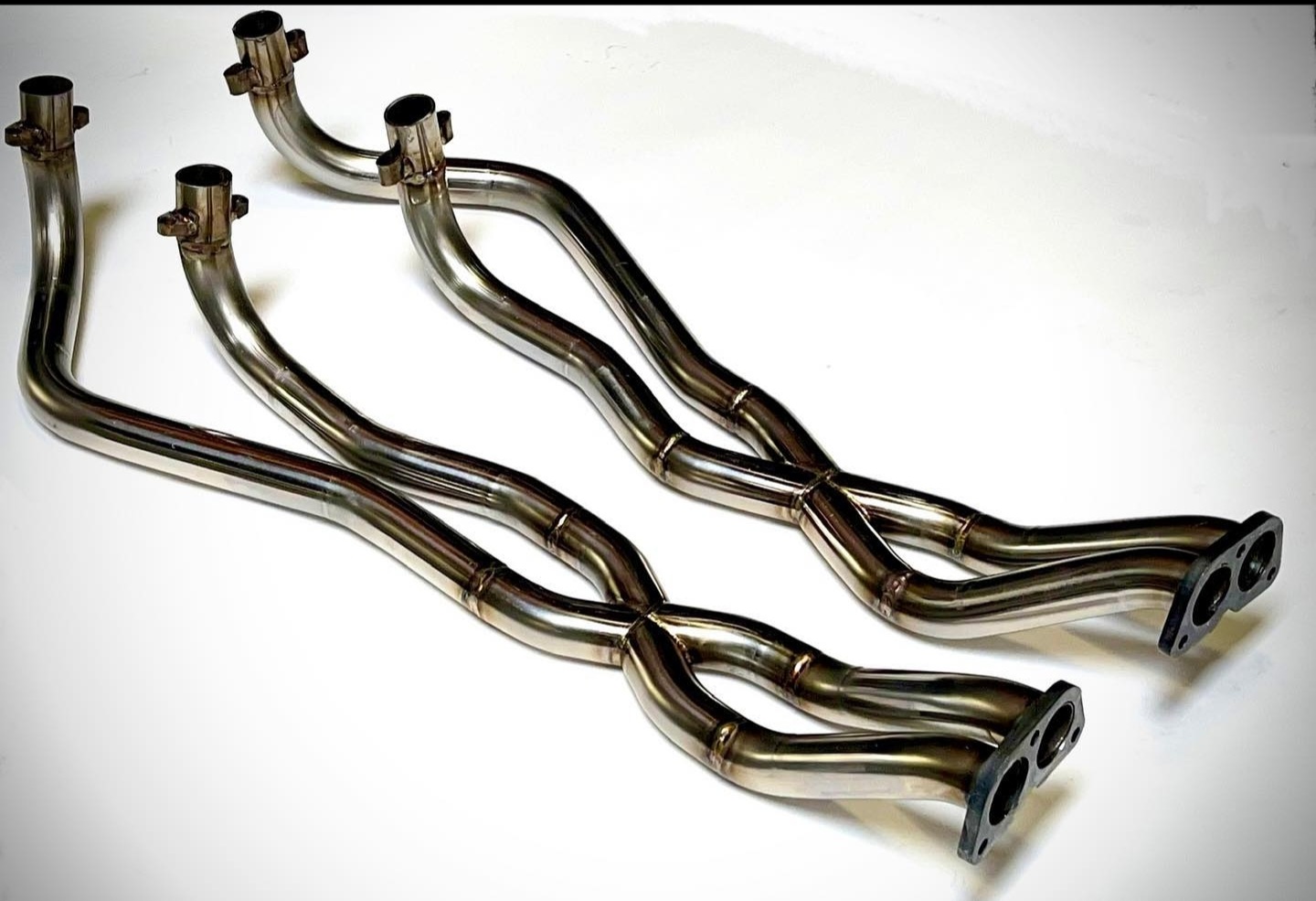

Pairing 1-4 and 2-3 is no better than pairing 1-2 and 3-4. Adjacent cylinders in the firing order should not be paired. It doesn't work well from a performance standpoint.
The correct pairing is 1-3 and 2-4. Front pair, Rear pair.

QUOTE(ChrisFoley @ May 9 2022, 04:13 PM) *
Chris...looks like the fabrication dept. didn't get the memo regarding proper Pairing of T4 tubes; this set of "Headers" is pictured on the Bursch iGram page.
Maybe they are just after Sound and not Perf ¿?
Good craftsmanship on the TiG work, polished T304...anticipating RWHP (independent before/after) dyno testing results (IMG:style_emoticons/default/idea.gif)
