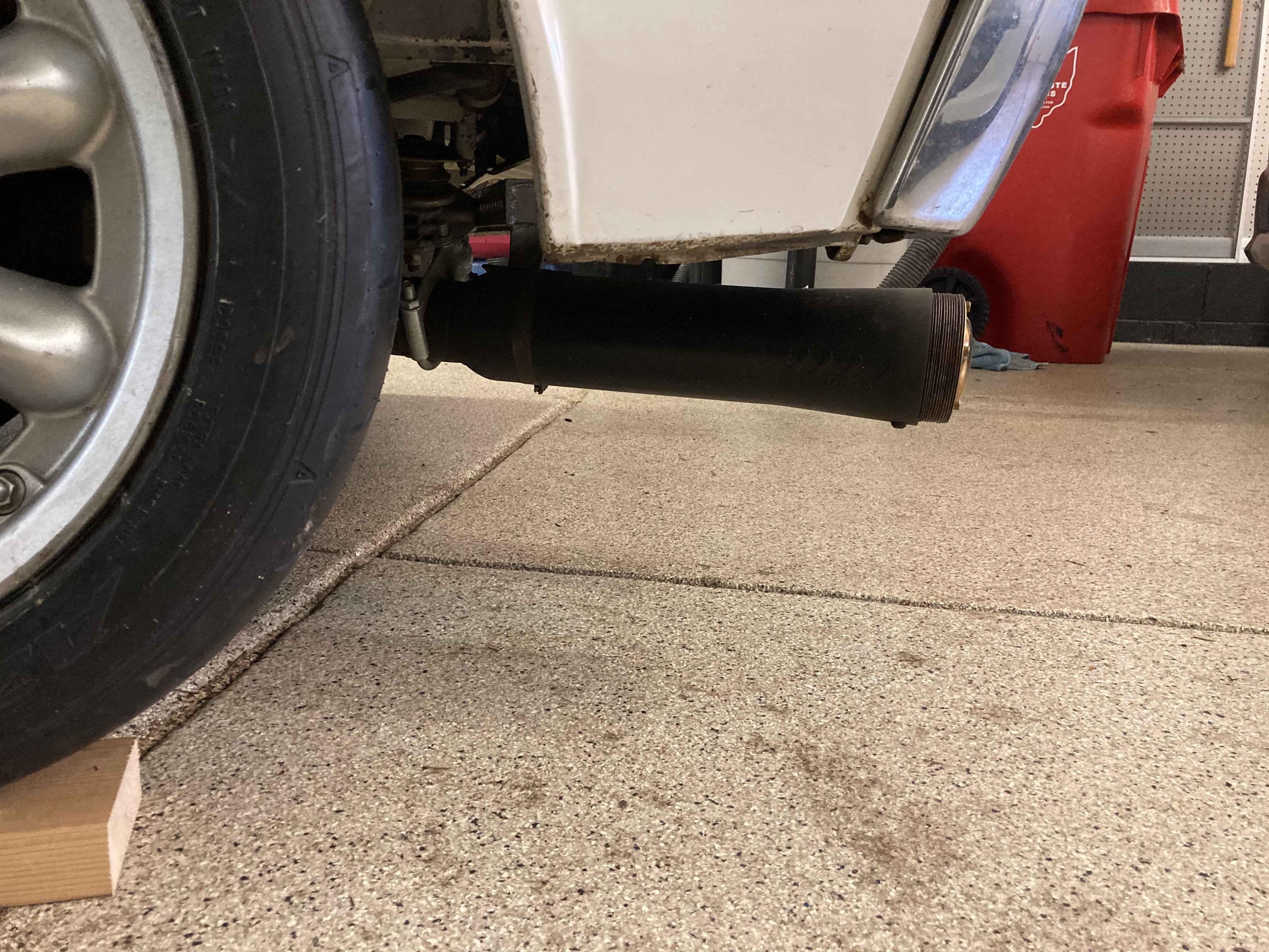

> How to make a '74 1.8L sound less like a VW bug, Would this necessitate a muffler change? Muffler modification? Exhaust tip?

Looking to improve the sound of my '74 1.8L ... make is less like a VW Bug ((
