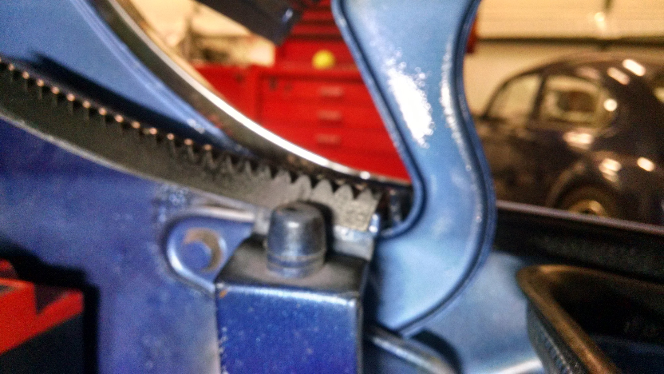

If anyone embarks on making the strap travel shorter, 3" works. The hinge still touches the grills, barely and doesn't seem to push up on them at all. I would say strap limit travel would start at least 3" from end to end.
Crappy picture, I still need to replace the rubber stops.

Root_Werks   Posting an update to this thread. Pulled the limi...   May 10 2022, 11:58 AM
Root_Werks   If anyone embarks on making the strap travel short...   May 12 2022, 11:30 AM
