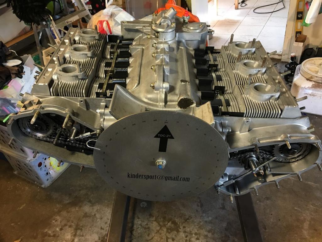

All 3 exhaust rockers broke on one side (4,5,6) when I started my engine for the first rime after cam and rocker re grind.
What’s the likely cause here folks?

Superhawk996   Lots of possibilities. None of them good. I...   May 16 2022, 09:38 AM
David Stowers   Lots of possibilities. None of them good. I...   May 16 2022, 09:42 AM
nditiz1   At what point did they break? Did the cam timing ...   May 16 2022, 10:02 AM

mb911   Ugh what a sick feeling. My guess is wrong cam tim...   May 16 2022, 04:31 PM

fixer34   Assuming the pistons hit the exhaust valves while ...   May 16 2022, 05:44 PM
r_towle   The valve hit the piston. Either valve timing or c...   May 16 2022, 06:07 PM
sixnotfour   Bad News, you bumped cast pistons....   May 16 2022, 09:07 PM
mepstein   cam timed 180 degrees out? It happens.   May 16 2022, 09:19 PM

Retroracer   Like @FIxer34 suggested, missing or sheared cam ...   May 17 2022, 07:18 AM

sixnotfour   Many shops have the tools ,but have done 180 out a...   May 17 2022, 08:15 PM
Luke M   Have you checked the valve to piston clearance ? T...   May 18 2022, 08:13 AM
ClayPerrine   I have lots of experience with setting the cam tim...   May 18 2022, 11:04 AM
