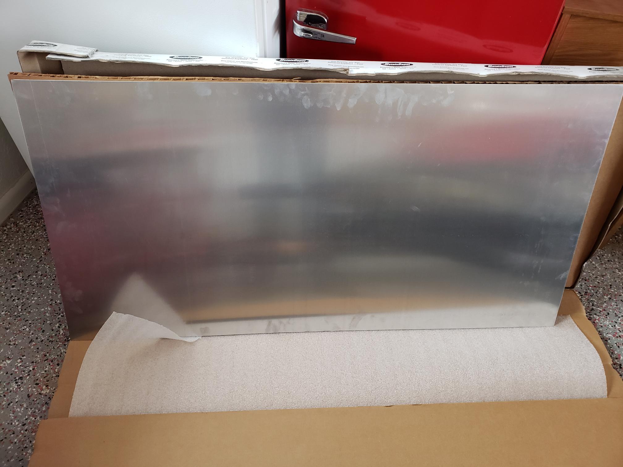

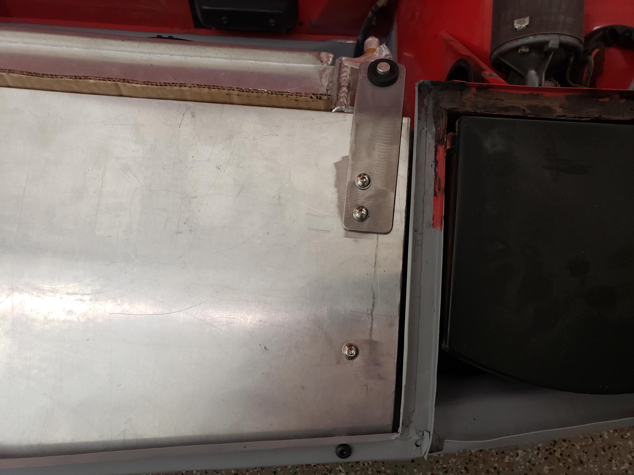

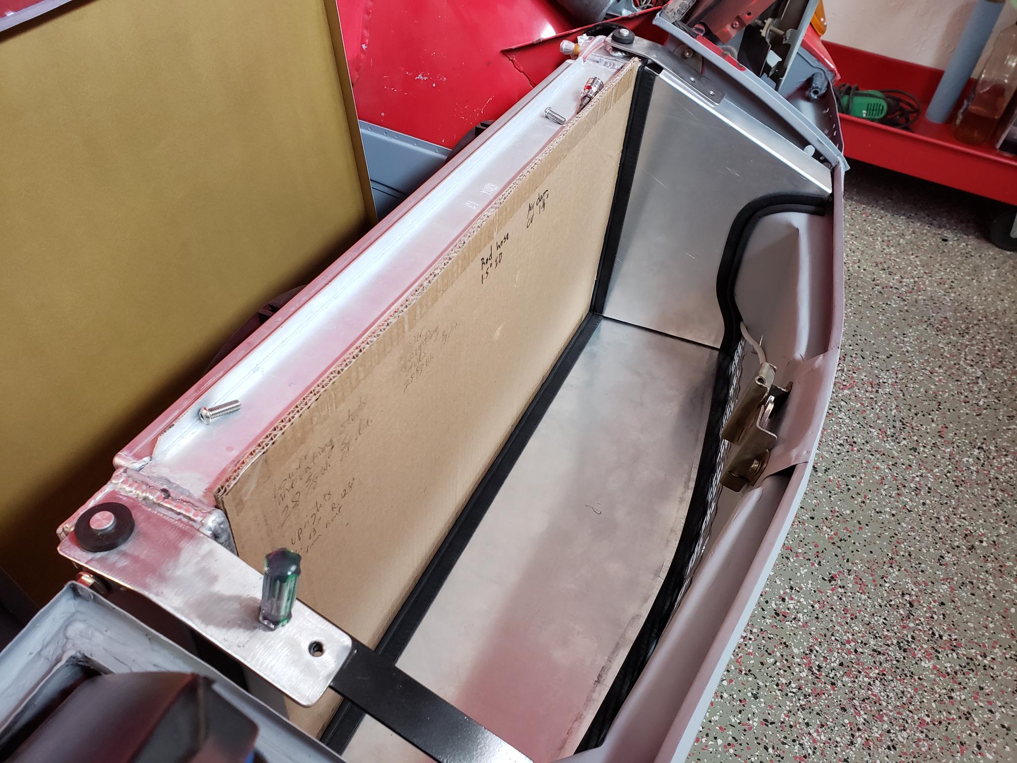

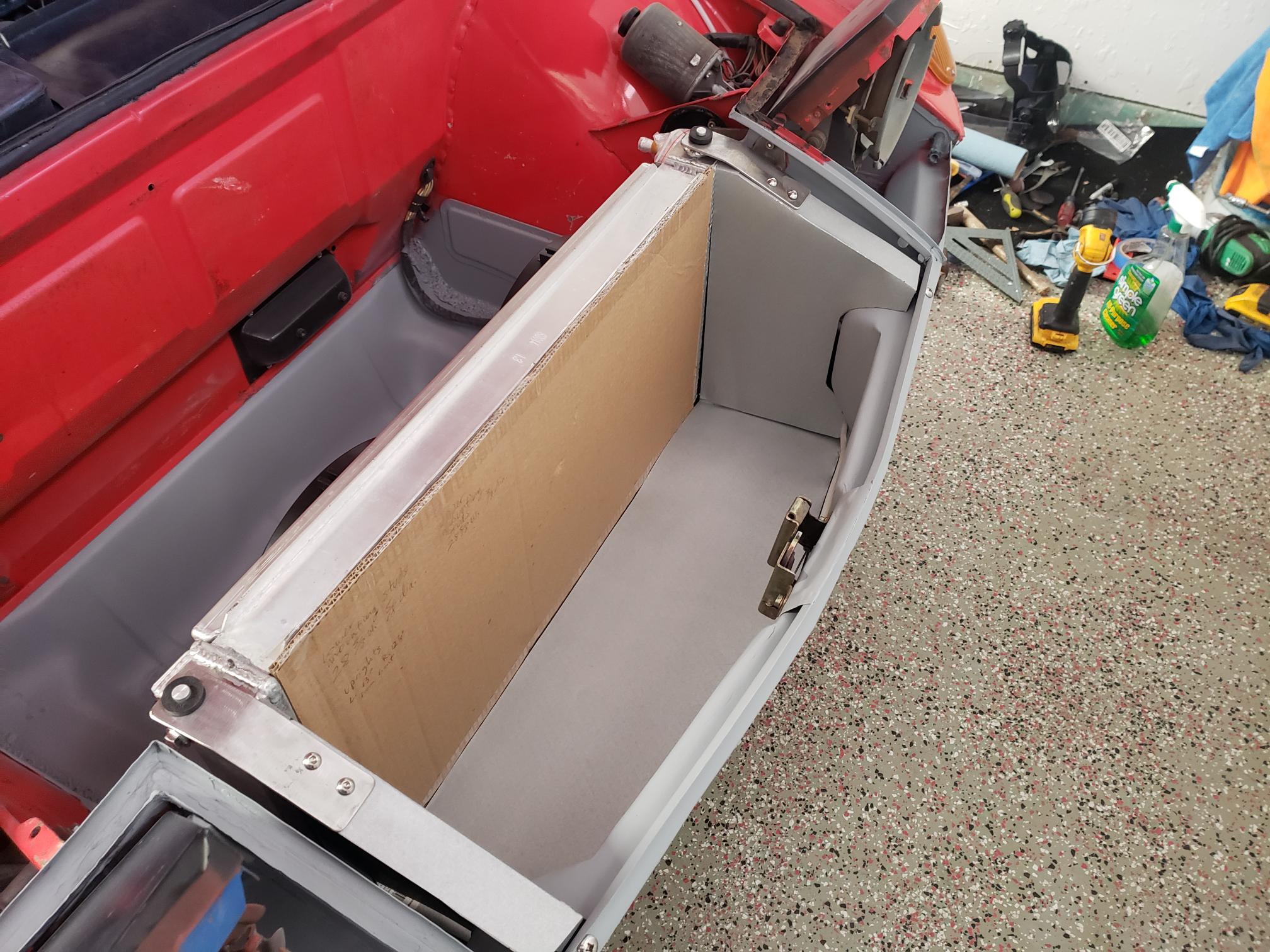

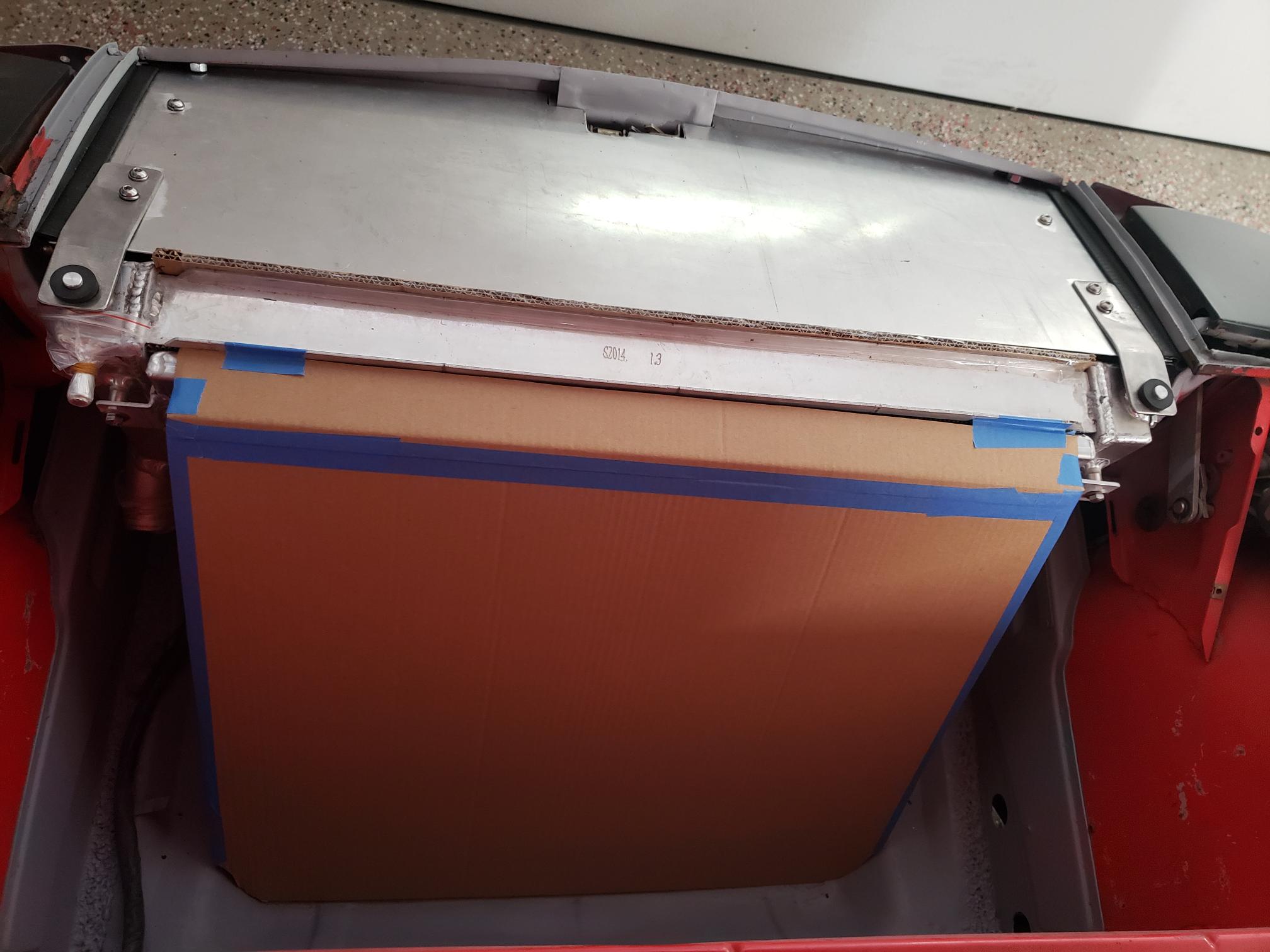

Time for a little update here. Up next was making aluminum sheet ducting on both sides of the radiator. I started with the inlet side:
Card stock template (card stock is silver, so not metal yet):
Metal brake ordered from Jegs:
First delivery of aluminum sheet, fairly light duty at .050:

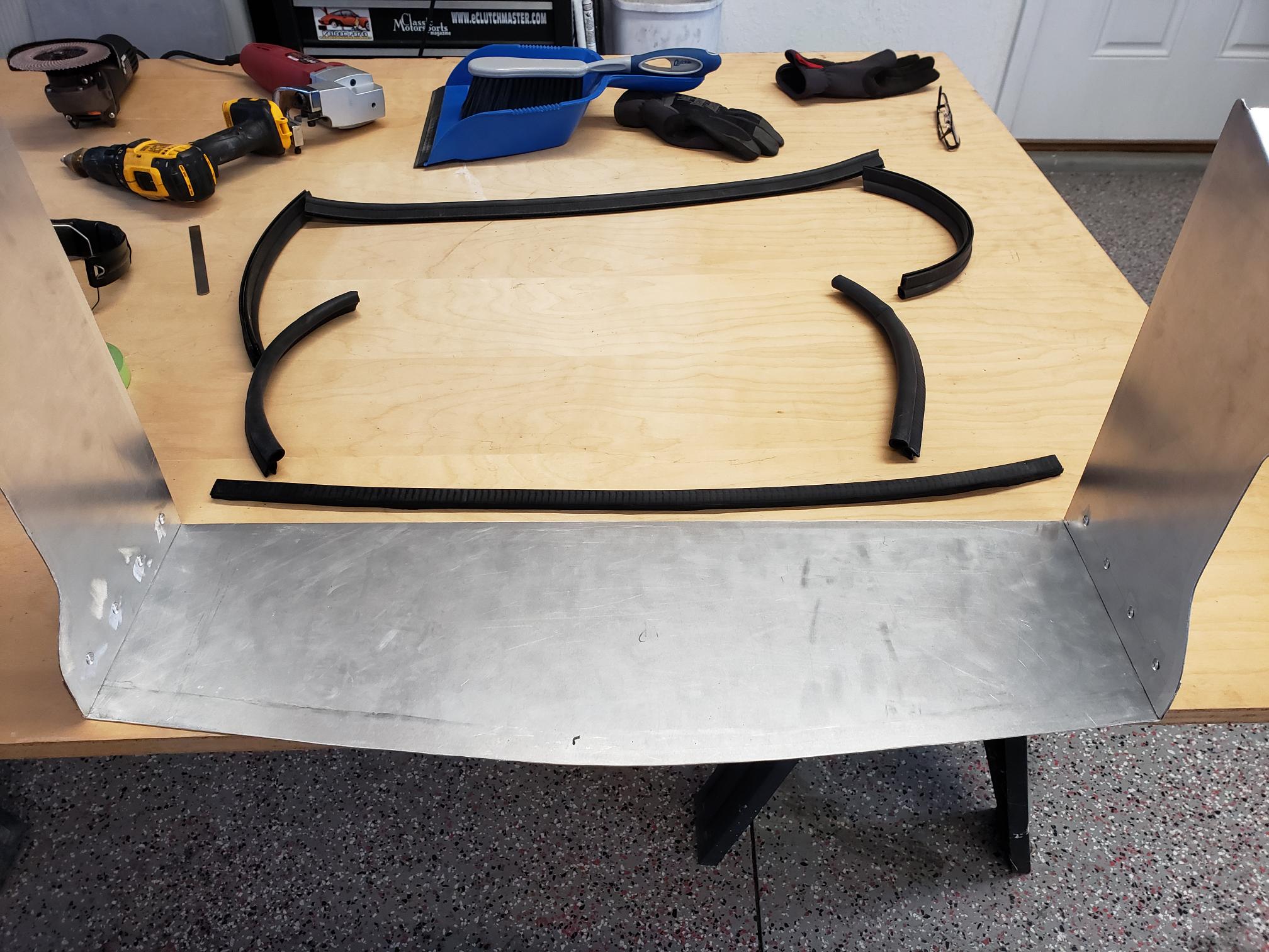

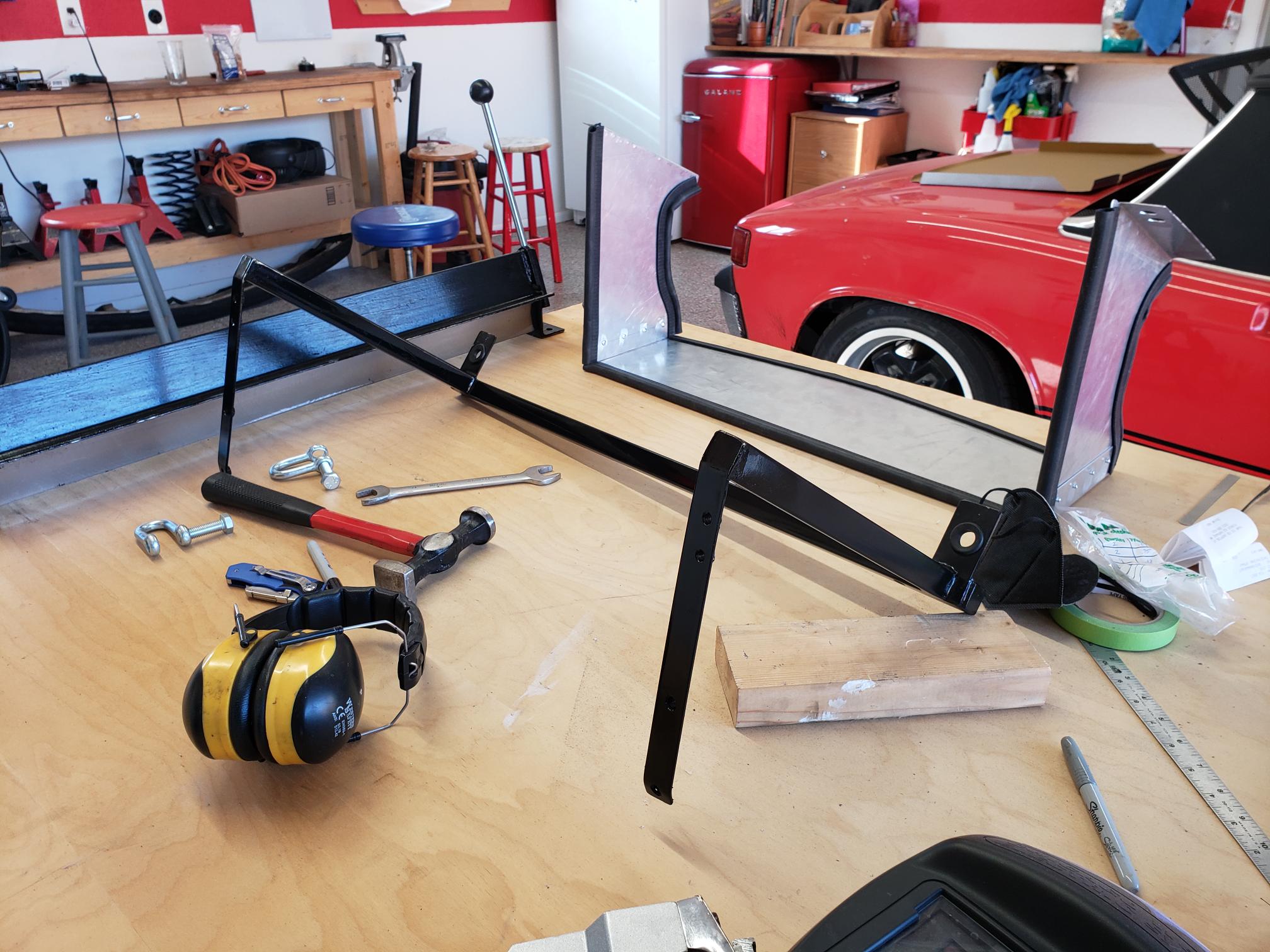

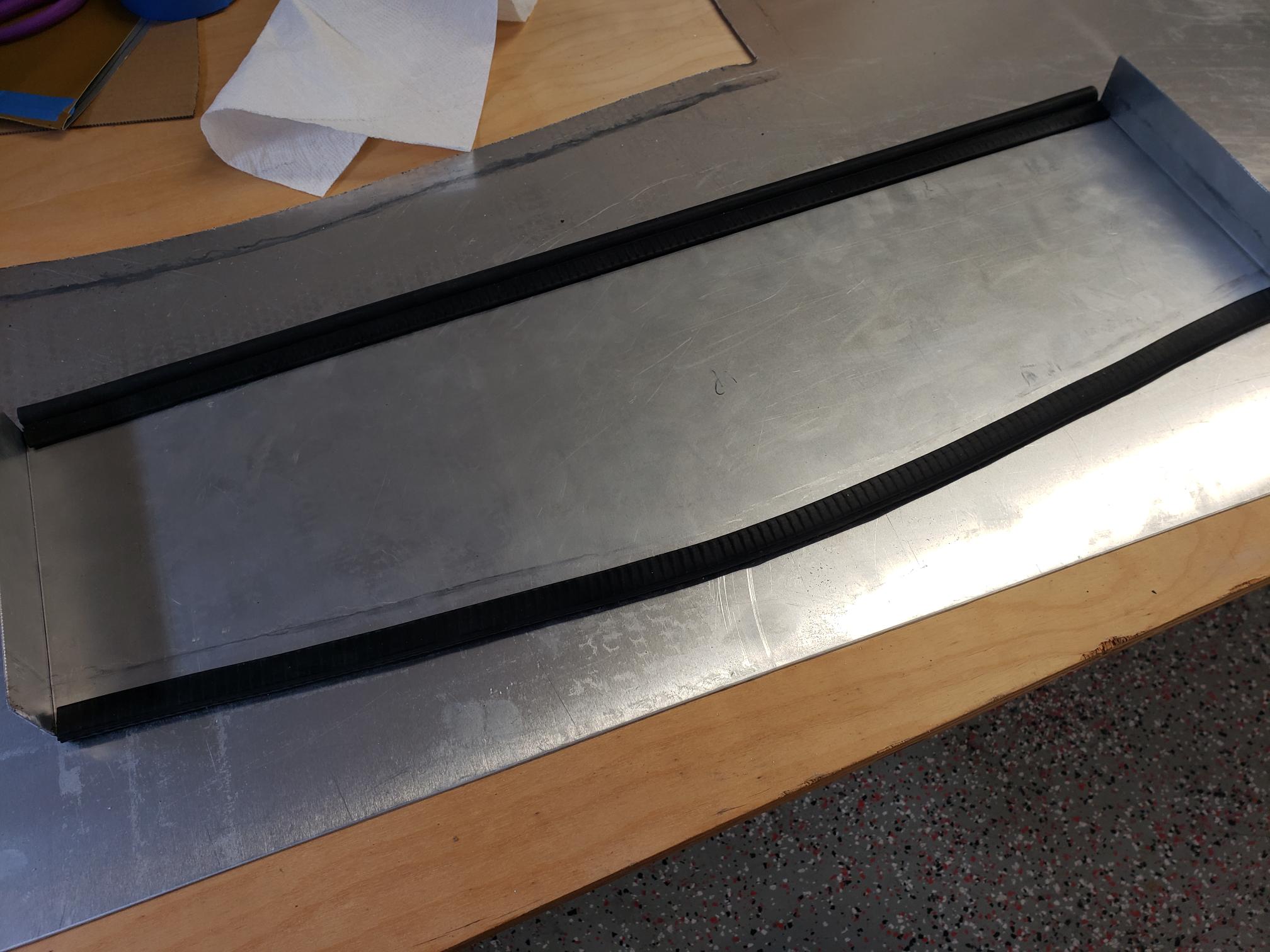

Duct floor:
Duct floor and walls riveted together. I'm using weather stripping with "top bulb" rubber tube to help fill in an irregular edges:

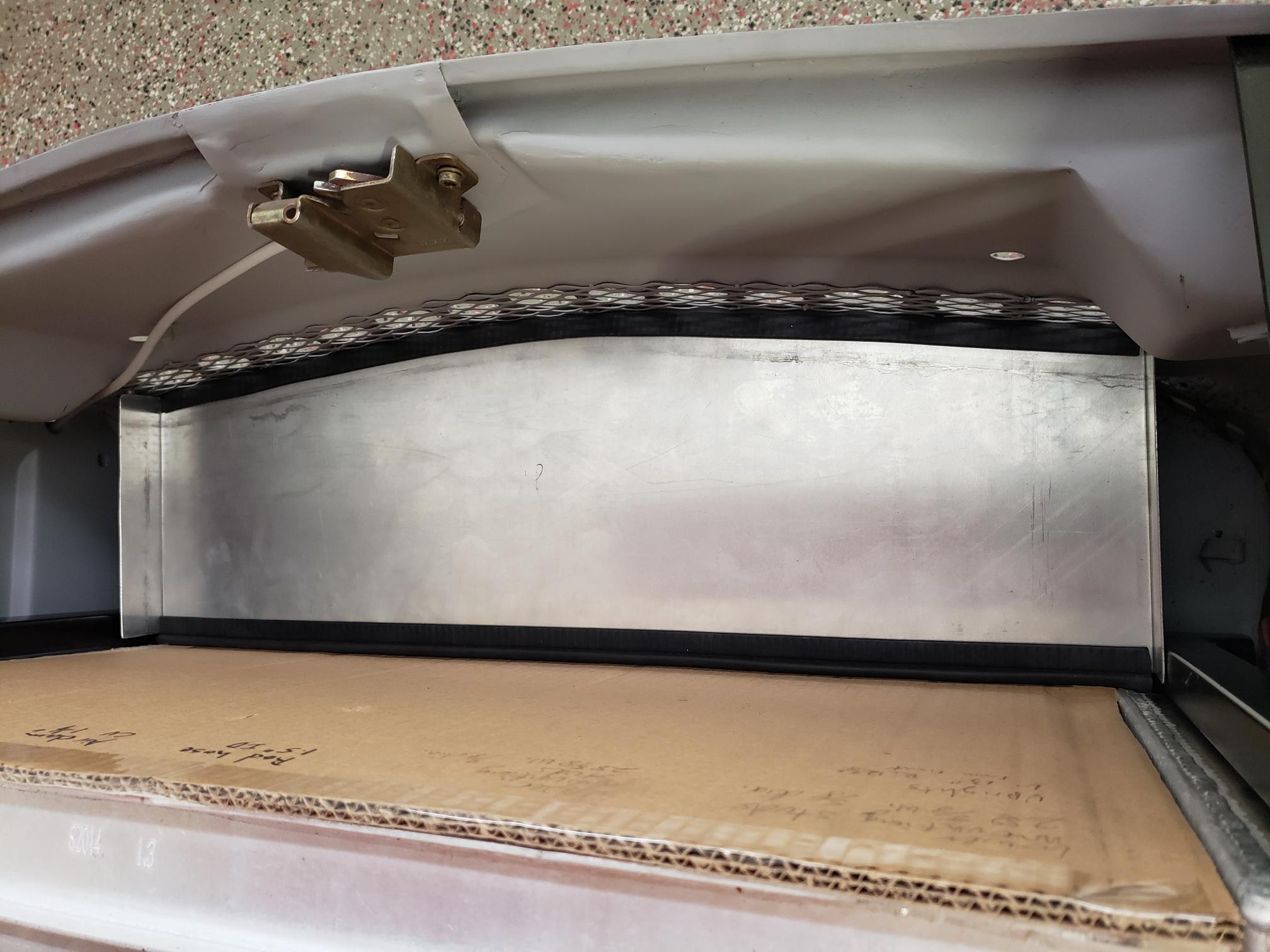

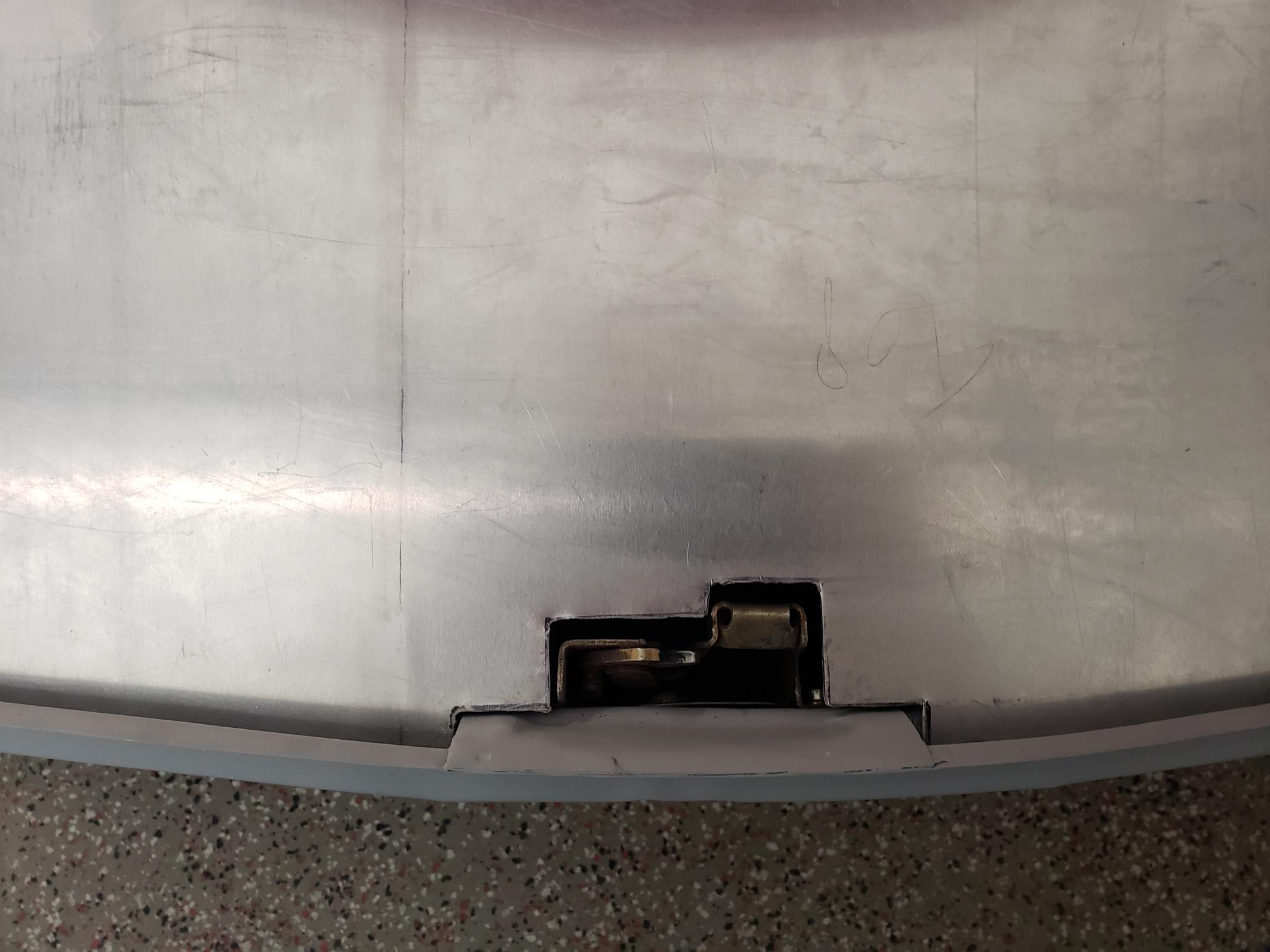

Here's the top and a close-up of the rough opening for the latch. I'll figure out some way to finish it off a bit. Also a close-up of mounting method.

Mayne   At that point, I got a little delivery >:D : ...   May 27 2022, 08:54 AM
Mayne   Next up was getting on to the exit side of the rad...   May 27 2022, 09:05 AM
