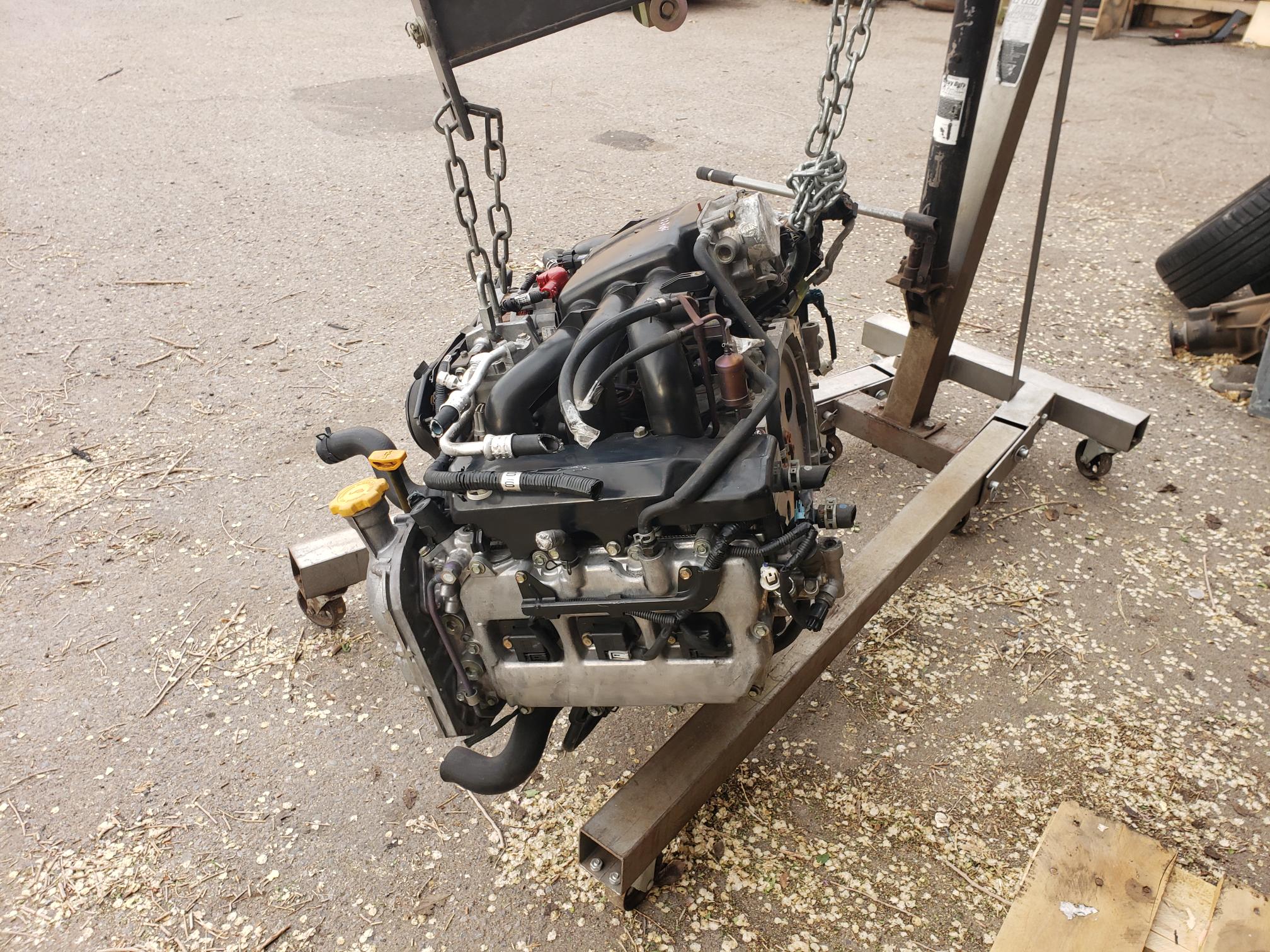

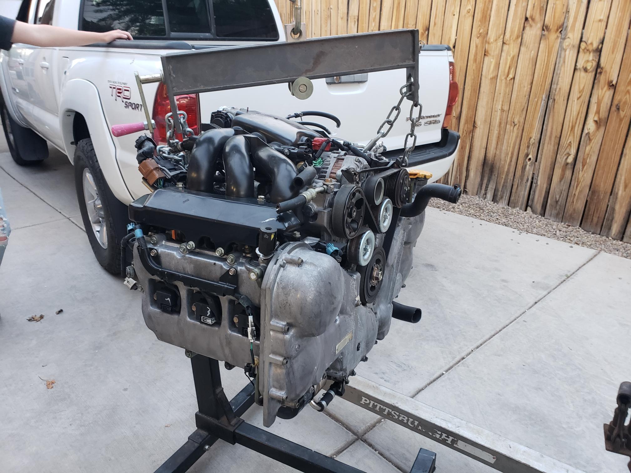

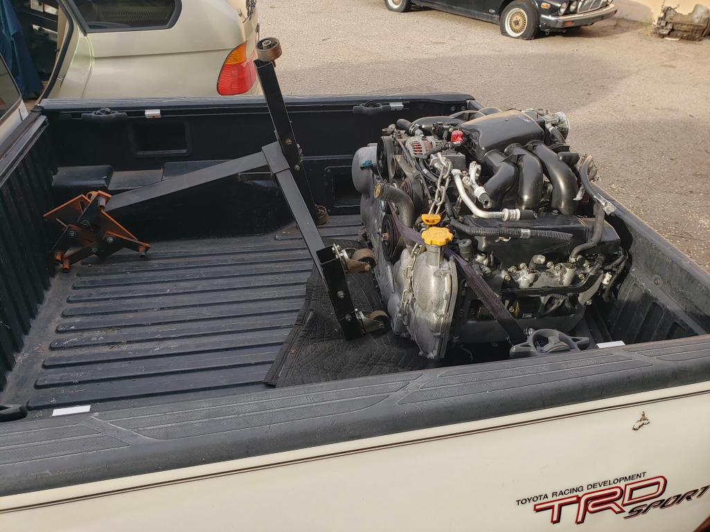

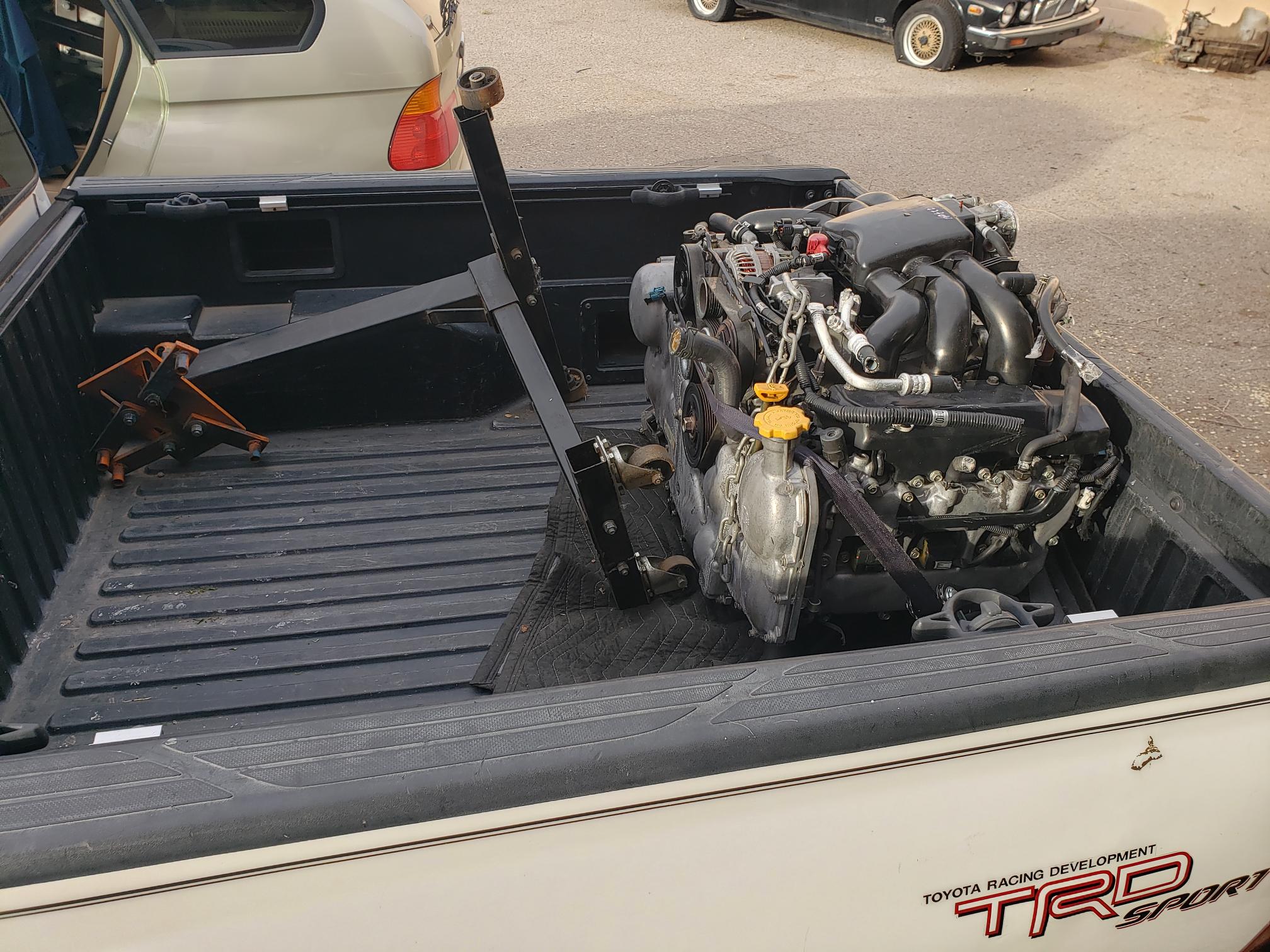

At that point, I got a little delivery (IMG:style_emoticons/default/evilgrin.gif) :
EZ30R, should motivate the car down the road.

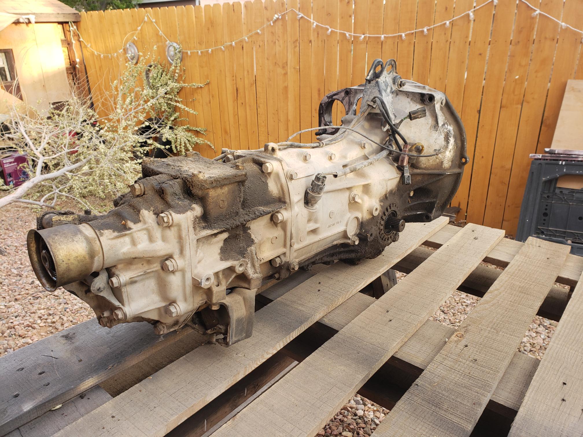

Also, picked up a disgustingly dirty Impreza 5MT locally for $140, with starter, flywheel, engine bolts, and trans mount. Also picked up a nice quality trans end plate locally for $50:
Still waiting on the Subaru Gears rear drive lockout collar, all the way from Down Under.

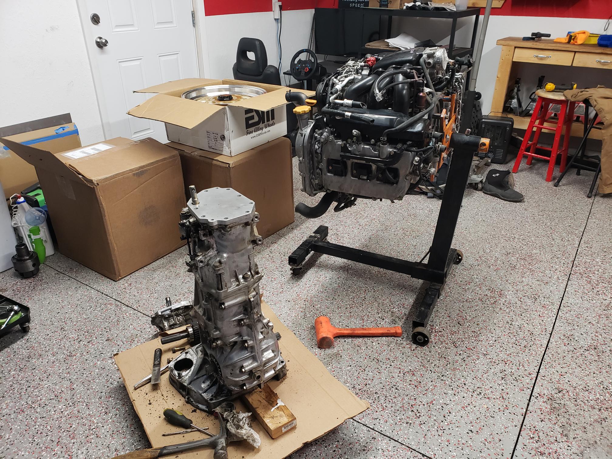

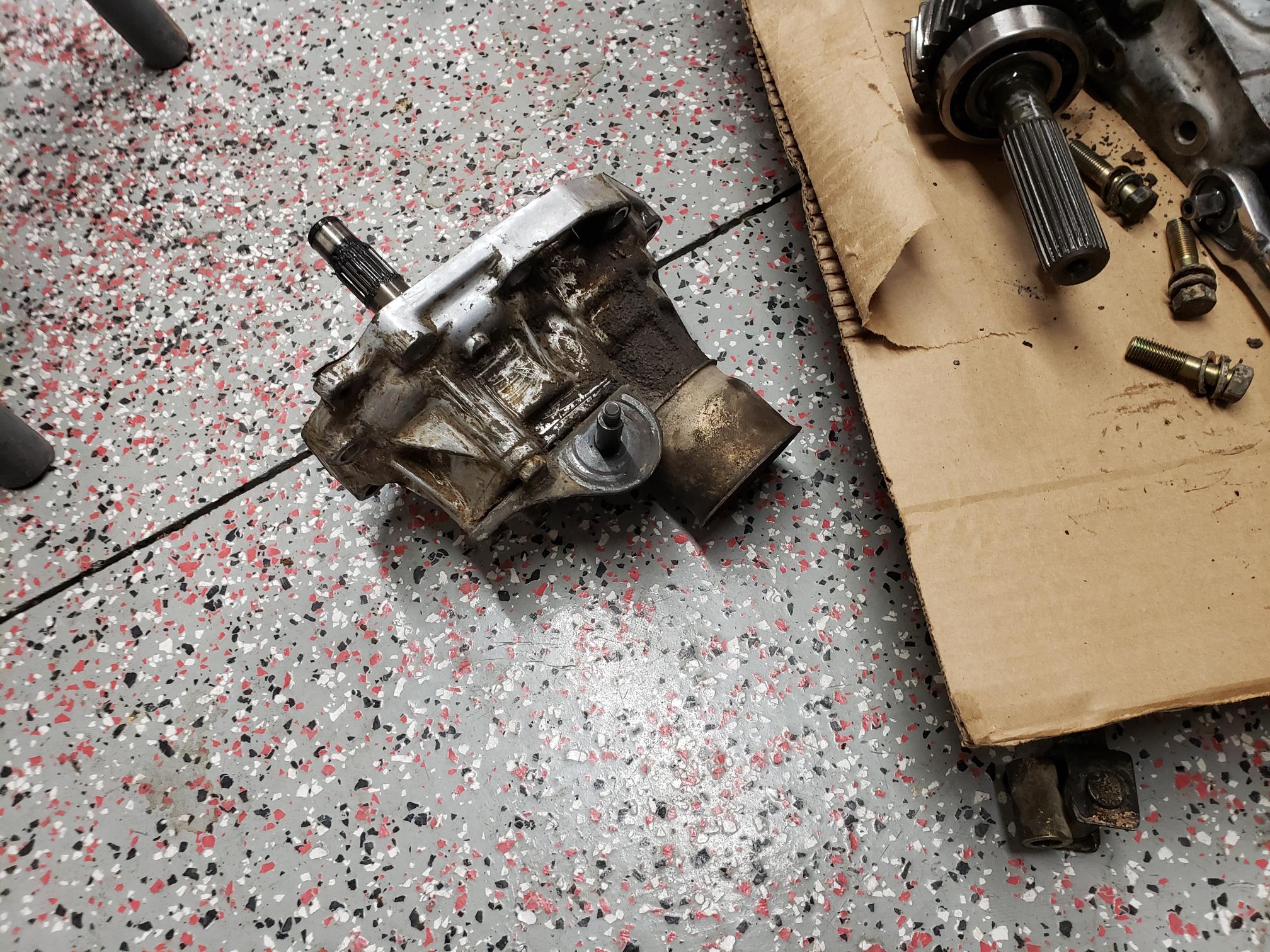

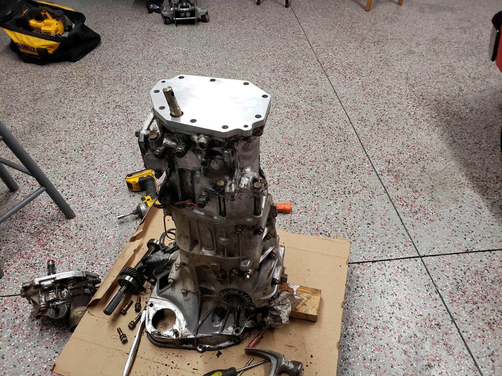

Mayne   Small update here. I had to remove the nut from ...   Jul 28 2022, 04:33 PM
Mayne   I don't know why my photos freak out sometimes...   Jul 28 2022, 04:35 PM
Mayne   I also don't know why my brain freaks out some...   Jul 28 2022, 04:47 PM

Front yard mechanic   That transmission cleaned up real nice ! This ...   Jul 28 2022, 07:52 PM
Mayne   Congratulations, that is a milestone. :beer2: T...   Jul 30 2022, 05:49 AM
