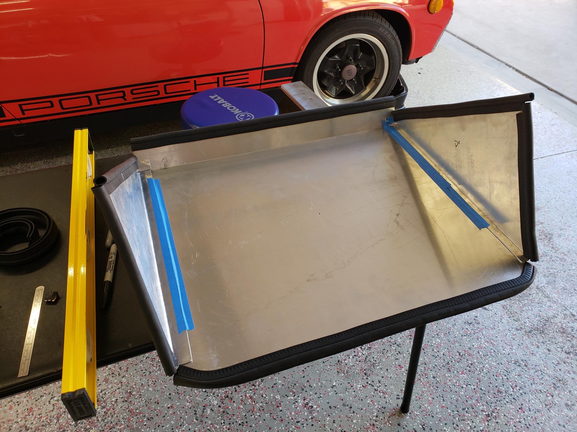

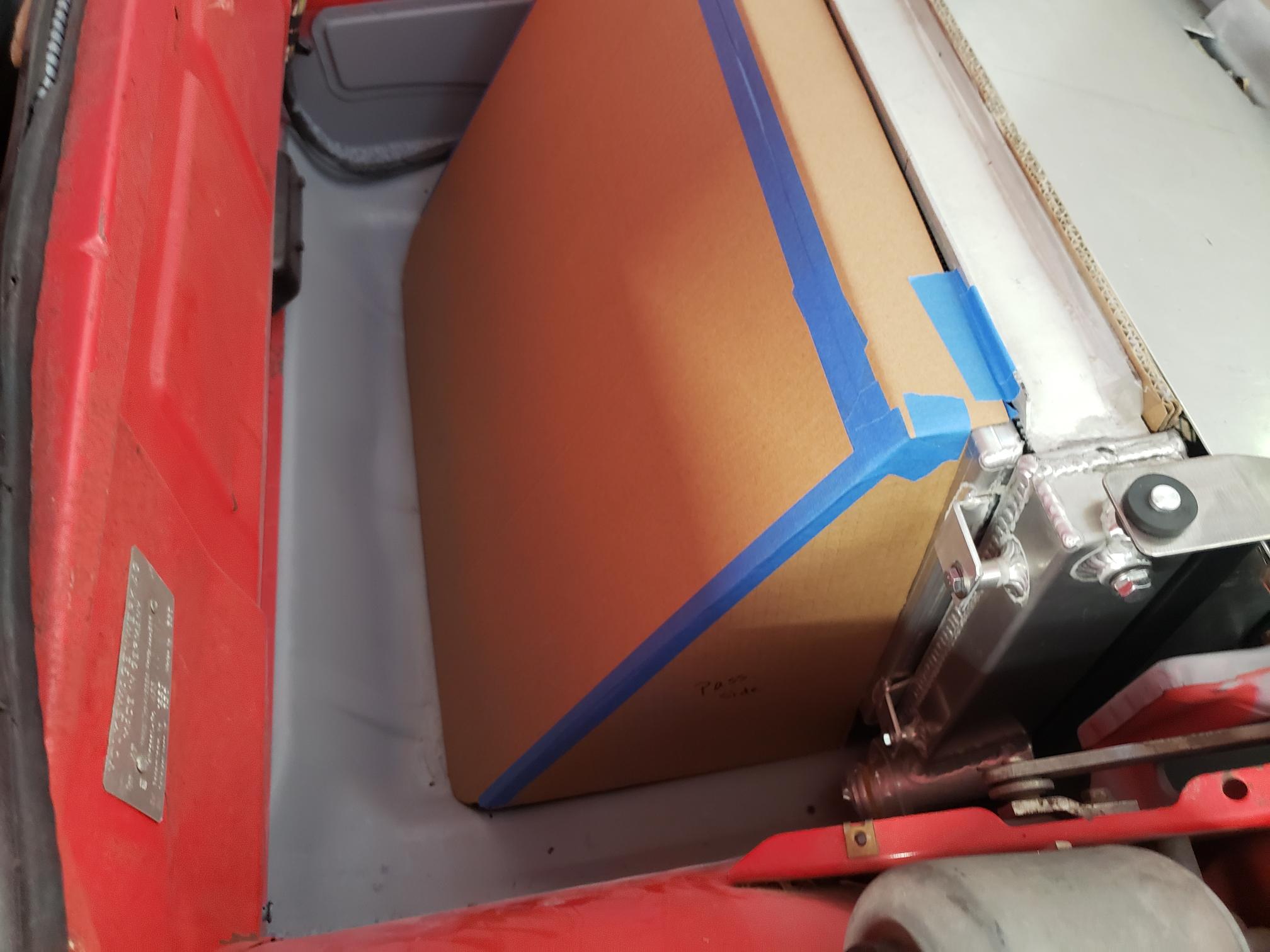

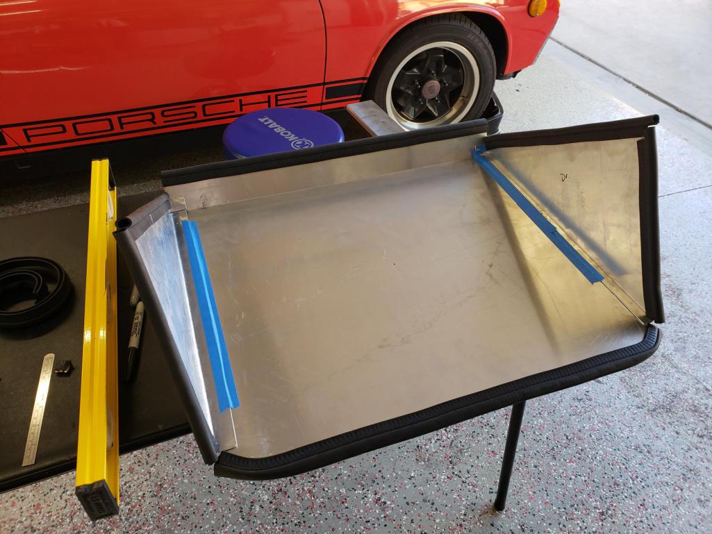

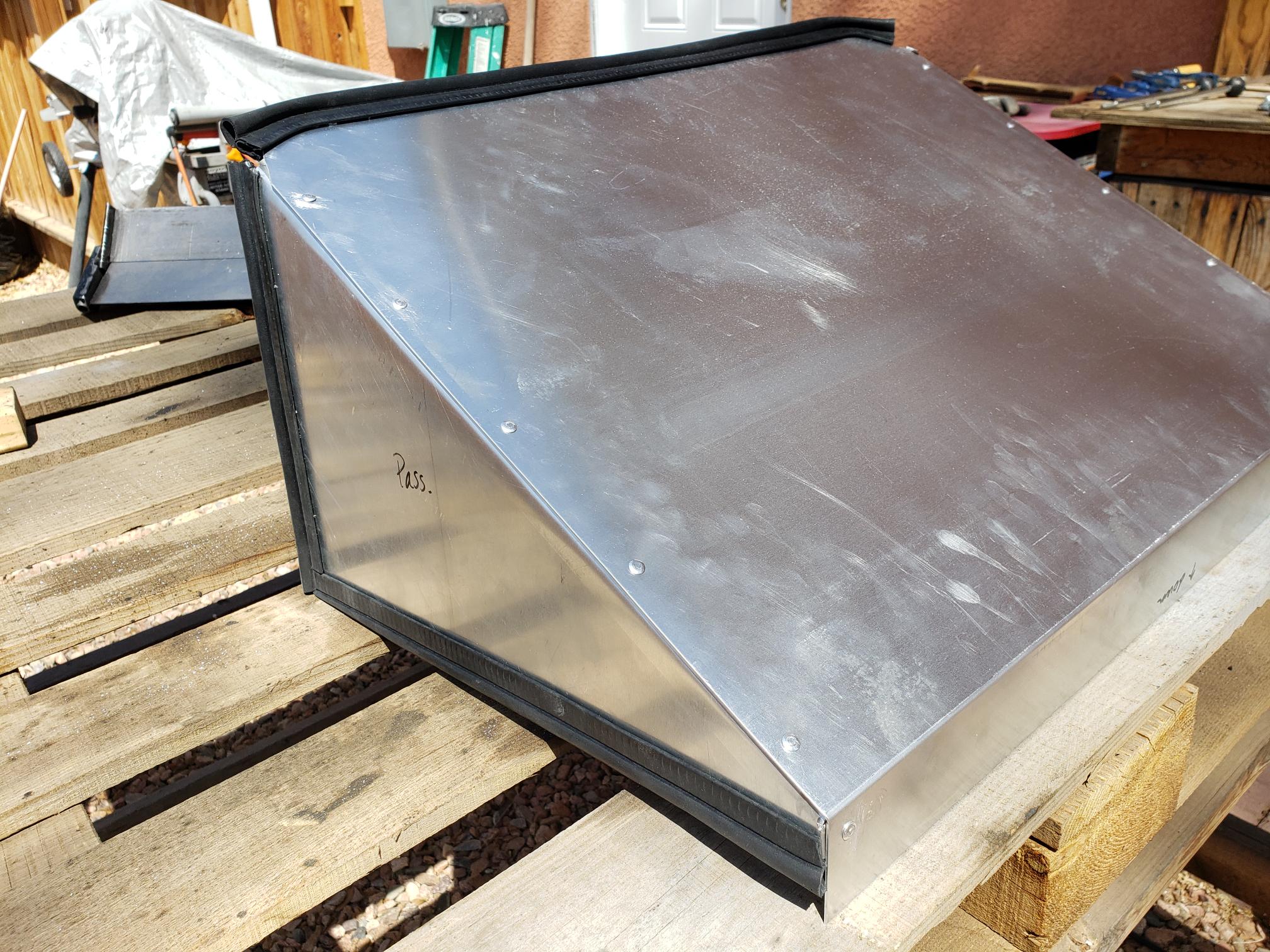

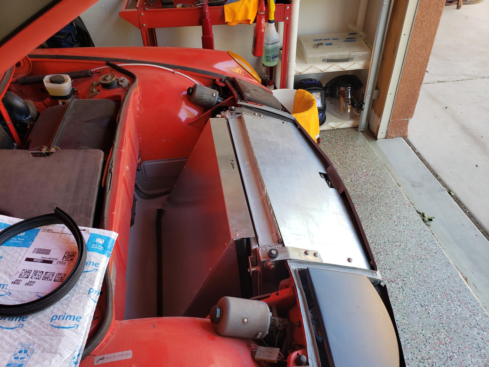

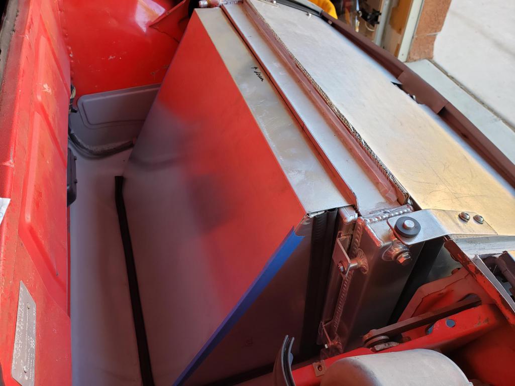

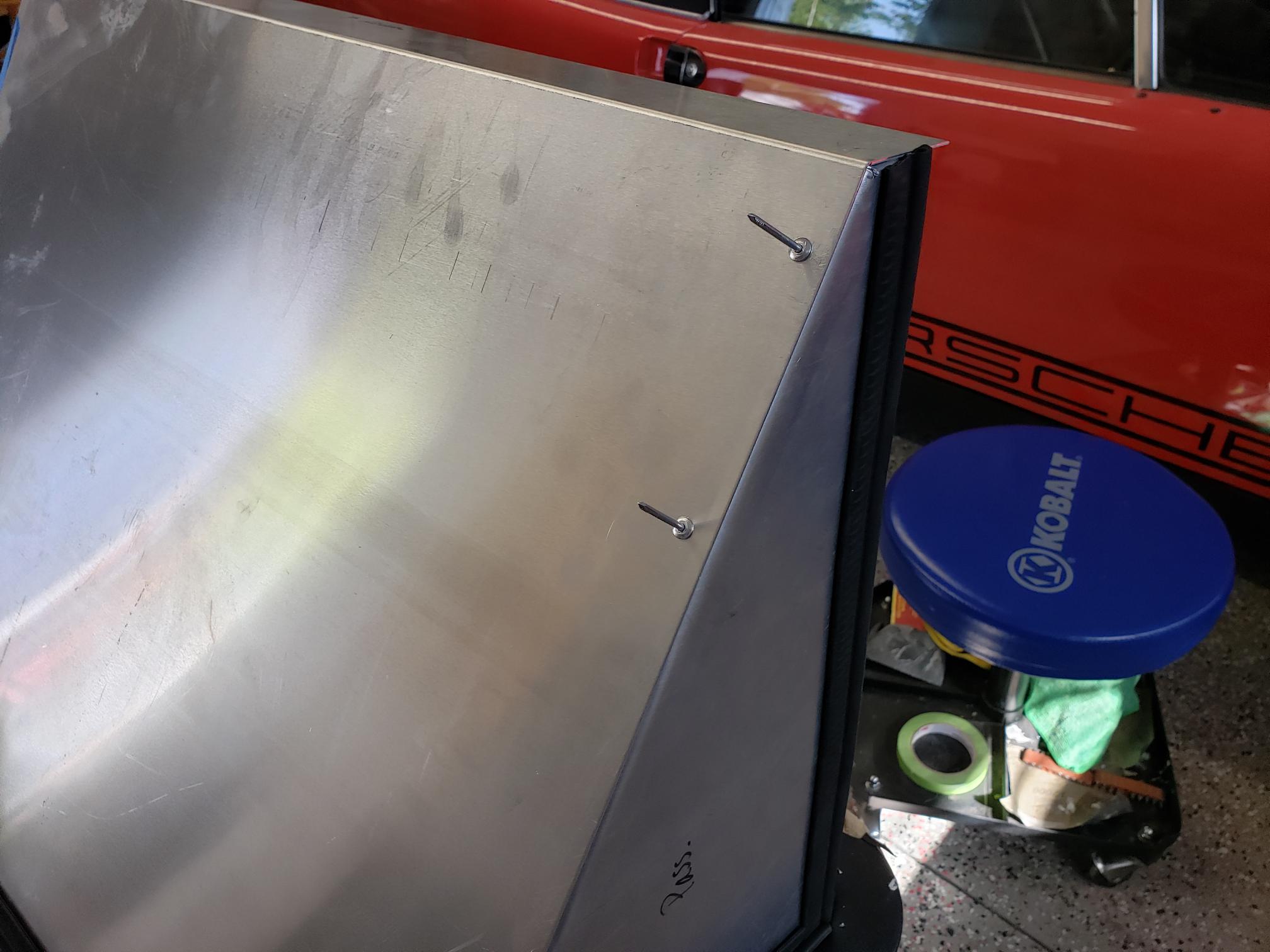

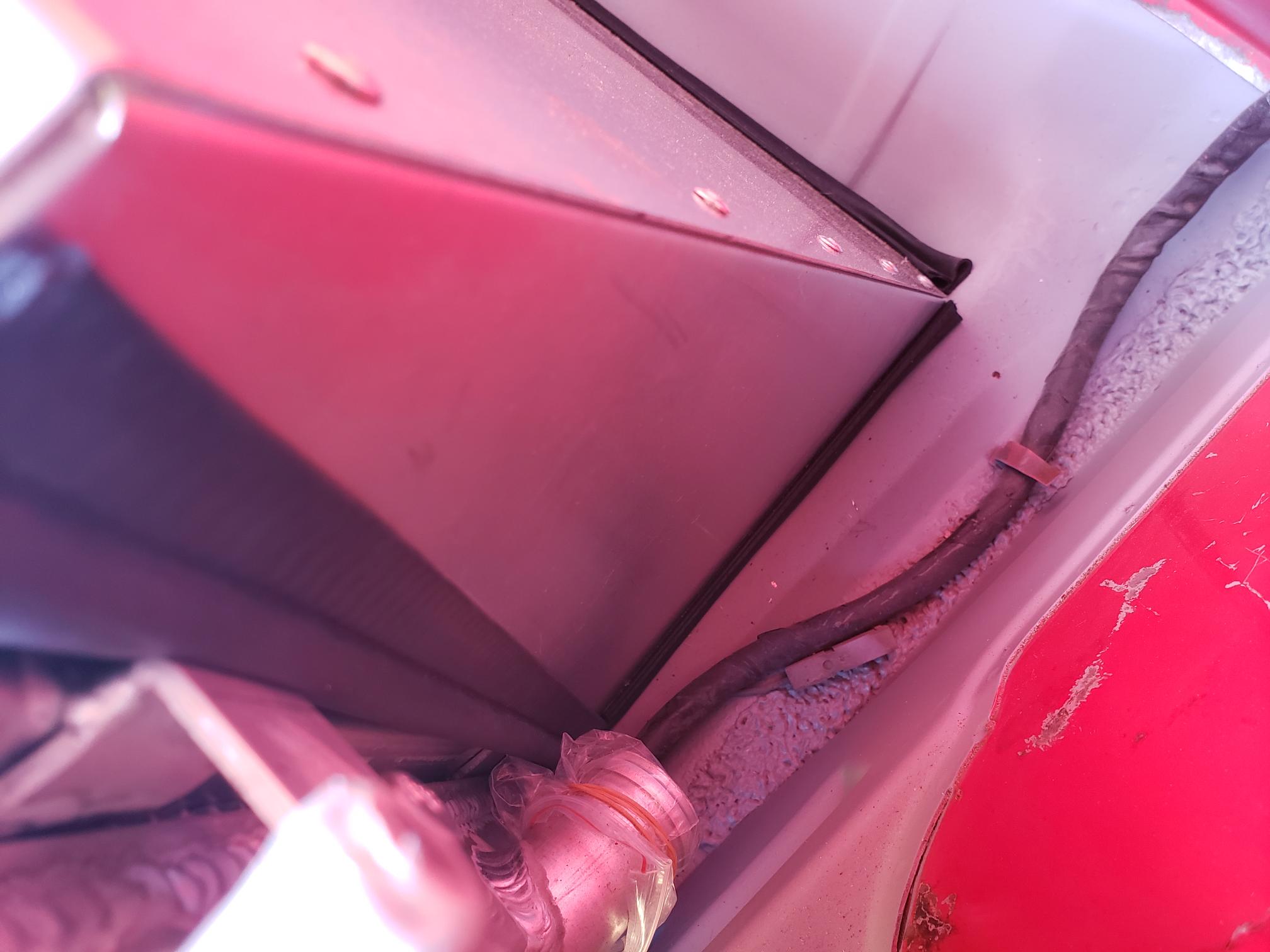

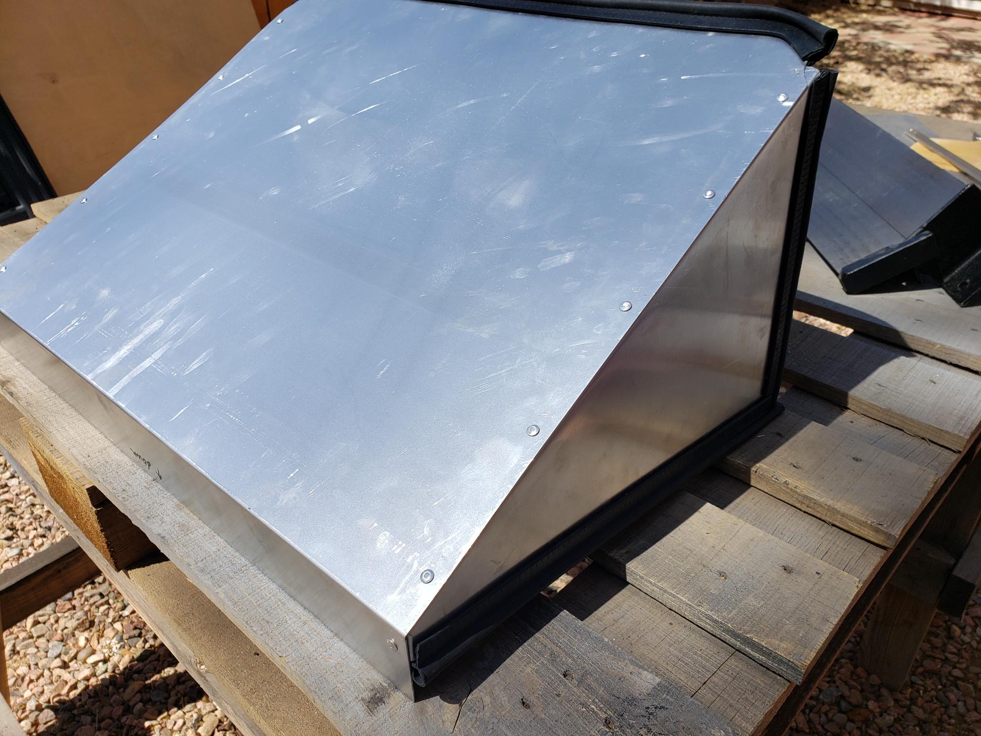

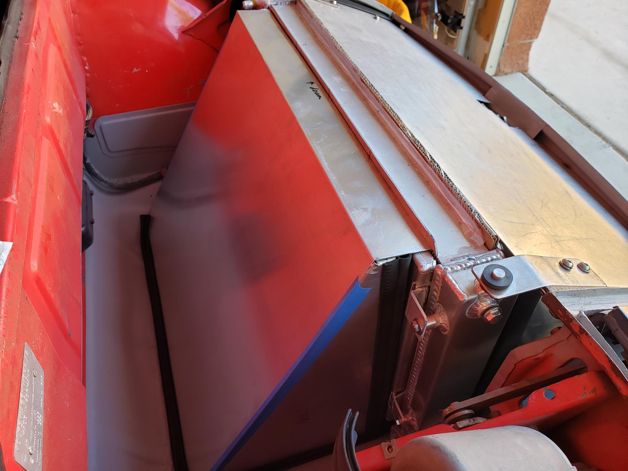

Next up was getting on to the exit side of the radiator.
Template (aluminum sheet is expensive so I don't want to do it twice if possible):
Taped up sheet metal before riveting:
Riveting content:
And in place, but I haven't decided how to mount it yet.
