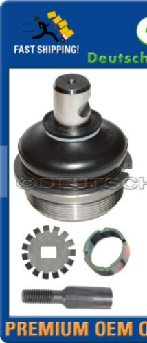

Well, I thought this would go back together simply, not a chance - so I have a few questions. 1. TAB WASHER - does this do anything? If it is intended to do anything, why do I find pictures of this thing UN-LOADED, or the tabs bending downward NOT upward. I installed this with the tabs upward, took some pressure to get the cotter pin into the holes......this seems correct, any thoughts? Also, does it really do anything? Really? (IMG:style_emoticons/default/confused24.gif) ![]() 2. Threaded Pin - I tried to get this thing in and it does not fit. Looking at the picture I bought ball-joints for up to '72! HOWEVER, the ball joints I purchased on the BirdSite are specified to fit on a '74. They do fit. HOWEVER, the Threaded pin does not. To make this MORE interesting, the AutoAtlanta website description details that their theaded pin is for '72 and later......... (IMG:style_emoticons/default/confused24.gif) QUESTION: Do I buy an older theaded pin? Do I grind the marks on the one I have to make it fit? NOTE: there are two marks from where the pin is meeting the curve of the ball joint..... (IMG:style_emoticons/default/blink.gif) ![]() I SHOULD HAVE POWDER COATED EVERYTHING! (IMG:style_emoticons/default/headbang.gif) ![]() Attached image(s)

Thank you for the assistance - YES, I ordered the wrong part - HOWEVER- I am pretty certain that I selected the RIGHT part. Wen through the waterfall selection - Porche -> 74 -> 914 -> 2.0 .....etc,,,,,
It was fulfilled through Rennlist THOUGH the part is packaged by Pelican......yow,,,,, QUESTION - Everything fits perfectly with the exception of the threaded bolt, is there a 70/71 bolt that would fit? is the V the only difference? This seems to be the setup, though the bolt looks like a V and the Ball Joint has a rounded NOT V Shaft............intersting. ![]() |

Shivers Those ball joints may be for the pinch bolts 68-71 May 29 2022, 11:10 AM
914werke The lock plate works by bending the tabs up into t... May 29 2022, 11:14 AM
Literati914 …there are two marks from where the pin is meeti... May 29 2022, 11:23 AM
914werke "The Ball joint is for early
You need the ri... May 29 2022, 01:30 PM
rhodyguy The fastener should not stick out of the strut as ... May 29 2022, 01:48 PM
Literati914
QUESTION - …, is there a 70/71 bolt that wou... May 29 2022, 02:36 PM
QUESTION - …, is there a 70/71 bolt that wo... May 29 2022, 02:59 PM
mepstein If your ball joint has a semi circle it’s early ... May 29 2022, 02:56 PM
Superhawk996 Swap to proper late - wedge ball joints.
Suspens... May 29 2022, 03:08 PM![]() ![]() |
