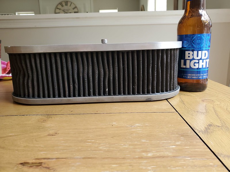

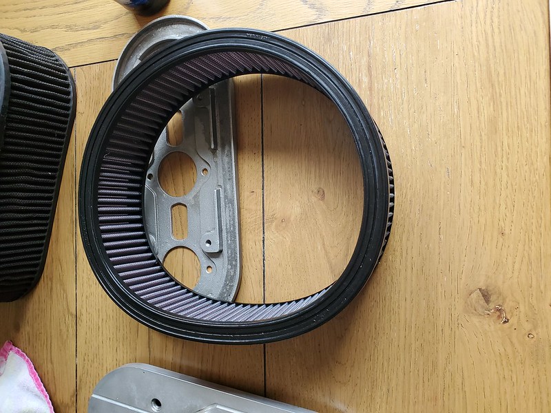

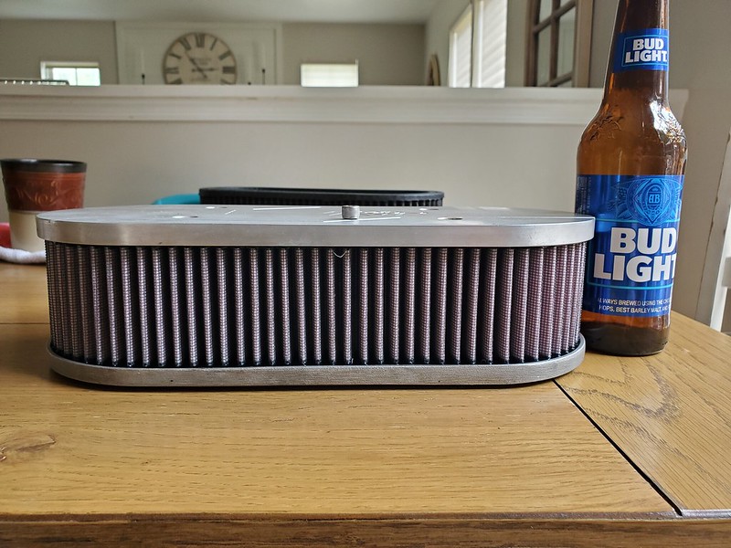

In case anyone ran into the same issue I was having.
The K&N filter kit for dual carbs is:
knn-56-1770-2
It is an oval 3 port setup that works on all 911 applications. Mounts the same in a 6, except you could run into an issue like I did where the plate hits the back edge of the trunk frame (not the actual trunk).
I had a set of filter pods I just acquired in a recent purchase and they are an older kit for the same application, thicker aluminum bases. These were even more of an issue as they sat just a little higher due to them being thicker.
The base oval filter sits 3.25" high (E3761). K&N did manufacturer another same dimension oval filter only 1 inch shorter that would have worked for this application, but those are now discontinued. I hear a couple in UK and Australia. The other problem with that is I would have to use slimmer stacks which requires more money. My stacks are currently the stock 50mm ones. So I could drop $440 on new ones with a snug rub fit on the 123 side OR come in E-1065 81' Camaro round filter. Take a circle and make it an oval. No different than how 40 IDF filters come when you get the kit. A hole half inch gained and still satisfies at least 1 inch above velocity stacks for air flow.
Before
(IMG:http://www.914world.com/bbs2/uploads_offsite/live.staticflickr.com-18763-1654283542.1.jpg)
(IMG:http://www.914world.com/bbs2/uploads_offsite/live.staticflickr.com-18763-1654283544.2.jpg)
After
(IMG:http://www.914world.com/bbs2/uploads_offsite/live.staticflickr.com-18763-1654283544.3.jpg)
