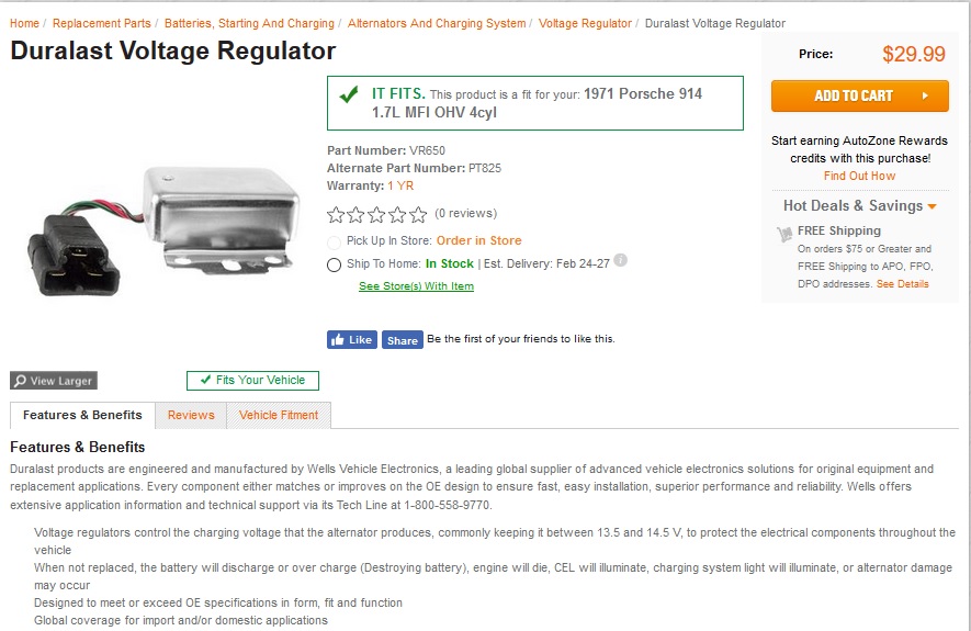

I picked up this one locally from Autozone. Works fine.

QUOTE(Spoke @ Feb 19 2017, 10:25 AM) *
This is what I am using as well.
