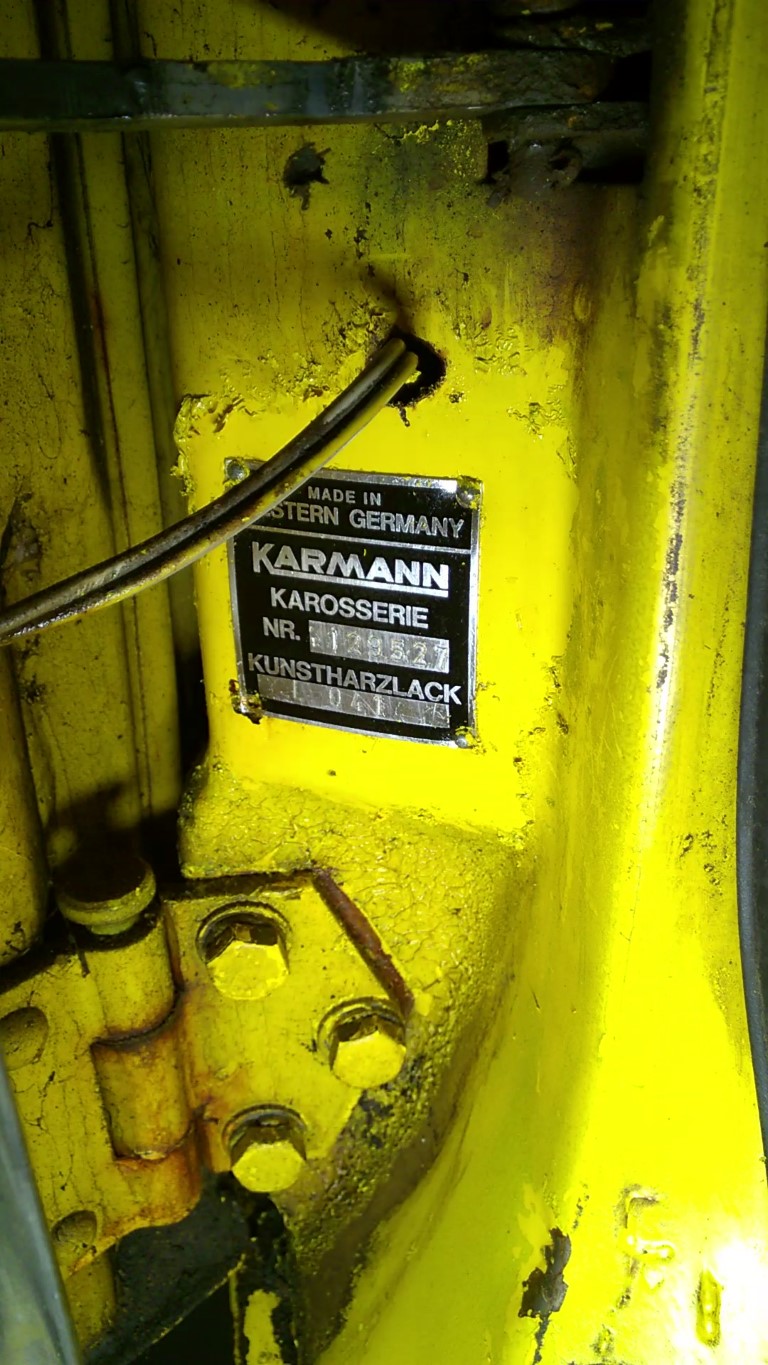

Hi.
A former 914 owners assoc. member I am new to this forum but not to the car. About the Karmann paint code and colour match My 914 has been sleeping for some years as the forces of inertia and other priorities have been in control . BUT having seized the day and just for the fun of it, I and am playing with resto work again this summer . I searched for this thread while catching up with my documentation and past notes and see that my car appears to have a similar code problem. Please see pic of the plate pop riveted on by coach builder Karmann back in the day's of a divided Germany. The car had been banged about some and had a cheap non matching respray before I bought it in the mid 1980s and I peeled that back recently to reveal L041 on the left side plate, which I understand is a code # for Black? The car is a strong Sunflower type of yellow every where you can look .Perhaps truly code L13K? Anyway, is it just a Monday on the line paint/plate mix up? .Could we ask a retired East German judge for a fair ruling on this? (IMG:style_emoticons/default/smash.gif) Attached Image

davep   Not sure what to say Ken. Can you read the Karmann...   Jul 9 2022, 09:50 PM
