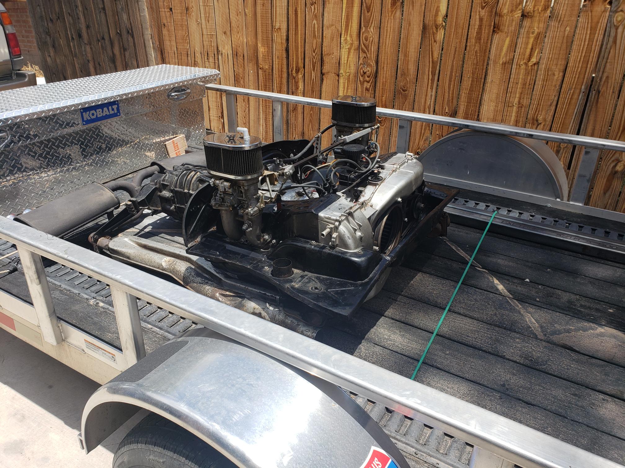

Motor back in, along with a dual Weber setup we came across, it seemed like the leak was fixed. But it was running so badly, we couldn't really drive it. Since my brother was working part time at a Ferrari shop that primarily builds vintage motors, we were able to get the carbs rebuilt for cheap by the excellent Ferrari mechanic.
(IMG:http://www.914world.com/bbs2/uploads_offsite/i1322.photobucket.com-20880-1490063978.5.jpg)

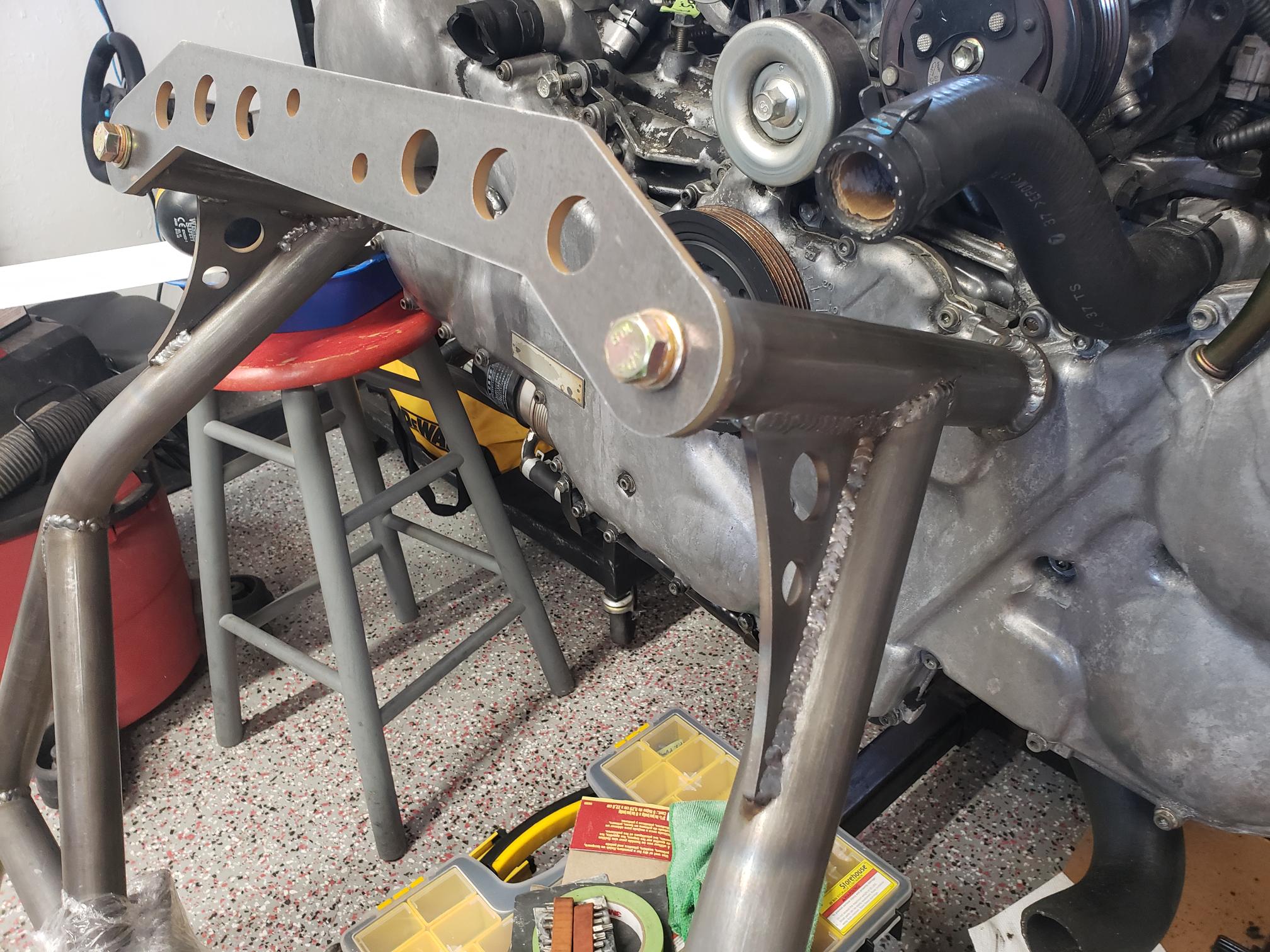

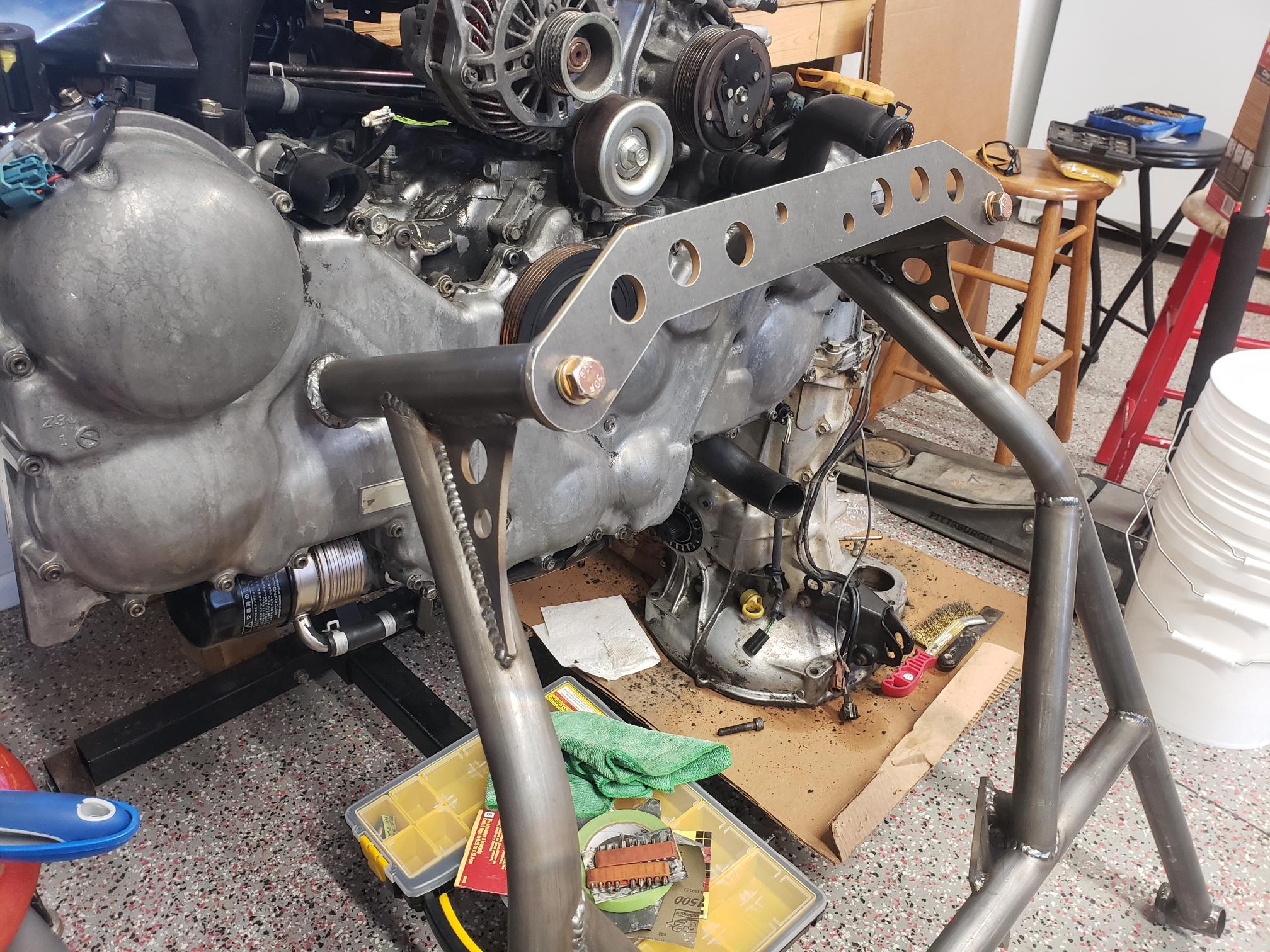

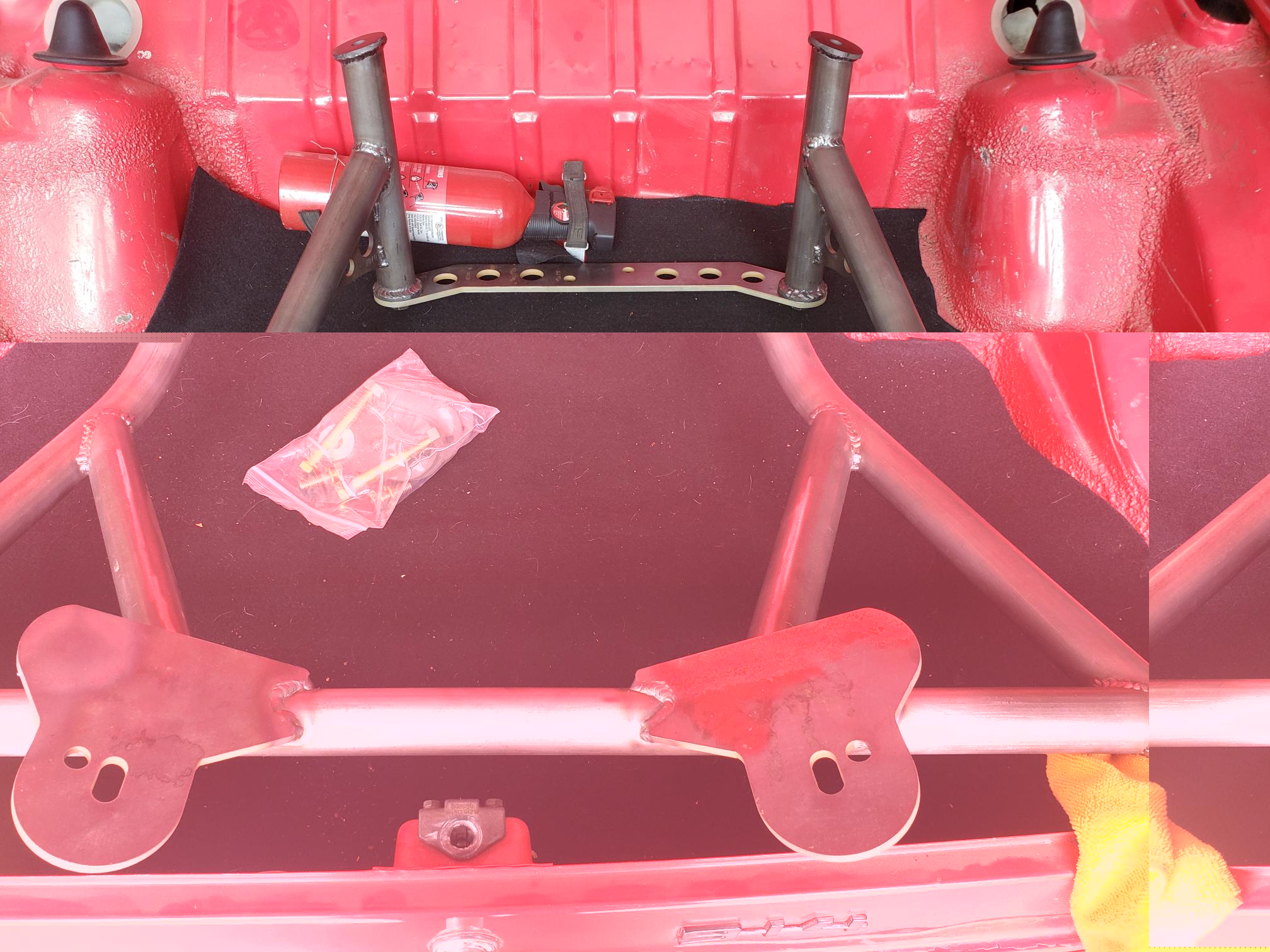

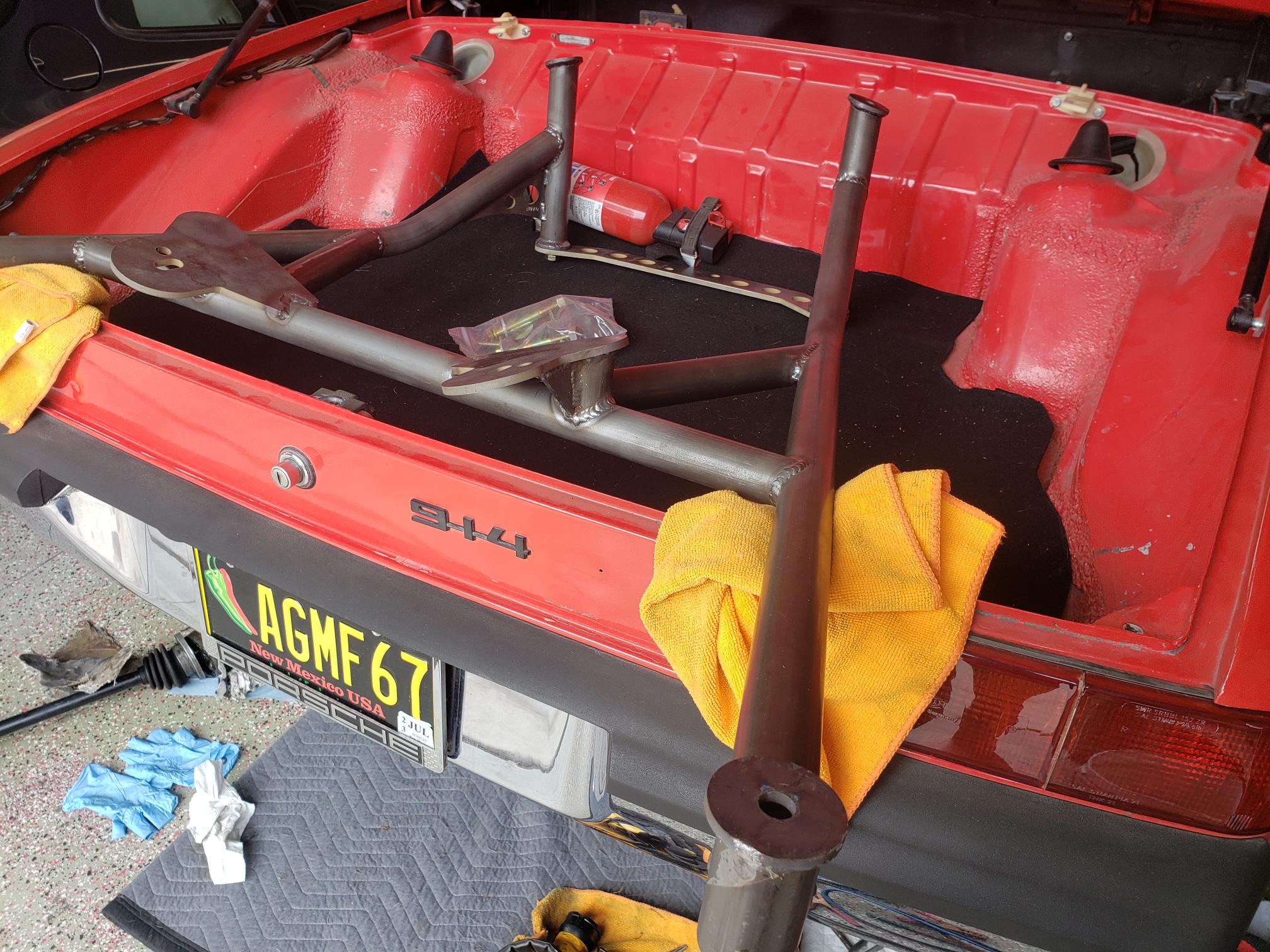

Slow but steady progress still being made here. I got my cradle from JWK Engineering and it looks to be a well made and solid piece. It includes the mount bracket for the Subaru transmission and new mounting hardware.

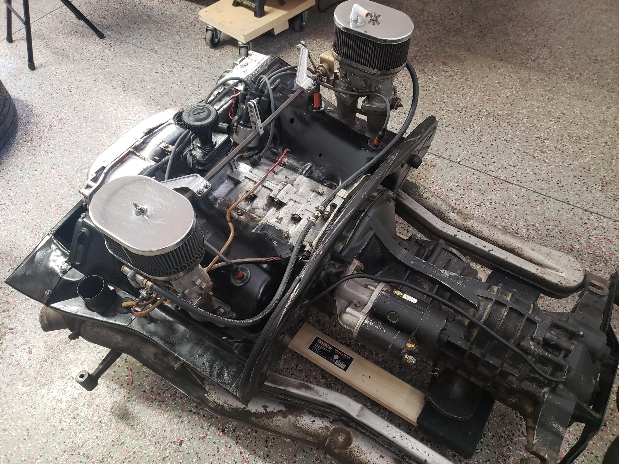

So that got me motivated to remove the Type IV engine and gearbox. Sold the entire drivetrain locally and gained some mad money to buy more parts.

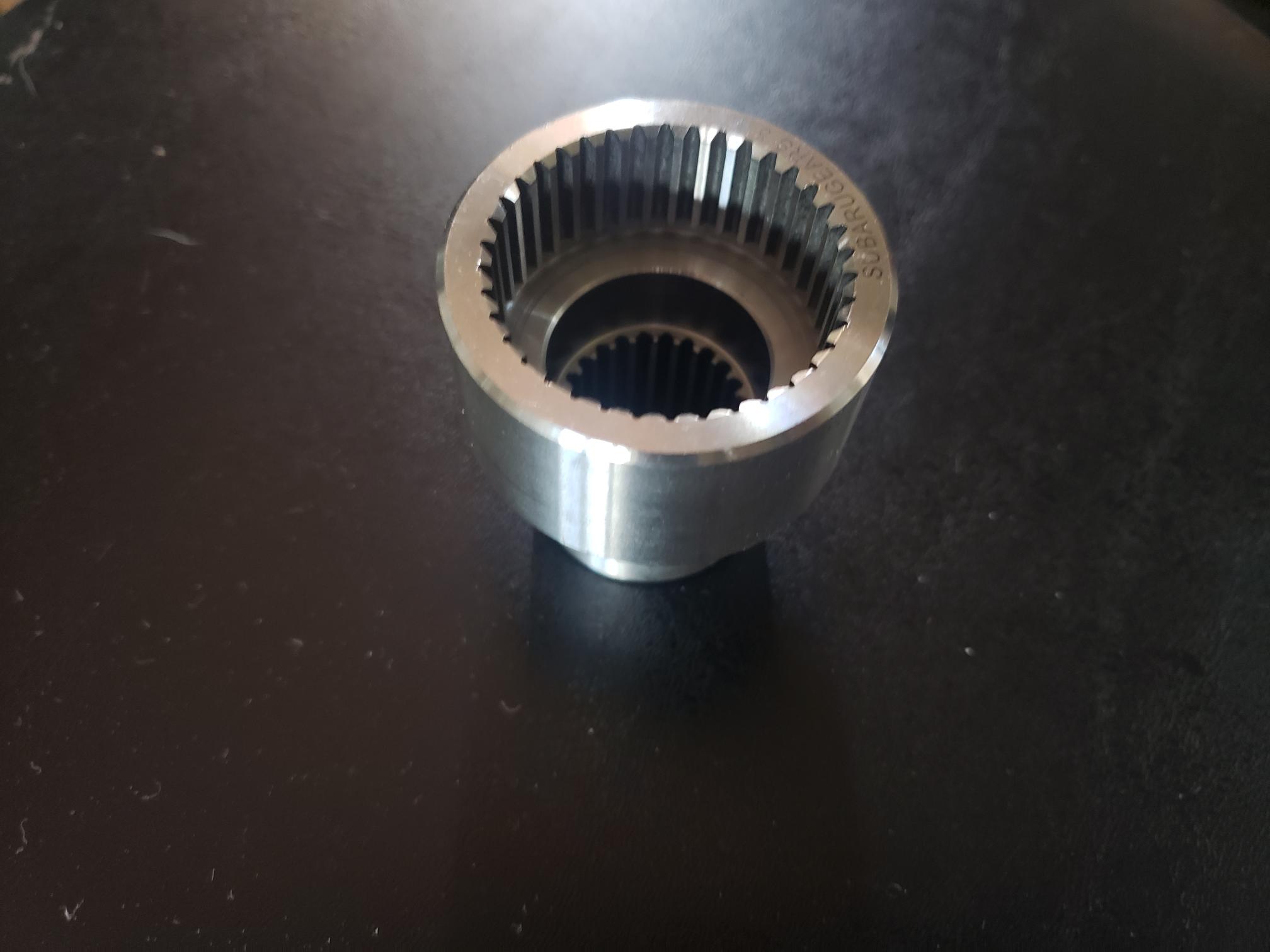

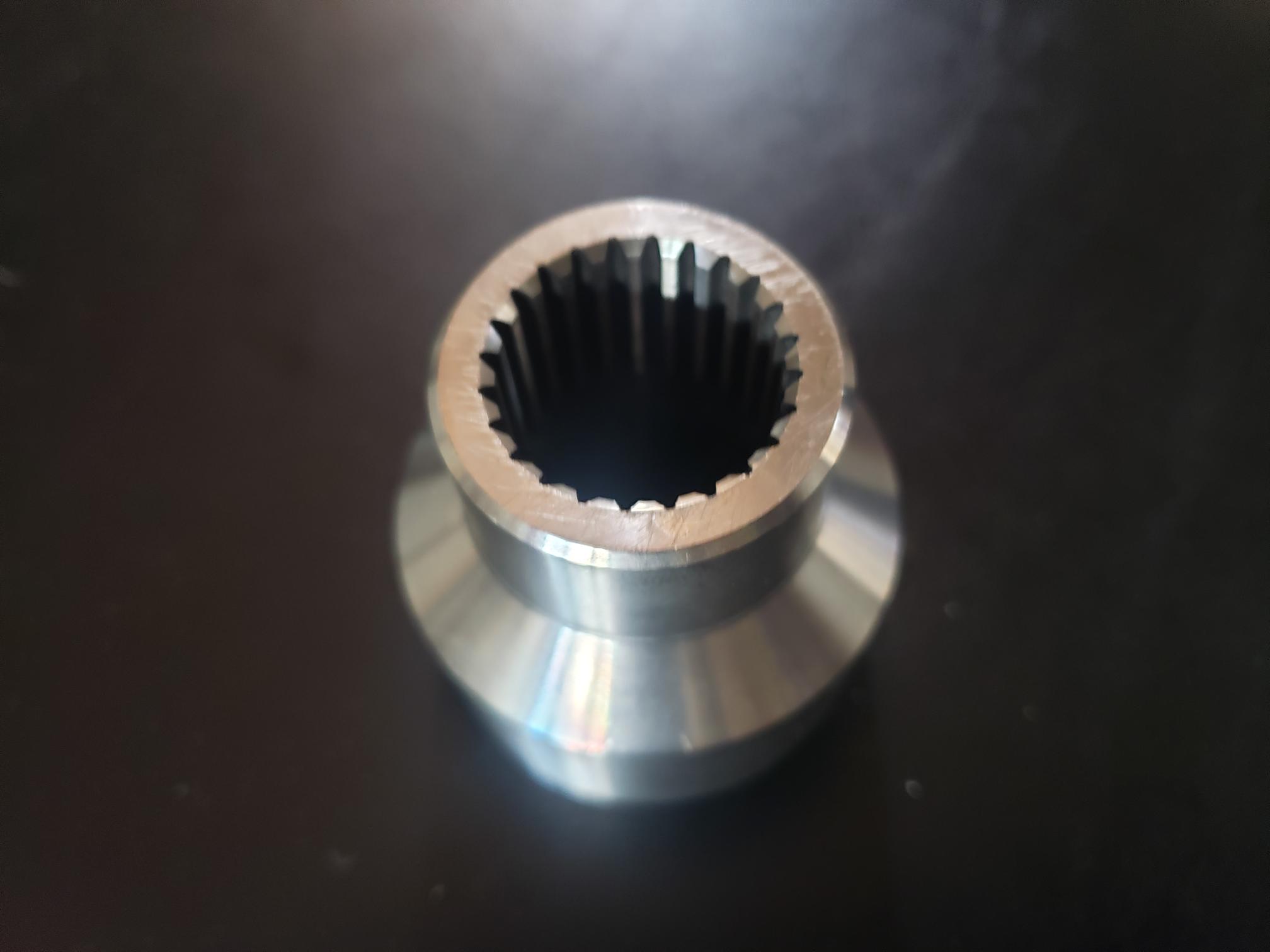

Also got my rear dif lockout from Subaru Gears; a beautiful piece, I think.

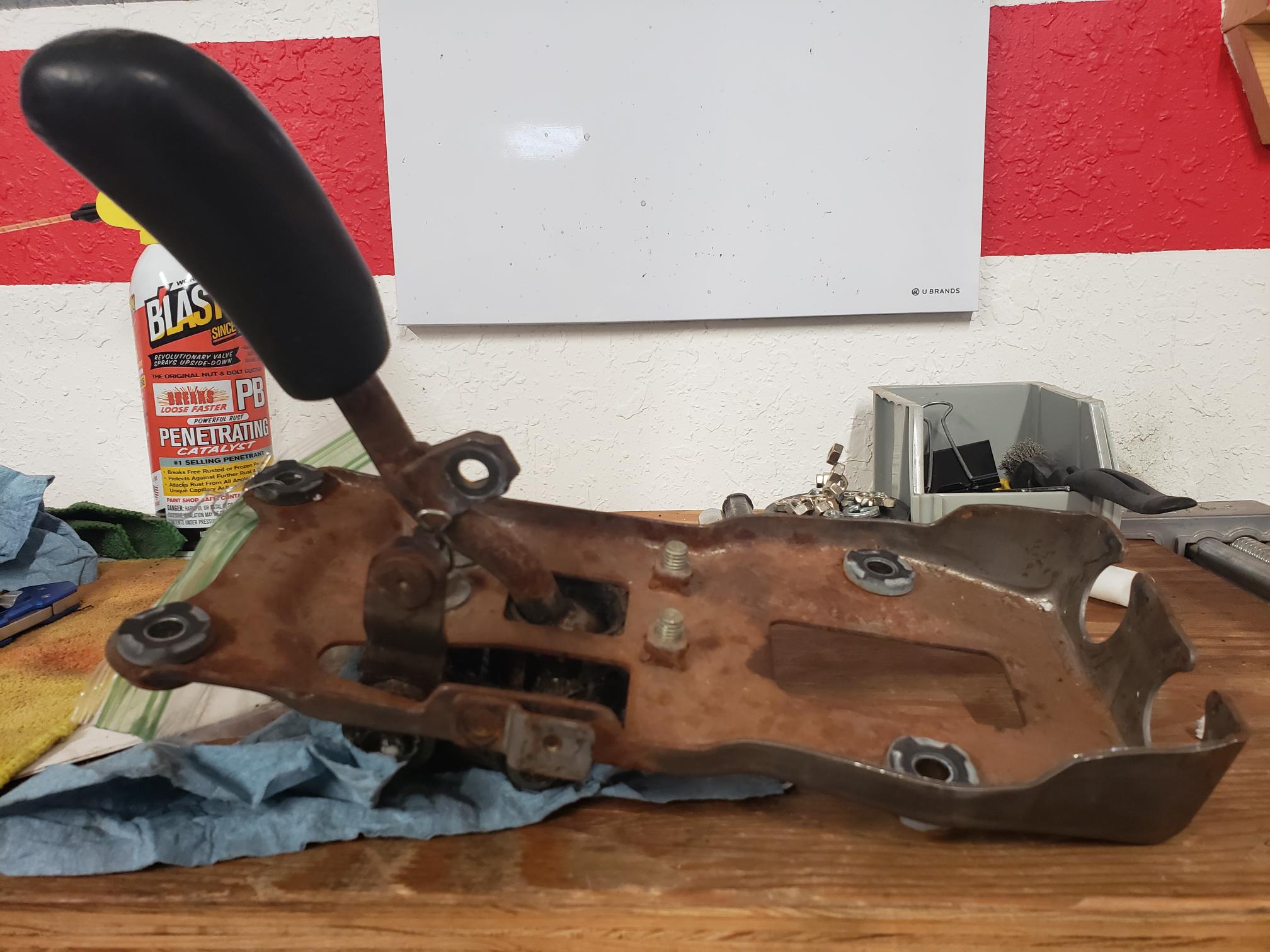

I'll be using an MR2 shifter, so I picked one up on eBay for what seems to me like too much money. But there ya go... And yes, they're all rusty looking, but i have some plans for that.
