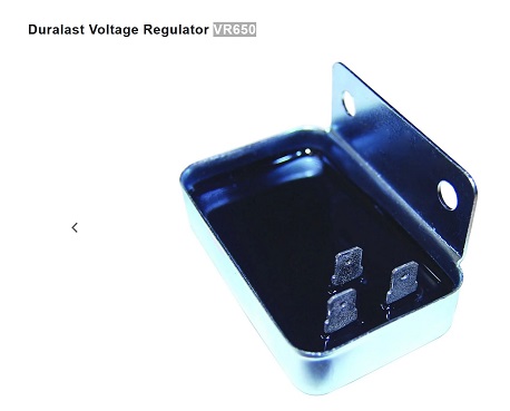

Help. I have gotten three voltage regulators from the normal Porsche Parts suppliers and none fit. The distance from edge of case to the first spade is .25 inches on my original regulator. The catalogs all show same regulator for 911, 914, and 914-6. The ones I have received vary from .4 from the edge to .65 from the edge all with same PN so will not fit in area to plug into. Anyone know the actual part to buy? My original has numbers on it in this order 0 190 601 006 AD 1/14V. The replacements show up as PN 901 603 206 02 Yes I can rewire, or maybe take both apart and move the guts, but trying to keep original and not have a wire harness to convert to get wires to new regulator. Thank you for your help. TimAttached Image

I know this is kind of an old thread, but hoping someone using the Duralast VR can clear my confusion. The part pictured in posts above does not look like it would fit the 914 relay board, but the product description on the autozone page also shows pics of this part which looks to be plug and play. Can anyone clarify which one you get when ordered? @Spoke @VaccaRabite

Spoke   I picked up this one locally from Autozone. Works ...   Feb 19 2017, 08:25 AM
VaccaRabite   I picked up this one locally from Autozone. Works...   Jun 14 2022, 12:27 PM
fixer34   I picked up this one locally from Autozone. Work...   Jul 13 2022, 09:26 PM
bbrock   Interesting; my local Autozone wants $37.99 ...   Jul 13 2022, 09:40 PM
stoneman30hotmail   [quote name='fixer34' post='3015104' date='Jul 13...   Sep 22 2023, 04:02 PM
Spoke   Now there's 14V at the battery. So maybe that...   Sep 22 2023, 05:40 PM

windforfun   Make sure it doesn't provide more than about 1...   Jul 13 2022, 04:27 PM
bbrock   Make sure it doesn't provide more than about ...   Jul 13 2022, 04:40 PM
windforfun   Make sure it doesn't provide more than about...   Jul 13 2022, 04:59 PM
Spoke   Here's the one I bought. It has wires and a co...   Jul 13 2022, 06:23 PM
windforfun   Here's the one I bought. It has wires and a c...   Jul 13 2022, 06:36 PM
bbrock   Ah. That makes sense. Thanks!   Jul 13 2022, 07:01 PM
