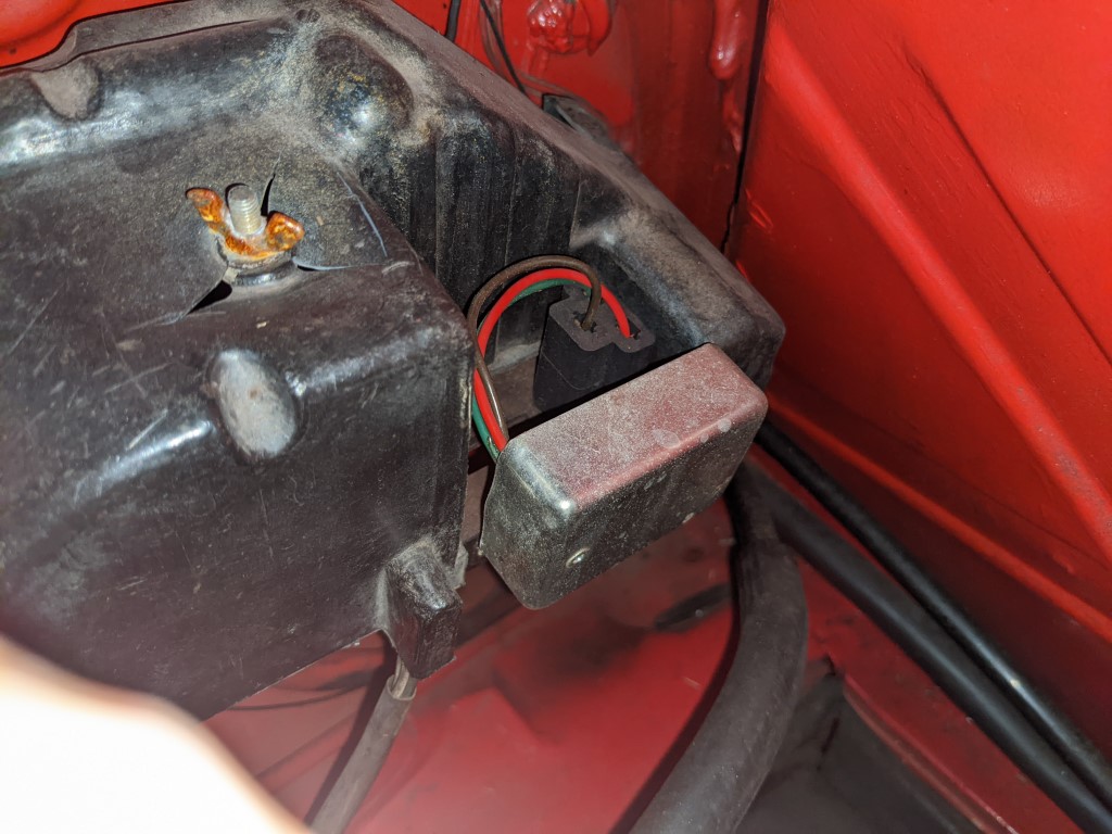

Here's the one I bought. It has wires and a connector but it looks like there would be space for the VR to attach directly to the connector on the relay board.
My VR provides just about 14V. The new alternator on my 930 provides about 14V as well. I think this is a safe voltage to operate at.

QUOTE(Spoke @ Jul 13 2022, 05:23 PM) *
(IMG:style_emoticons/default/agree.gif) (IMG:style_emoticons/default/agree.gif) (IMG:style_emoticons/default/agree.gif)

Spoke   Here's the one I bought. It has wires and a co...   Jul 13 2022, 06:23 PM
windforfun   Here's the one I bought. It has wires and a c...   Jul 13 2022, 06:36 PM
bbrock   Ah. That makes sense. Thanks!   Jul 13 2022, 07:01 PM
