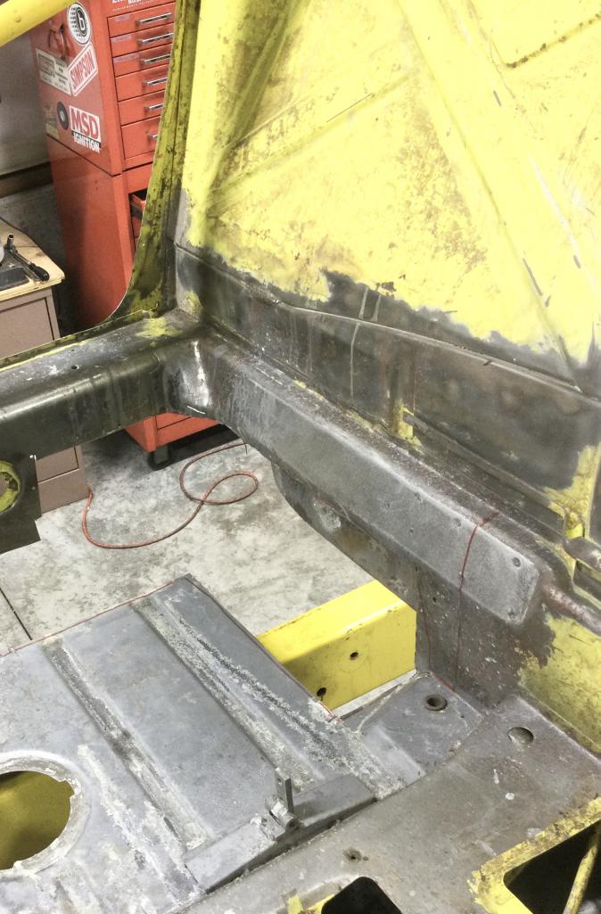

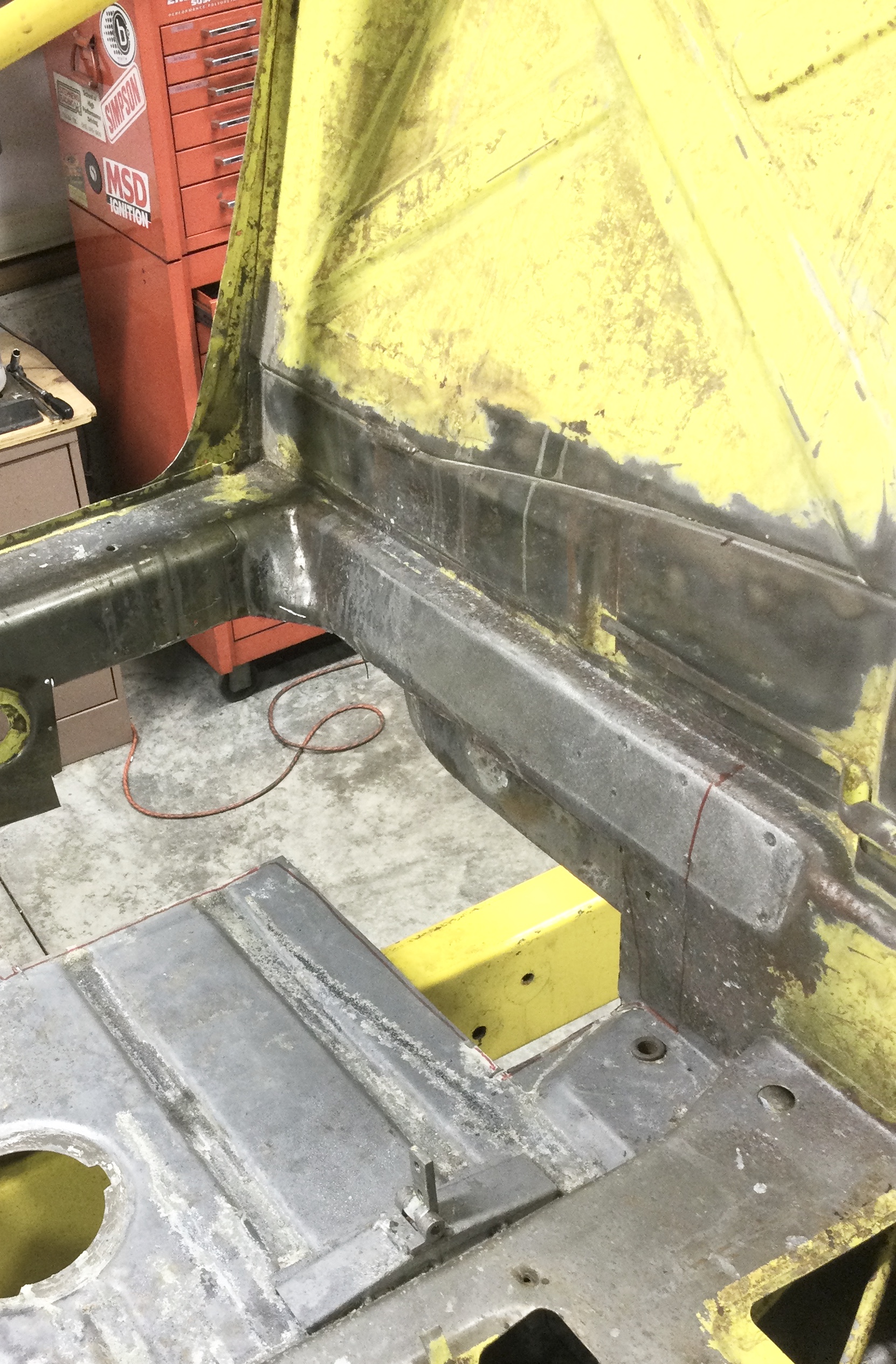

Well, after getting sidetracked by work and other projects for a while,,,,,,I finally got a chance to work on my tub a little today.
I chopped out a bad section of the pass rear floor and started trimming a patch panel from a replacement section.
