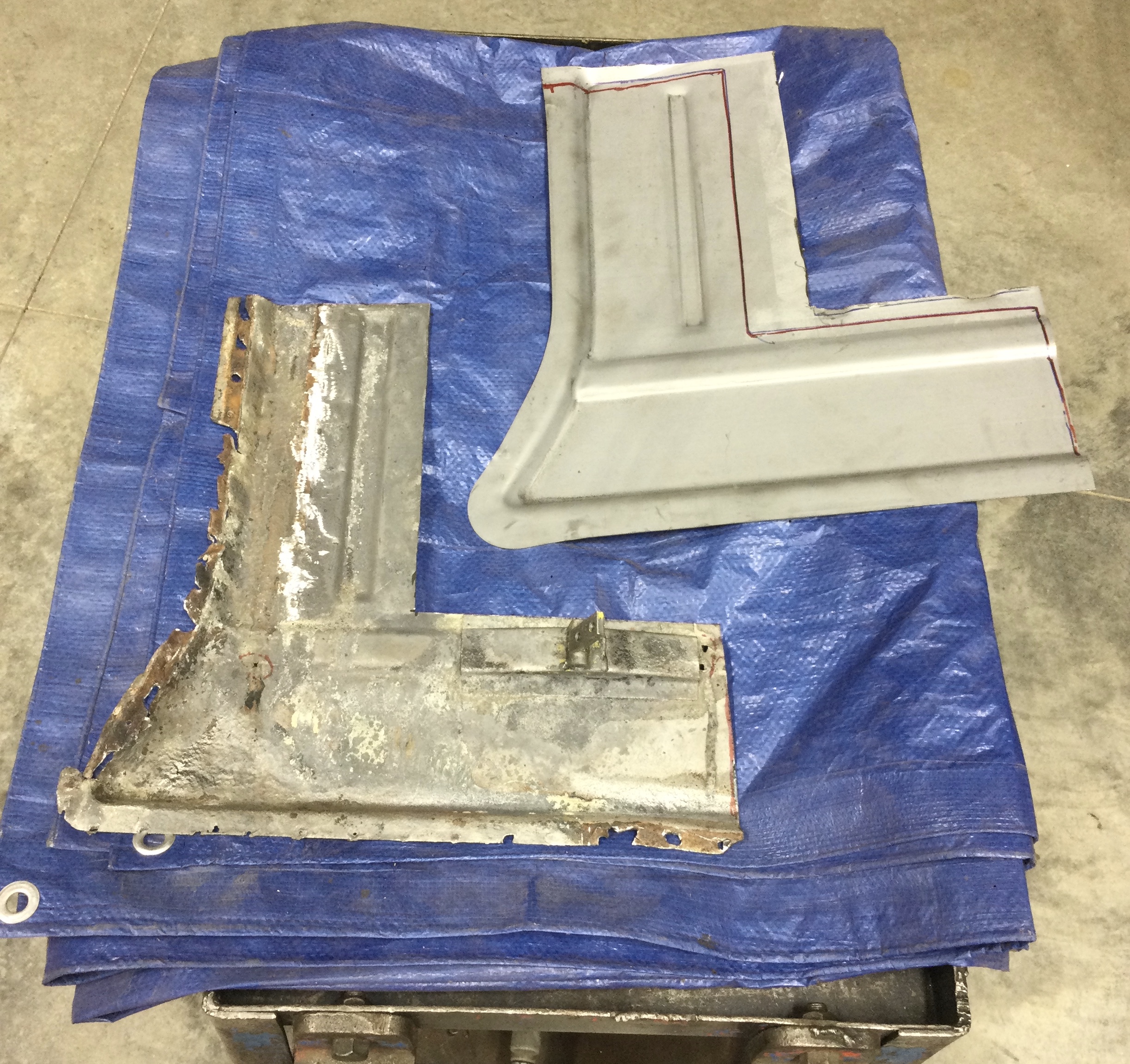

Alain V.   Uh oh, suspension console is toast.   Jan 2 2022, 04:27 PM
Alain V.   Made a simple jig to locate the hole for the contr...   Jan 2 2022, 04:28 PM
Alain V.   Removed old console piece   Jan 2 2022, 04:30 PM
Alain V.   Need to make a small patch for the skin behind the...   Jan 2 2022, 04:31 PM

Alain V.   Test fitting new piece   Jan 2 2022, 04:37 PM
