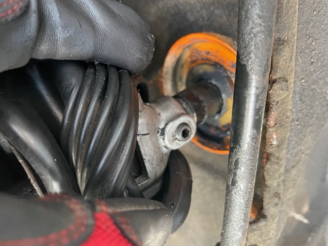

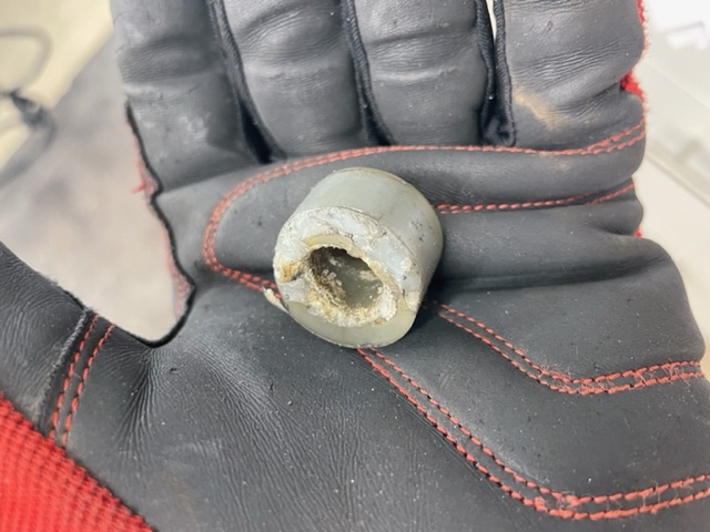

Pulled the boot cover back at firewall and this fell out. What is it and where should it go?
And what are these "cone screws" you guys are referencing? Thanks guys!

Dave_Darling   And what are these "cone screws" you gu...   Jul 21 2022, 03:50 PM
Rick986   And what are these "cone screws" you g...   Jul 22 2022, 07:07 AM
DRPHIL914   [quote name='Rick986' post='3016978' date='Jul 2...   Jul 22 2022, 07:21 AM

DRPHIL914   here are a few links https://www.rix914parts.com/...   Jul 22 2022, 07:27 AM
ndfrigi   Been noticing a challenge getting it into 4th for...   Jul 22 2022, 08:04 AM
DRPHIL914   Been noticing a challenge getting it into 4th fo...   Jul 22 2022, 08:41 AM
dr914@autoatlanta.com   yup new delrin coupler bushings should fix you rig...   Jul 22 2022, 10:44 AM
Rick986   It's been said before, but I must say it again...   Jul 28 2022, 10:44 AM
StarBear   So, what was the final issue and solution?   Jul 28 2022, 01:35 PM
Rick986   So, what was the final issue and solution? The ...   Jul 29 2022, 11:31 AM
