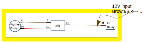

Right after ordering a complete Car Magic kit to convert my windshield washer to electric, I read Sir Andy's excellent tech article on the conversion. The idea of pulling power for the washer pump off the intermittent wiper feed so the washer is activated by pulling back on the wiper lever was too elegant not to try.
I happened to have this nifty vintage VW style splitter I bought some time ago for not other reason than I thought it might come in handy for some future custom wiring project. It was just the ticket for splitting off of my intermittent washer relay to power the washer pump.
After hooking everything up, I pulled back on the wiper lever and HUZZAH! The washers squirted and the wipers ran for two sweeps and parked. Pretty slick! I couldn't understand how the intermittent wipers would work when the lever was pulled down to turn the intermittent wipers on. I pull down on the lever to test them and nothing. As soon as I unplug the washer pump, the intermittent wipers start running. I'm not sure how the intermittent relay works, but thinking the timer is from charging a capacitor which then "bump starts" the wipers to run a single cycle.
Is there is a reasonably simple way to isolate the pump so it allows the intermittent mechanism to run without activating the washer pump? Could be a fun project. Or should I just go back to the original plan of installing the Car Magic switch? I just like the idea of minimizing the wiring.

Ok now I think I understand your idea better. I'm used to thinking input is on the left side.
So this is what you meant?
So when you pull the stalk, you trigger the intermittent 12v input (S) to the relay.
Simultaneously the the wiper pump is on as long as 12v is present. Then when the black/brown returns to ground the pump stops, the wiper pump is decoupled, and the intermittent stays active. (IMG:style_emoticons/default/idea.gif)
Will be interesting to see if it indeed works.
But by the time you have to put that little gizmo in there I'm thinking we're back to an Arduino (in effect) (IMG:style_emoticons/default/poke.gif) (IMG:style_emoticons/default/laugh.gif)
But if it works as you propose . . . . we'll all owe you a beer
