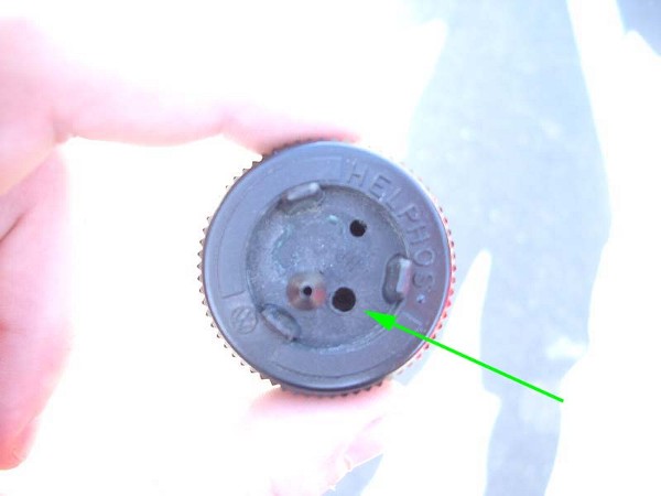

7) take off the black bottle cap and drill a small hole into it, next to the valve stem (hole size about the dia. of the washer hose). this is needed because the cap has a pressure valve in it that won't allow air to get into the bottle. you need to bypass this, otherwise the pump will not be able to get much water out of the bottle.

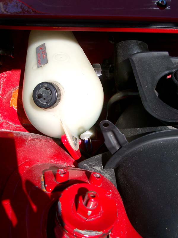

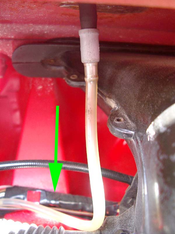

First, the completed assembly

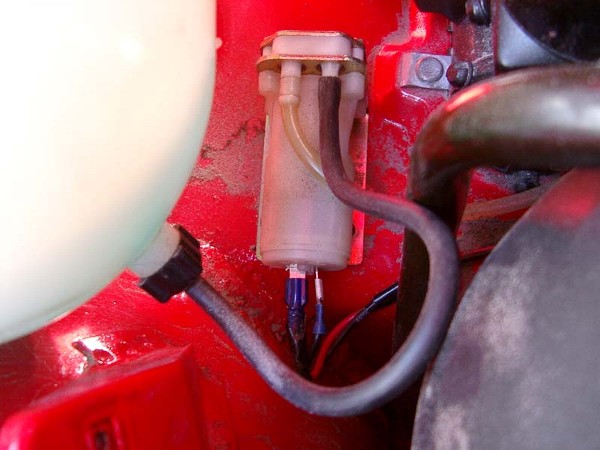

Next, the pump. This is the stock 914/6 location (more or less), black hose is intake from bottle, transparent hose is outlet to the nozzles
Next, the cap with the additional hole for breathing

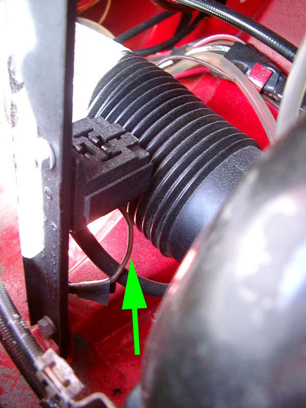

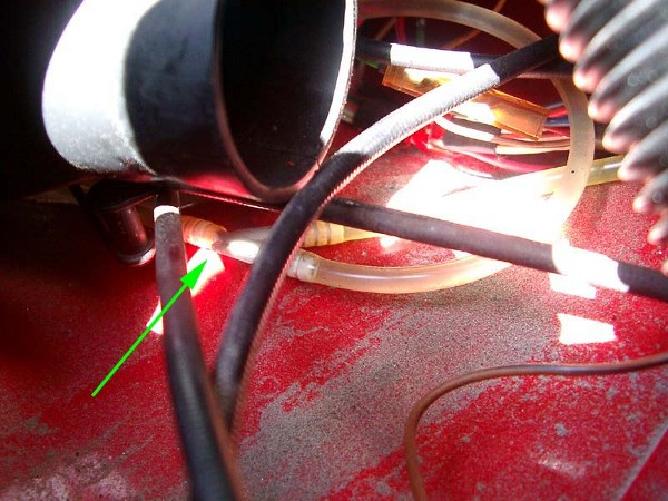

Next, the intermittend relay (well, i took mine out for AX), you can see the brown/black wire that comes from the steering colum. split and extend this to the pump if you want to run the pump off the wiper lever
Next, backside of the nozzle, the arrow marks the approx. location where the brown/black wires comes out of the main harness

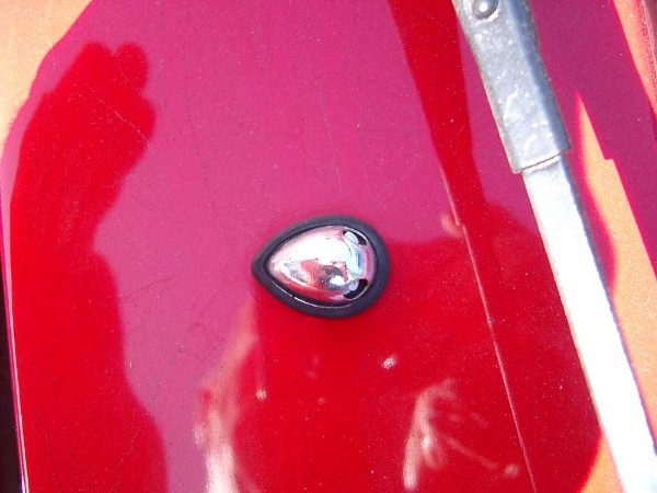

Next, the mighty fine nozzle itself

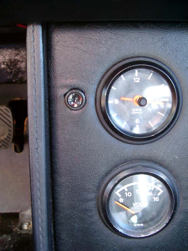

Next, the push style button in the center console
Voila, we have a washer!
