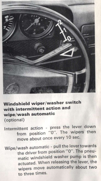

Superhawk996
post Aug 1 2022, 06:53 AM
Posts: 8,156
Joined: 25-August 18
From: Woods of N. Idaho
Member No.: 22,428
Here's the blurb from the 73' owner's manual on how intermittent works with the factory graphic
