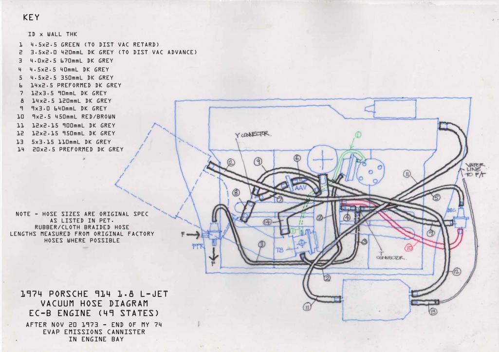

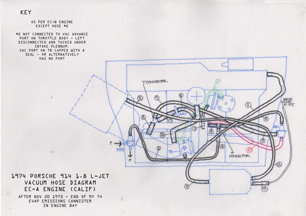

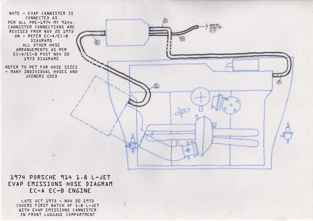

These are better, thanks to our friend from downunder @wonkipop

lolkema what should this be connected to? 1.8 fuel injection/ air filter Aug 5 2022, 01:33 PM
David Billo My guess, charcoal canister.
http://www.914world.... Aug 5 2022, 01:48 PM
wonkipop or you can do @JeffBowlsby 's resto mod on t... Aug 6 2022, 04:21 AM
lolkema Thank you all for the help, those drawings clarifi... Aug 8 2022, 11:53 AM
