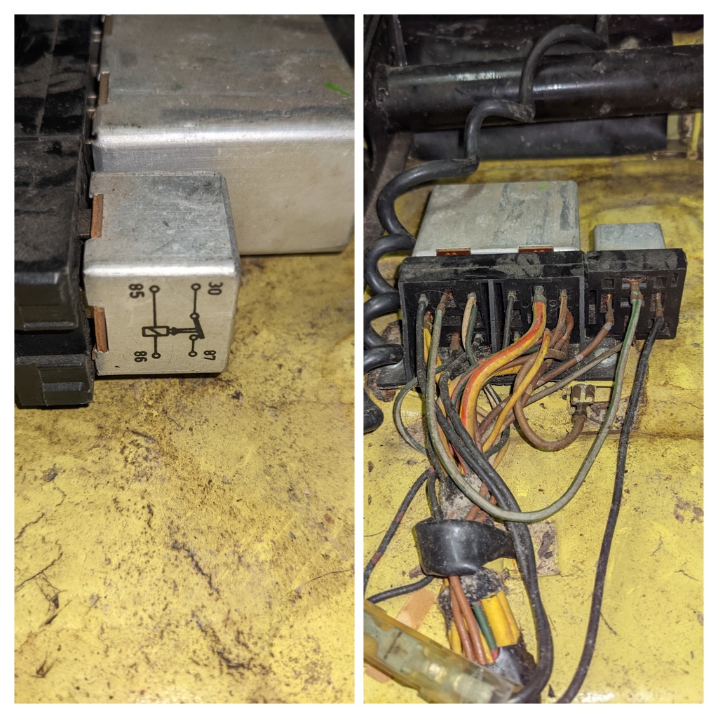

Van B posted this photo which shows that for his car there is a short brown wire from relay pin 31 that grounds to a spade under the relay base. Is this true for all years?

davep   Van B posted this photo which shows that for his c...   Aug 25 2022, 08:45 PM

davep   Thanks Jeff. Just had another look at my LE, and n...   Aug 29 2022, 08:07 PM
JeffBowlsby   Dave, that photo above looks odd somehow. A Euro ...   Aug 29 2022, 09:21 PM
davep   Your photo there does not show if there is a spade...   Aug 30 2022, 08:08 PM
