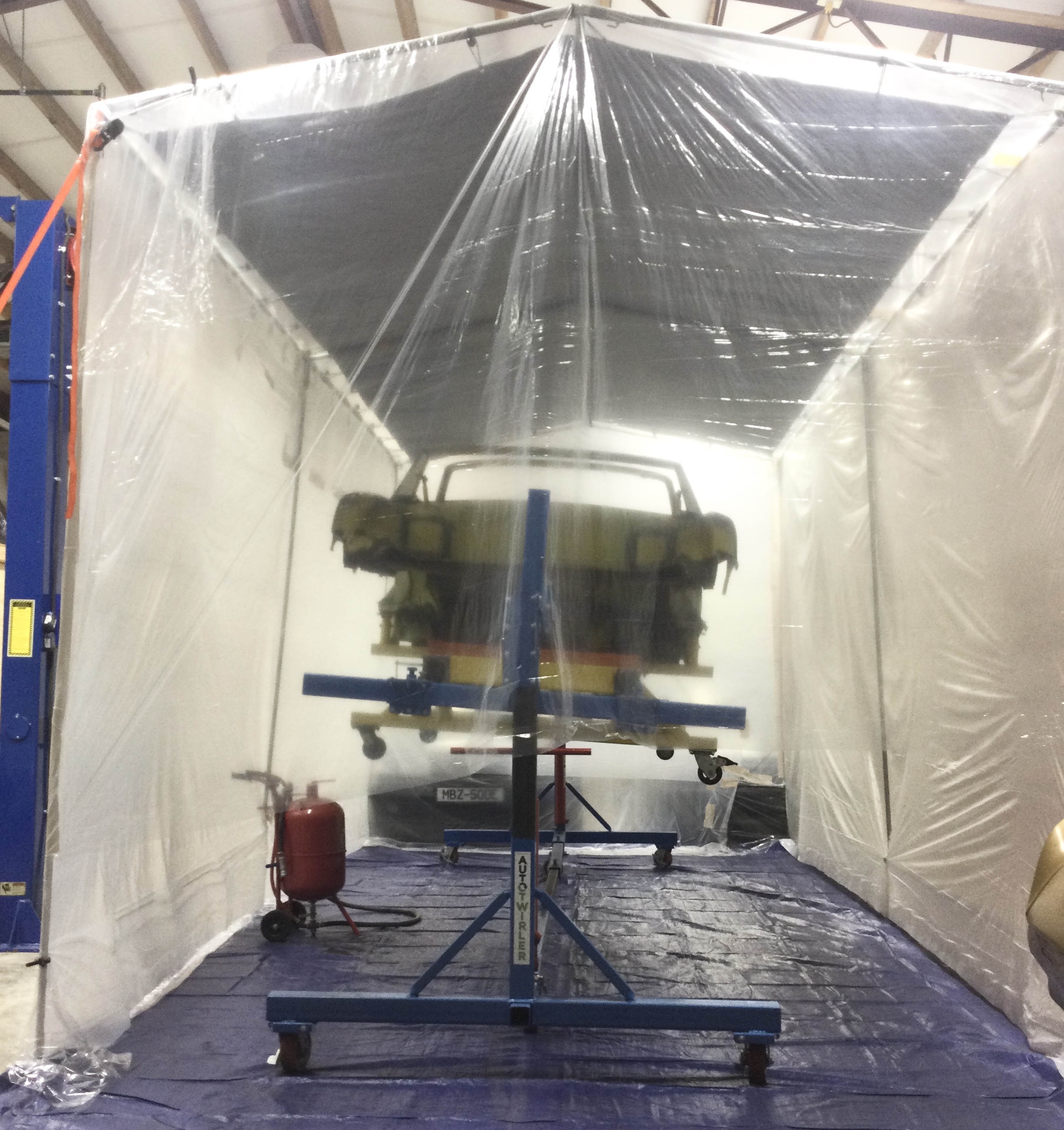

Well, I decided the best way to get the rust out of some hard to reach areas at the rear firewall area was to do some blasting. Since I don’t have a smooth driveway, and my rotisserie is on hard wheels,,,,I decided to try and set up a makeshift “booth” area to do some blasting in. Time consuming, but it works and keeps the mess contained.

Alain V.   Well, I decided the best way to get the rust out o...   Aug 28 2022, 08:50 PM
