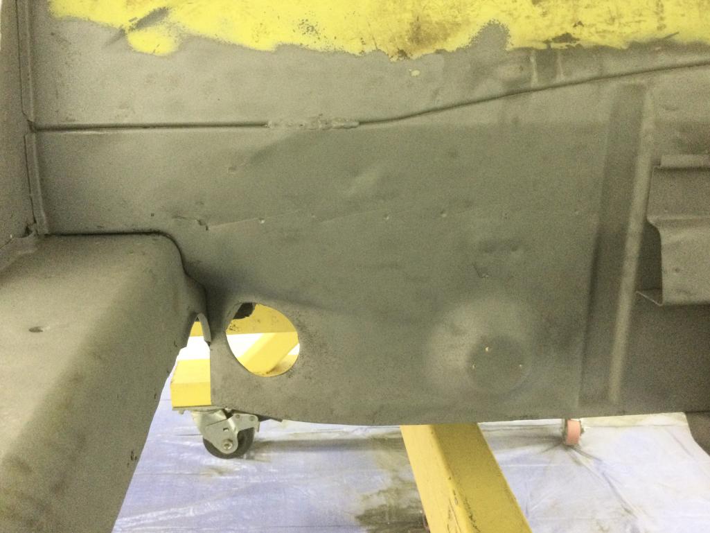

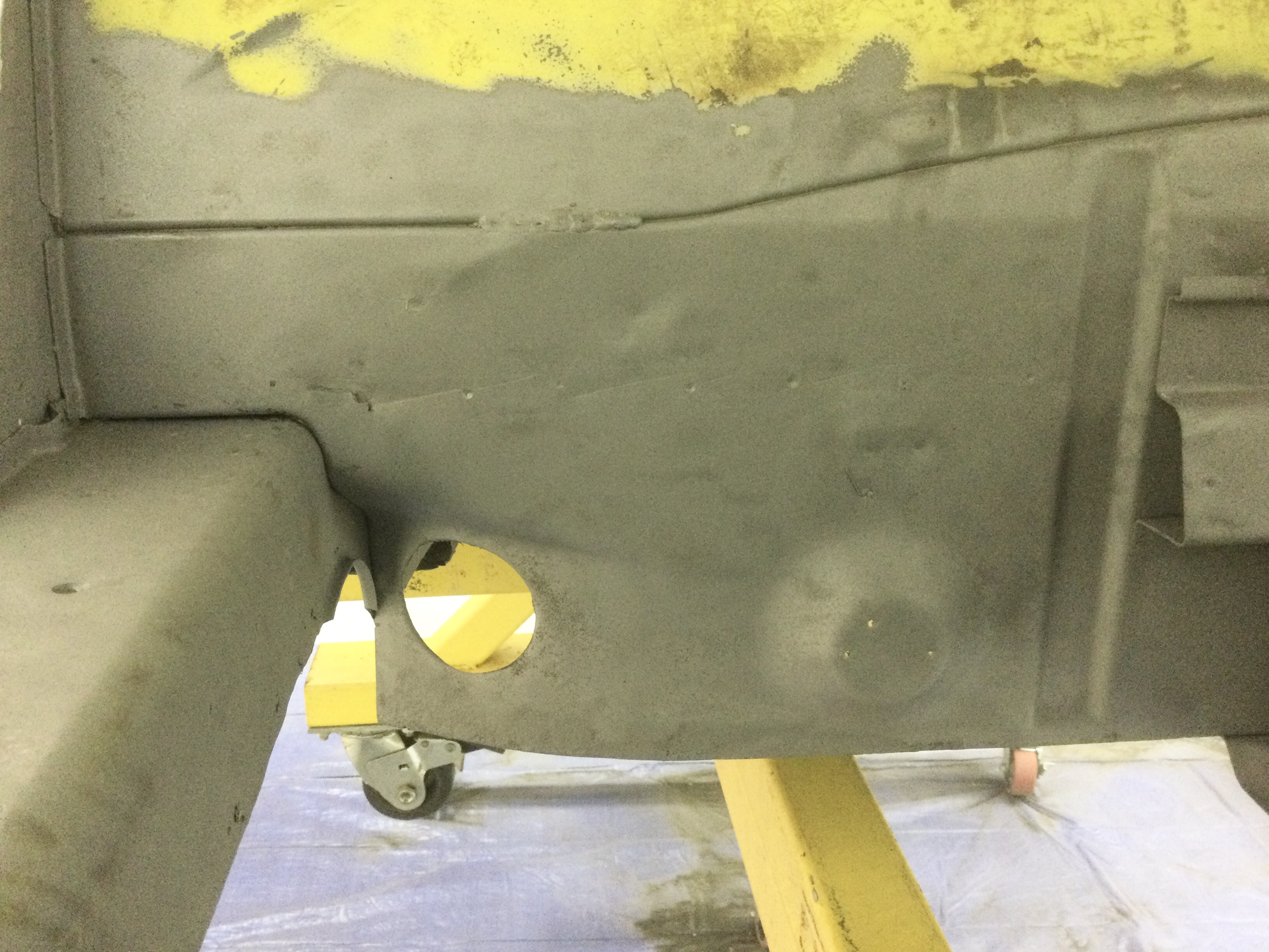

Alain V.   Well, back to the 914. Still making small steps f...   Feb 20 2022, 05:20 PM
Alain V.   Antenna hole filled.   Feb 20 2022, 05:20 PM
Alain V.   Tail panel emblem holes filled.   Feb 20 2022, 05:21 PM
