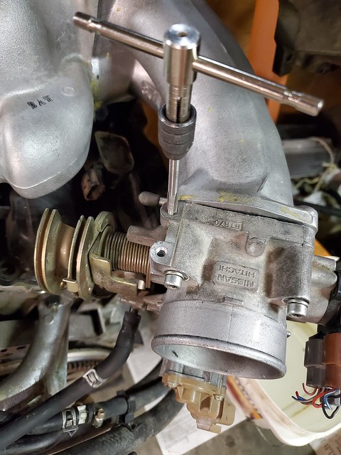

The Pathy TB has a nice pair of unused bosses in the perfect place to mount a cable bracket, so I threaded them m6x1.0. In the process I realized they both didn't go all the way through. (IMG:style_emoticons/default/headbang.gif) Don't know if I want to risk drilling after threading...

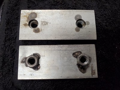

Seemed like a good time to mount the rear sway bar so I made these. Then in test fitting I found rust, so I decided that should probably wait... (IMG:style_emoticons/default/headbang.gif)
(IMG:http://www.914world.com/bbs2/uploads_offsite/live.staticflickr.com-431-1662174231.1.jpg)
