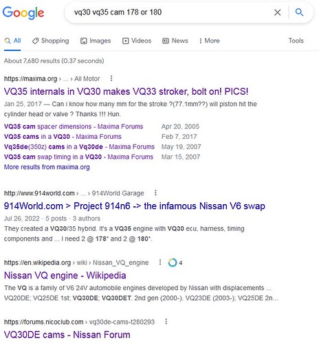

Well lookie here, I made #2 on Google (IMG:style_emoticons/default/piratenanner.gif)
(IMG:http://www.914world.com/bbs2/uploads_offsite/live.staticflickr.com-431-1662196585.1.jpg)

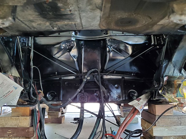

Since I'm on the subject of #2...
....the bay got painted this evening. We will say it looks better than 21 year old primer and leave it at that. Someday I will make the whole car all nice like, but I want to (IMG:style_emoticons/default/driving.gif) at least 9,146 miles first (IMG:style_emoticons/default/hissyfit.gif) (IMG:style_emoticons/default/black914.jpg)
(IMG:http://www.914world.com/bbs2/uploads_offsite/live.staticflickr.com-431-1662196586.2.jpg)

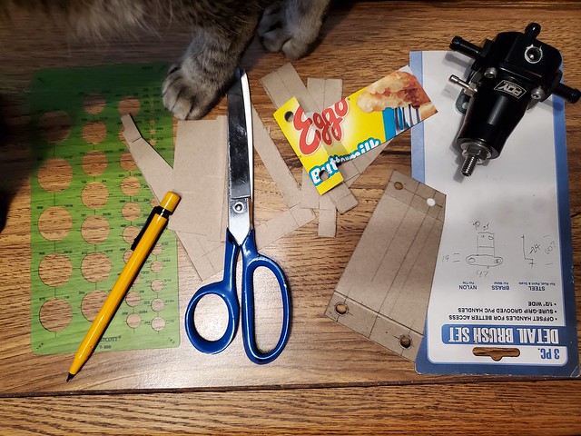

Now something I'm good at... Waffle Aided Design & cardboard brackets (IMG:style_emoticons/default/laugh.gif) Nailed it on v2.1
(IMG:http://www.914world.com/bbs2/uploads_offsite/live.staticflickr.com-431-1662196586.3.jpg)
