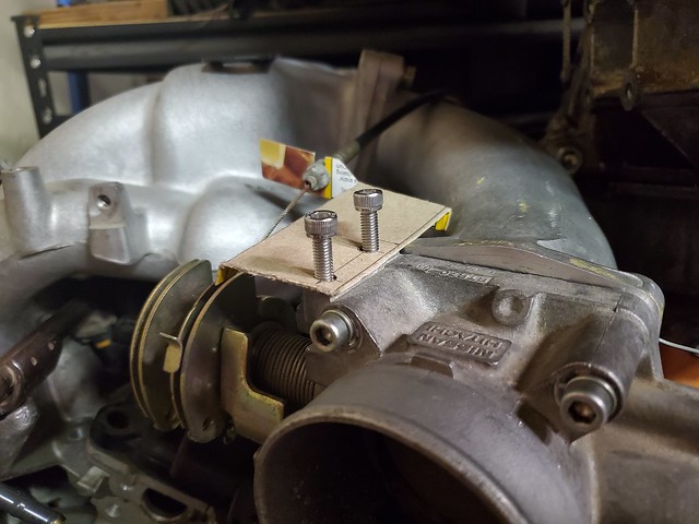

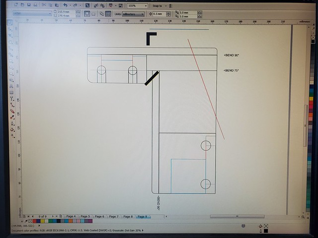

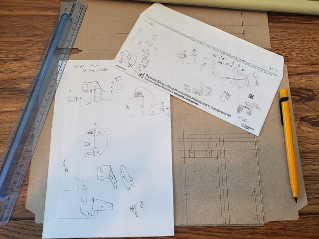

The acc cable bracket was a bit more involved design. Penciled a few ideas before deciding this design would be strong enough and easy to make. KISS
Upped my game with CAD this time. I was a CorelDraw wiz in my past life in signs.
(IMG:http://www.914world.com/bbs2/uploads_offsite/live.staticflickr.com-431-1662366673.1.jpg)
Prototyped with WAD of course (IMG:style_emoticons/default/biggrin.gif)
(IMG:http://www.914world.com/bbs2/uploads_offsite/live.staticflickr.com-431-1662366673.2.jpg)
Will be a perfect fit after the adapter is installed. (IMG:style_emoticons/default/first.gif)
(IMG:http://www.914world.com/bbs2/uploads_offsite/live.staticflickr.com-431-1662366673.3.jpg)

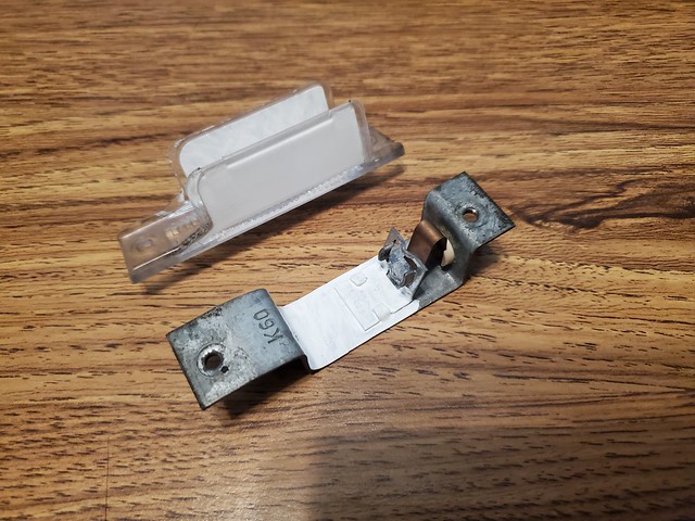

Since I felt like avoiding sweating buckets today, and I thought the trunk light would be good if it didn't shine on the ground and everywhere like a ricer, I did a little hobby painting before putting it back on.
(IMG:http://www.914world.com/bbs2/uploads_offsite/live.staticflickr.com-431-1662366673.4.jpg)
