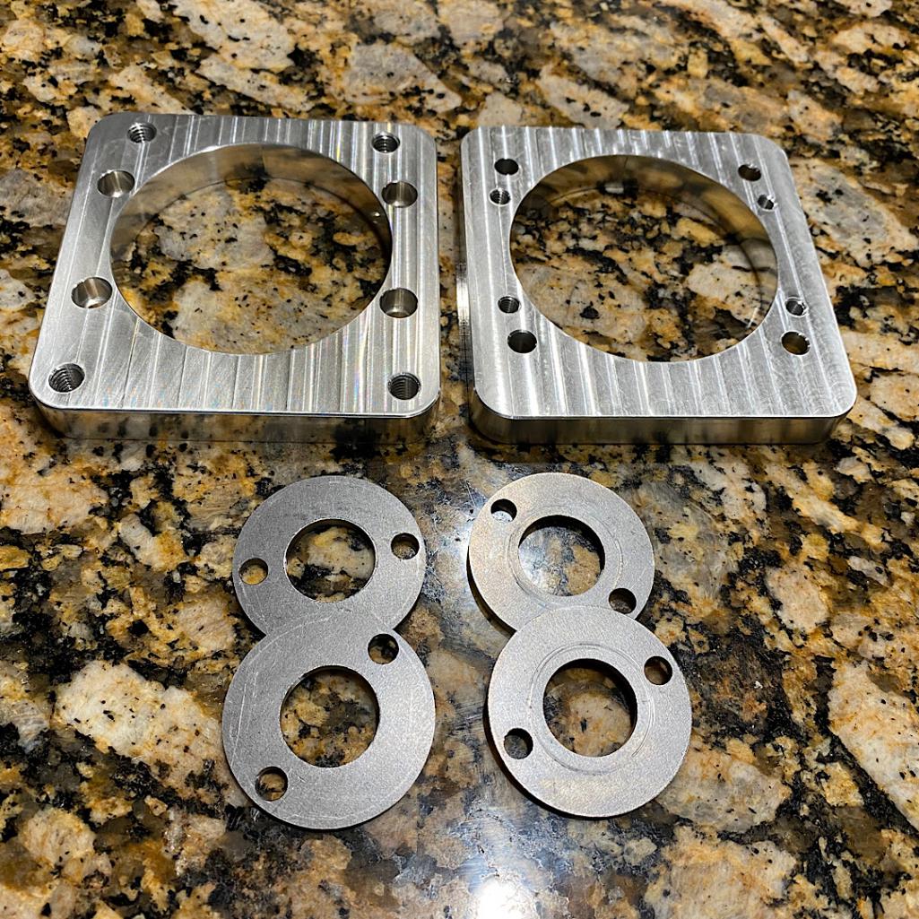

If one or more of our great fabricators has time and tools I'd love to toss email money your way. @mueller @tygaboy @mb911
First is the Throttle Body adapter. Replacing the factory e-gas with cable. I currenly have this partially drawn in CorelDraw and design is not absolute (still searching hardware). 96mm x 99mm. TB (red) bolts to piece_1 (blue) which bolts to piece_2 (green) which bolts to IM (yellow).

Second is cam gear adapters/spacers in steel. I need 2 @ 178* and 2 @ 180*. 4 total cuz 4 cams of fury. 6mm dowel pins look to be readily available.

Third is a pair of aluminum block-off plates for the VVT cam adjusters. 1.5" x 3.5" Also drawn in CorelDraw, which can be exported as .ai or .dxf. Actually I might make these by hand.

These will ship out in the morning. Hope they work!

They look perfect. Thanks so much for making these.

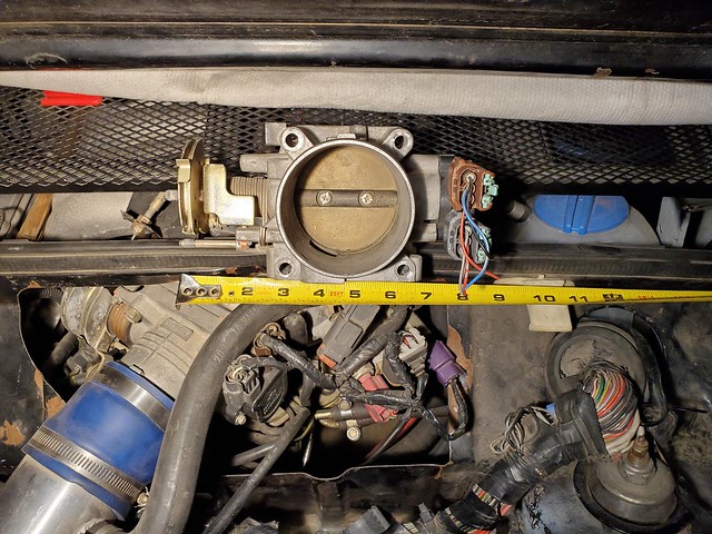

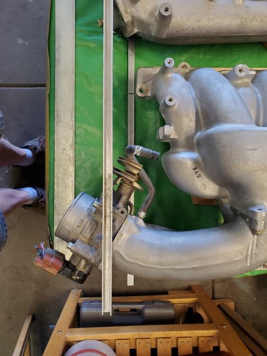

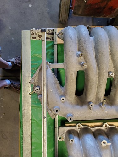

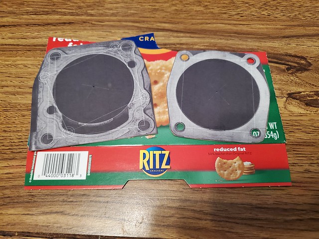

Since everyone is dying to know... the TB adapters required a 3 step process of SAD, CAD & RAP.
First both TBs were digitized using Scanner Aided Design. Then measurements were taken and overlaid using Computer Aided Design. Then that was converted to physical form using Ritz Aided Prototyping. (IMG:style_emoticons/default/lol-2.gif) This allowed me to get an idea of how it would fit at the trunk wall.

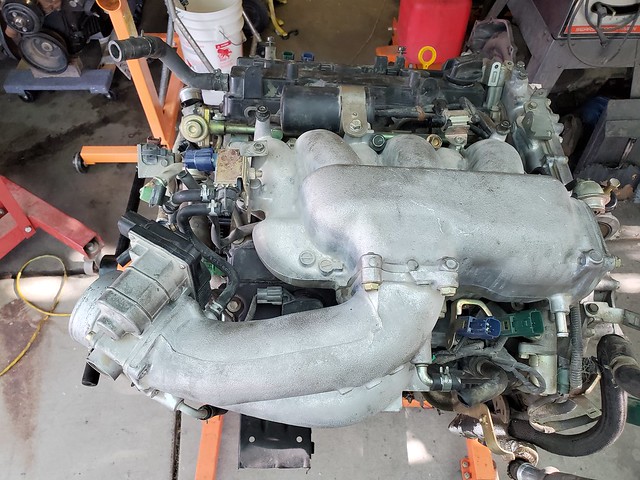

Bonus that the FWD vq35de intake is 2 piece, which allows me to fabricate (ideas?) a non-trunk interfering option in the future (IMG:style_emoticons/default/biggrin.gif)
