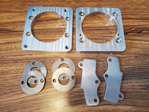

First is the Throttle Body adapter. Replacing the factory e-gas with cable. I currenly have this partially drawn in CorelDraw and design is not absolute (still searching hardware). 96mm x 99mm. TB (red) bolts to piece_1 (blue) which bolts to piece_2 (green) which bolts to IM (yellow).

Second is cam gear adapters/spacers in steel. I need 2 @ 178* and 2 @ 180*. 4 total cuz 4 cams of fury. 6mm dowel pins look to be readily available.

Third is a pair of aluminum block-off plates for the VVT cam adjusters. 1.5" x 3.5" Also drawn in CorelDraw, which can be exported as .ai or .dxf. Actually I might make these by hand.

Today was Metal ---- in the mailbox (IMG:style_emoticons/default/aktion035.gif) (IMG:style_emoticons/default/wub.gif)

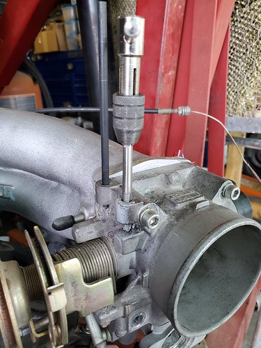

I like to start the day off with easy stuff. I figured the bottom wasn't too thick, so with a center punch I was able to pop the bottom out without damaging the threads. Then I tapped it all the way thru. Basically it just gives me flexibility with bolt length/type.
(IMG:http://www.914world.com/bbs2/uploads_offsite/live.staticflickr.com-431-1663140843.2.jpg)
Then a moment of truth... @mueller SUCCESS!!! (IMG:style_emoticons/default/beerchug.gif)

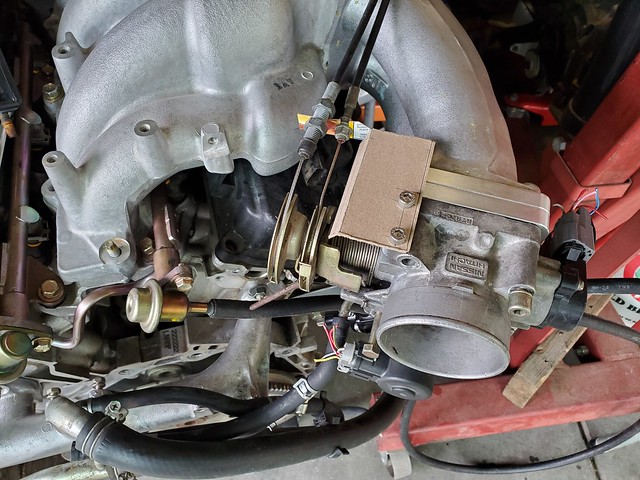

Chris914n6   The acc cable bracket was a bit more involved desi...   Sep 5 2022, 02:31 AM
