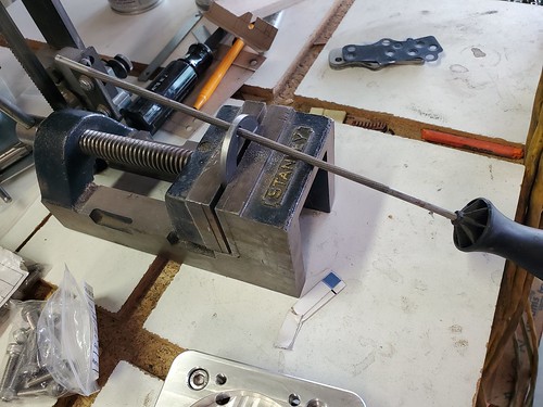

(IMG:http://www.914world.com/bbs2/uploads_offsite/live.staticflickr.com-431-1663143241.1.jpg)
So I had to make them fit, which took hours I didn't have to spare.

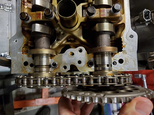

(IMG:http://www.914world.com/bbs2/uploads_offsite/live.staticflickr.com-431-1663143241.2.jpg)
But I got it to fit with careful filing.

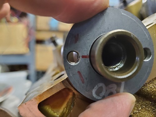

(IMG:http://www.914world.com/bbs2/uploads_offsite/live.staticflickr.com-431-1663143241.3.jpg)

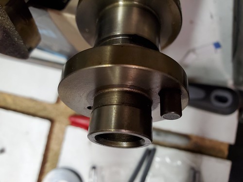

But there is an even bigger problem. There is a groove where the piece mounts....
(IMG:http://www.914world.com/bbs2/uploads_offsite/live.staticflickr.com-431-1663143241.4.jpg)

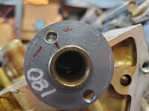

...that lets the gear rotate many degrees.
(IMG:http://www.914world.com/bbs2/uploads_offsite/live.staticflickr.com-431-1663143241.5.jpg)

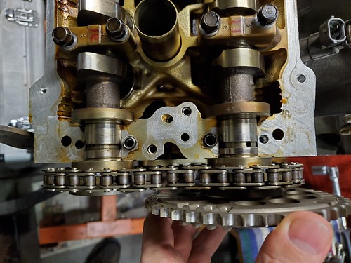

(IMG:http://www.914world.com/bbs2/uploads_offsite/live.staticflickr.com-431-1663143241.6.jpg)
Even if I could get it lined up and torqued there is no guarantee it wouldn't slip in use. Way to janky for me. Wasted day.
