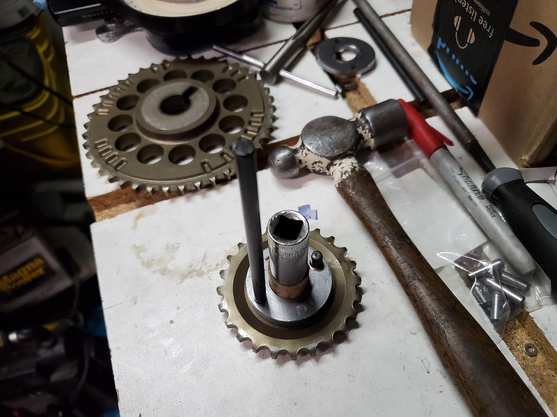

The cam adapters seemed to be the easy method, but it's not the only one. Others choose to drill the cams, too involved and risky for me. Or drill the cam gears, which is a solid way to do this (plus new gears are cheap and easy).
So with much, very very much thought, totaling half a day, I moved forward with what I had available...
2 cnc machined adapters as templates (off by 0.5mm)
1 undersized socket
1 paper towel roll cut to work as a shim
1 loose fitting center punch
1 wobbly Harbor Freight drill press
5 American size drill bits near 2mm 3mm 4mm 5mm 6.1mm
2 cojones from a desperate man with too close of a deadline
(IMG:http://www.914world.com/bbs2/uploads_offsite/live.staticflickr.com-431-1663146962.1.jpg)

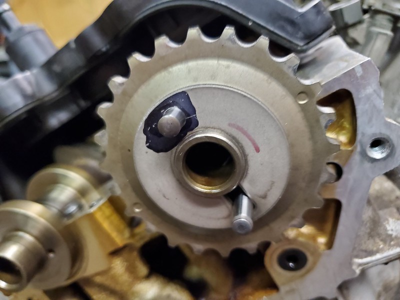

Must include that impossible to acquire skill of Divine Intervention...
(IMG:http://www.914world.com/bbs2/uploads_offsite/live.staticflickr.com-431-1663146963.2.jpg)
I can't describe the feeling when this worked out at this level. At this point I called it a night and drank the elixir of stress relief (IMG:style_emoticons/default/beer3.gif)
